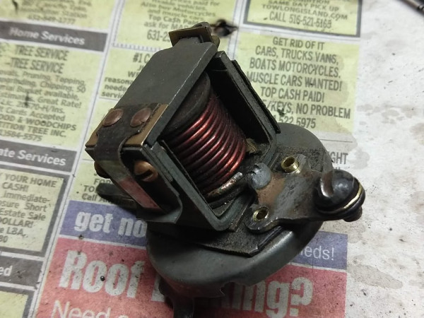

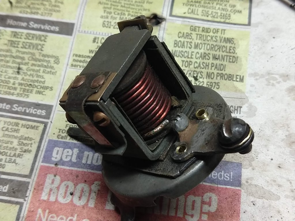

Hi All,
At some point, when testing the timer (another topic for another time), I smelled wire burning and saw smoke coming from the generator cutout. I shut everything off and later took the cutout apart. I saw the winding wire which attaches to the outside yellow wire melted. Apparently the yellow wire connecting screw came in contact with the generator body and shorted it out. I'm about to re solder the winding wire back together (I made a new gasket to keep the external screw from touching the generator body) My question is this: How can I test this cutout to see if it's working properly? And, what is the correct gap for the points?
Thanks,
John
Thanks,
John

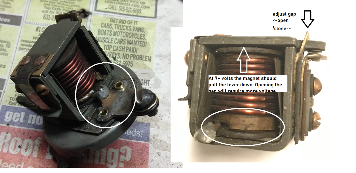

The correct gap and tension of the points is where the electromagnet "pulls in" and closes the contacts at about 7.0 - 7.2 VDC, assuming this is for a stock 6V system.

When something similar happened to me, I filed the points and adjusted it so that the contacts would close at 7.5 volts which was supplied with 5 flashlight batteries. It worked well. This is not factory setting but it was the best I could do at the time.

You'll need to create a non-conductive test platform so you don't shock your self "testing" it when you connect a car battery A piece of wood will do, with the cutout screwed down and leads to the input and output terminals. In comparing it to one I have like it - it may be minus some insulation under the coil, I'd pitch it and modify it with a diode or buy another (Nu-Rex negative ground from Snyders)
But if you want to test it. Yes you can use flashlight batteries as indicated above - safer too
It is a simple electromagnet switch (an iron bar with a copper coil around it). The voltage from the generator side to the BAT side will create a magnetic force to pull down the lever arm that cause the points to open and close. The idea is when that voltage reaches 7+ volts it should pull the lever arm down and cause the points to close. I ran a feeler gauge between the one I have and it was .014" so maybe use that as a starting point. Before you run any voltage, do a continuity test on everything to make sure nothing is grounded - there should only be continuity from the GEN terminal to the BAT side when the points are closed. You will need a variable DC power source to set the gap properly. But you can use a 6V battery to see if it will close the points. Remember the point of the cutout is to be open when the battery voltage is higher than the output of the generator regardless of the engine running.

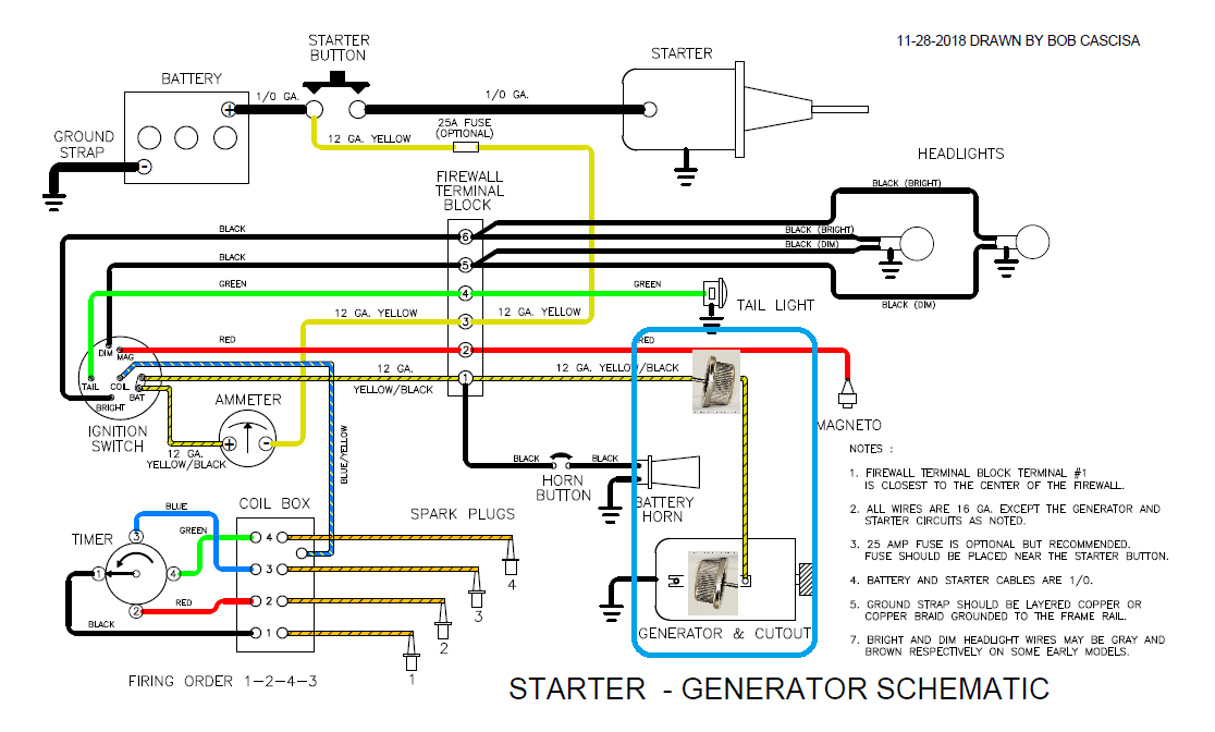

I suspect there is an internal fault in the cutout and that it was not your yellow wire grounding. If that wire had grounded, you would have put direct battery to ground and would have most likely burnt out the ammeter or if you have a fuse, it would have blown the fuse. But you can do the tests above if you want to. I would recommend a diode cutout. Or you can even remove the inner parts of your existing cutout and install a diode yourself. The current should flow from the generator through the diode, but not from the battery to the generator.

I don't think the cutout screw touching the generator case (ground) caused your problem at all.
Your cutout appears to have the correct 5/16 length screw which was selected to prevent ecaxtly that from happening.
If as you suggested that the yellow wire connected to the cutout bat terminal would be a direct short to ground and the entire circuit wiring from the cutout to the starter switch via the ammeter would have get very hot quickly. If you had this circuit fused somewhere near the starter switch a 25 Amp fuse would have also quickly opened the circuit. Norman Kling made these observations in a reply post and I agree.
A much more likley scenerio that caused your cutout's current winding to open was the cutout contacts had stuck closed (a common problem with the relay type reverse current cutout) when the engine was last shut down and the full 6.4 voltage of the batteries was shorted to the 1 Ohm resistance ground inside the generator and the ammeter would have been reading 6 amps discharge. The cutout case will get very hot until something in this circuit finially burns out. In your case it was the cutout current winding.
Because this area of the Model T charging system is very commonly misunderstood I wrote an article for the Model T Ford Fix Website. Here is a link to the article: https://modeltfordfix.com/the-model-t-f ... patterson/
The other advice offered about using a Nu Rex diode cutout or make you own diode cutout is probably your best bet and install one 25 amp fuse in the #12 yellow wire near the starter switch.
Ron Patterson
