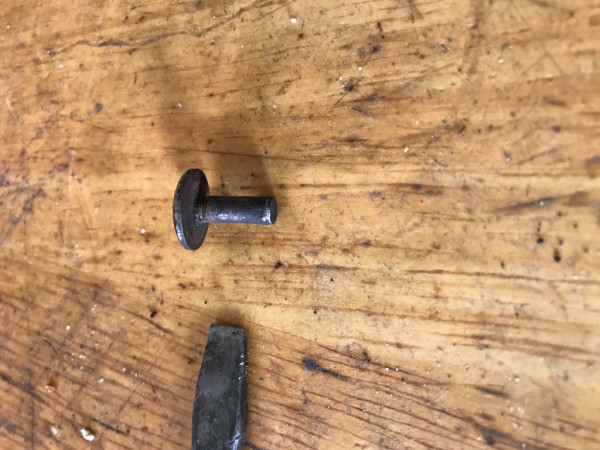

Looks like the rivit that holds the magneto field coil contact insulator in place.

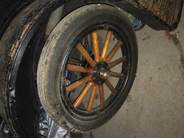

If we're looking for parts that are "wrong" for 1917, you can include the demountable wheels. Obviously they fit, but were first used on some Fords in 1919. It's not rare to see them used on earlier cars for convenience. Strictly original wheels for 1917 would be non-demountable with rounded wood felloes, round spokes, 30 x 3 front and 30 x 3½ rear, painted black. "Natural" spokes became an option in 1926.
If the mystery rivet is from the magneto contact insulator, I believe you can look into the hole with the mag post removed and see if it's missing from the insulator.

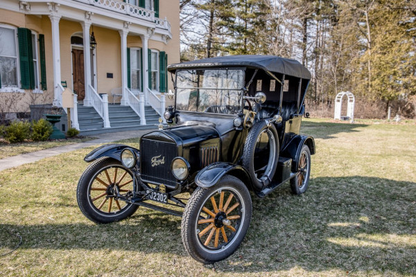

The head gasket on the cowl (like your pic) wasn’t OEM until 1923.........just kidding.....I think the windshield hinges were of equal length from ‘15-‘17 then changed in ‘18. If I’m wrong on this you can be sure someone will ‘correct’ me.

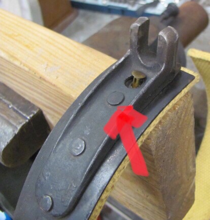

Could it be a rivet that holds the transmission band ears on? Can’t tell for sure on the size comparison by the screwdriver.
Also thinking it may a rivet that’s used for mounting the pan ears or ??

Just looked, it has removable ear bands now, perhaps it's from previous bands, but yes that does look like what I found

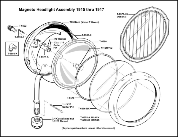

The fluted headlight lens were not introduced until 1922 so say past discussions http://www.mtfca.com/discus/messages/331880/375833.html
(vowel art shows plain glass for 1915-17). The headlight buckets might be incorrect as a result. They should have the focus screw above the bulb, 12 o'clock as opposed to at 9 o'clock.

It sure does look like it’s a band ear rivet. When you have the transmission cover off and if you take off the pan cover you could check for anything else that looks suspicious. It would be interesting to see if there is anything else in the dips in the pan bottom cover.

Removable ear bands are only removable on one end. I'd check out your bands...Kurt in NJ wrote: ↑Fri Dec 03, 2021 4:33 pmJust looked, it has removable ear bands now, perhaps it's from previous bands, but yes that does look like what I found

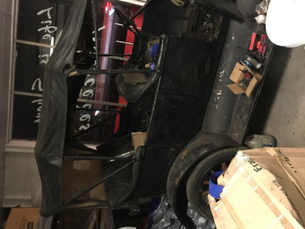

The windshield hinges were changed along about mid 1917 model year. Early 1917s had the even fold, late 1917s had the offset hinges.
The 1917 model year model Ts were a bit different. They crossed over from the brass era into the black era, and had several minor details that were used for only a short while. Very few 1917s are properly restored with all the proper unique features (like the fan shroud used for only about half the year!).
Don't get too hung up on what isn't right on your car yet. Get it running, get a feel for driving it. Then, later, decide how many things you want to change. If you choose later to make it "really right"? Then you can decide what month it appears to be from and find out all those little details and timelines. If you choose to keep it more how it is and enjoy it this way? That is fine also. Model Ts have been running and used and maintained for over a hundred years now! A car wearing all its badges (changes necessitated by maintenance) is a part of its history!
Steve J (one of our finest!) covered the wheels quite well. And the windshield hinge has been mentioned. Another obvious change is the back curtain of the top. Early 1917s had the "tombstone" window/light like was used throughout most of the brass era. Mid/late 1917s used the three tall narrow window/lights used from mid 1917 into the early 1920s. The two almost square window/lights came out about 1923 and was used for only a couple years. If I recall correctly? I think 1925 used a one year only single window/light on the rear curtain. I don't know what the 1926/'27 used (too modern for me?), I think it was also single window, however the entire top is slightly different than the earlier ones.
A lot of replacement tops used the two nearly square window/lights on earlier tops. A good photo of the side of the car showing the top would help to determine if the top is a correct two-man variety. A 1917 should have oval top sockets. The square top sockets came about 1918/'19.
I am curious to see a couple side views of the car.
I thought that was just for 1915, but the MTFCI guidelines show it through 1918.

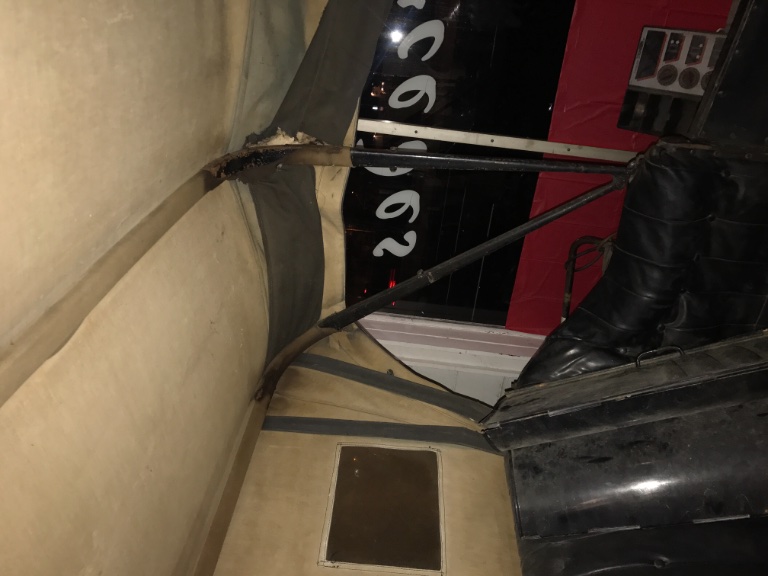

Before asking others to pick over your car, I suggest providing the motor casting date and serial number and the body date. The body date should be on the passenger side front floor riser - either stamped directly into the wood or stamped on a metal plate.
Your top irons are 1918-1922 model year. The top material has been replaced - it may have been replaced during the 1920/30s during the period of the car's original use. The top pads appear to be original, especially since you can see the white canvas duct inside one the pads.

Vertical format photos often show up sideways here. Try this: Before posting the photo here, open the file on your computer, rotate it 90% (left or right doesn't matter), rotate it back to upright, and save the file. Now go ahead and post. I don't l know why, but that works for me.

After I click on the photos in the posts to enlarge them, the orientation is correct.
