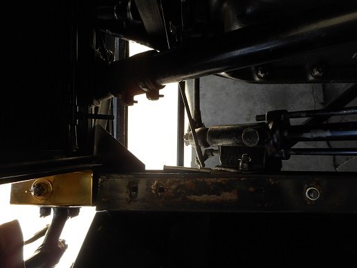

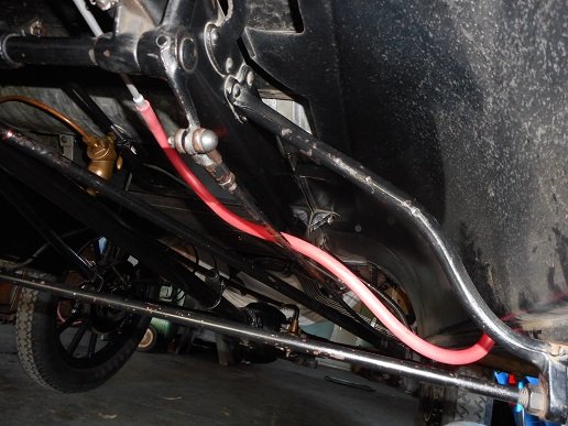

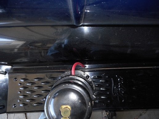

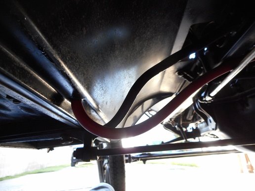

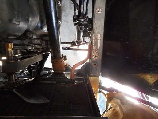

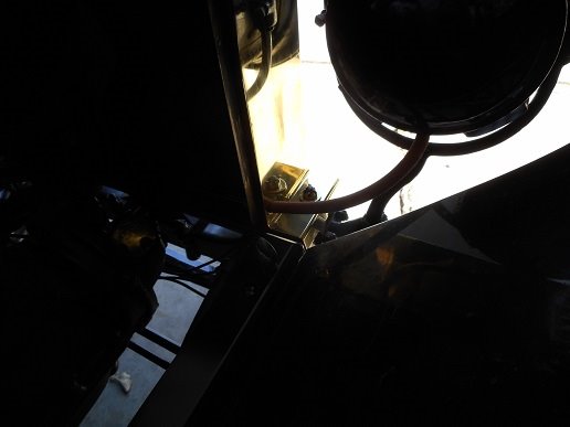

Post by Original Smith » Fri Mar 29, 2019 1:19 pm

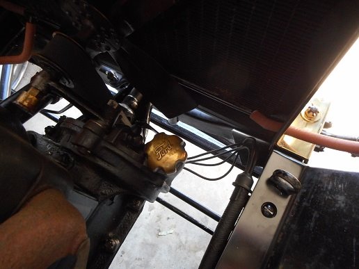

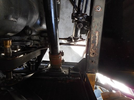

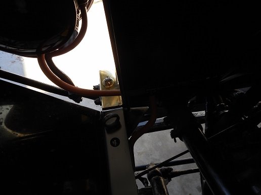

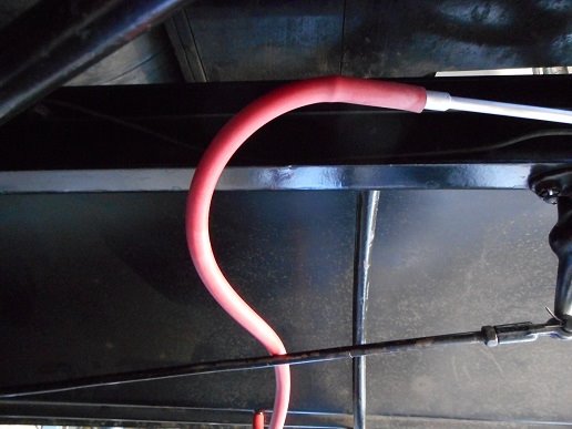

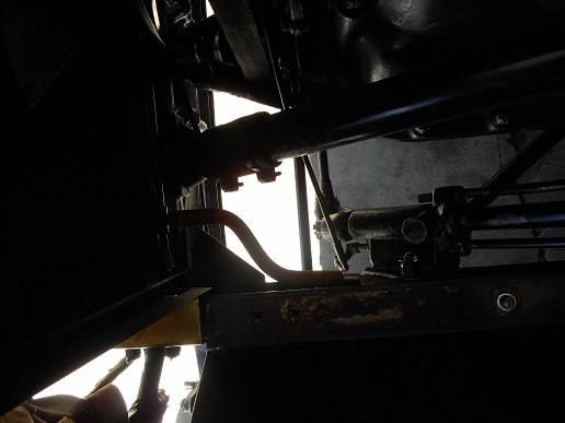

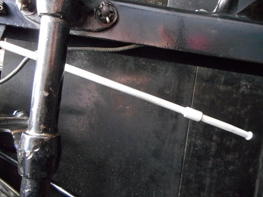

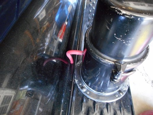

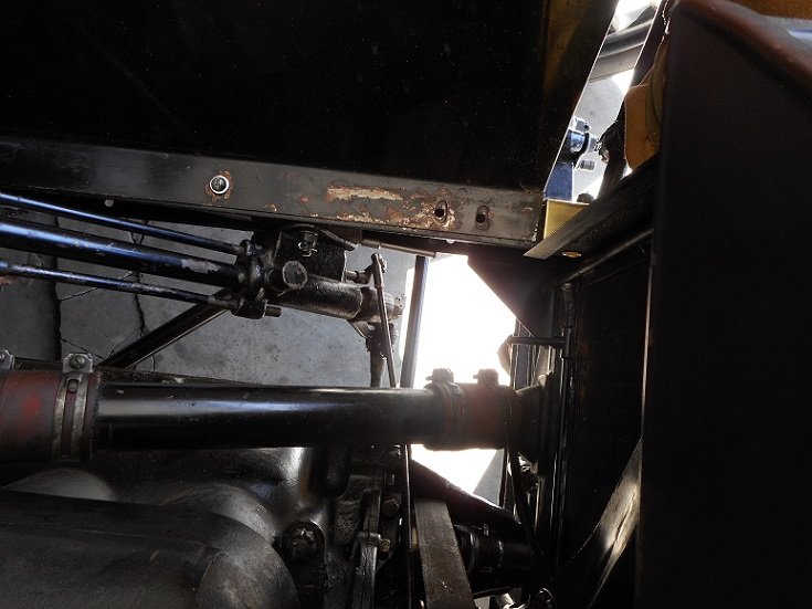

Here are the dimensions. Headlights 9", Frame to radiator 8", Carbide tank to frame line 28".
Gas Light #4.JPG (50.06 KiB) Viewed 7691 times

Here are more photos:
Gas Light #11.JPG (60.2 KiB) Viewed 7690 times
Gas Light #10.JPG (33 KiB) Viewed 7690 times
Gas Light #9.JPG (31.1 KiB) Viewed 7690 times
Gas Light #8.JPG (51.21 KiB) Viewed 7690 times
Gas Light #6.JPG (51.59 KiB) Viewed 7690 times
Posts: 3971
Location: Lomita, California
Re: Gas Line Details For Headlights
Post by Original Smith » Fri Mar 29, 2019 1:28 pm
More Photos: I'm not good a taking photos, or posting them either. If you have further questions, email me directly!
Gas Light #15.JPG (50.84 KiB) Viewed 7689 times
Gas Light #14.JPG (45.75 KiB) Viewed 7689 times
Gas Light #13.JPG (64.95 KiB) Viewed 7689 times
Gas Light #12.JPG (49.71 KiB) Viewed 7689 times
Posts: 3971
Post by Original Smith » Fri Mar 29, 2019 1:35 pm
Ron Goceks kit didn't supply enough tubing for this job. A 13-14 takes 4 feet, with 3" left over maybe. I found 1/2" red rubber tubing from McMaster Carr. They delivered it in one day. Haven't had a chance to use it yet. I made the entire system from the Ford prints. I also have an original frame line, which is exactly like the Ford print. There is a hole in the frame just forward of the controller shaft for the support bracket.

Post by Rich Bingham » Fri Mar 29, 2019 1:39 pm
Well that certainly clears up a lot of questions about the plumbing and its routing ~! Thanks much, Larry ! :D

I'm sorry some of the photos are dark. Maybe the flash didn't go off. I'm hopeful that you guys can figure this out!

Thank you for posting the photos. The setup looks great and the tee and sleeve have that "thick wall" look to them.
The photo below is on the assembly line and the little brass hose clamps sure look small. They installed the gas headlight hoses in the radiators before they came down to the line. I used clamps but I don't think they are really necessary if the hose is snug.
On your rear gas hose to the generator, I ran it over the brake rod like you have it. It was sitting on the rod so I tied the hose off to the running board support with a plastic tie. The hose was from Langs and I was afraid the rod would rub a hole in it.
