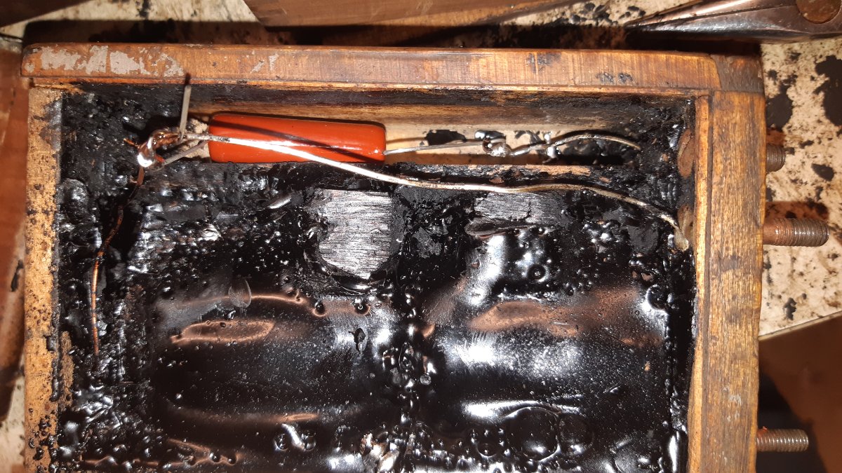

Any tips or tricks to removing coil tar from around the capacitor? Working on a coil now where the tar chips out like saw dust. Pre-heat? Odd tool? More cussing?

After removing the sliding door, if the piece on the side can be removed (the tar is holding it in place), it is a lot easier to dig the old tar out. When the coil is repotted, the tar will hold the side piece in place.

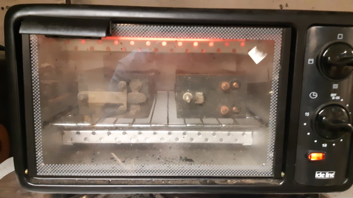

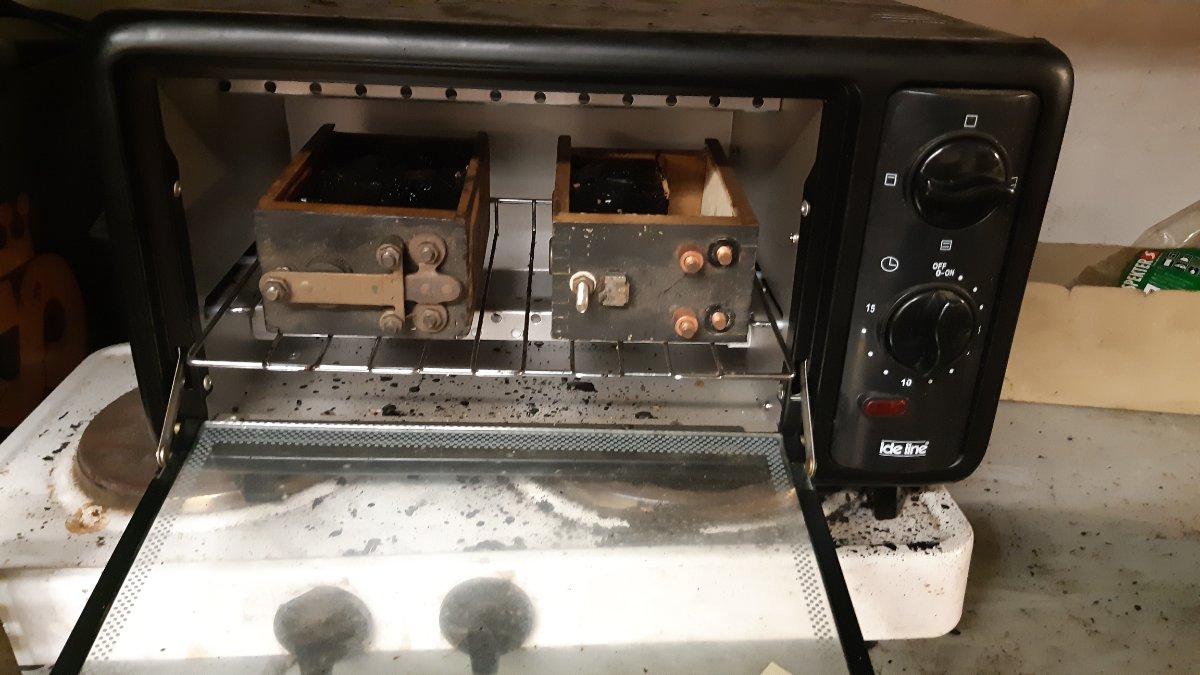

I have bought a cheap tabletop oven/toaster and give them 5 minuttes with just the upper heating device switch on:
After that I use an old screwdriver to dig out the tar and take out the old capacitot. The terminals of the capacitor will normally be taken away from the capacitor and with a plier and solding iron I then remove them aftarwards.
Then I clean the wires with solvent (gasolene) and solder in the new capacitor wich just fits in the void.
