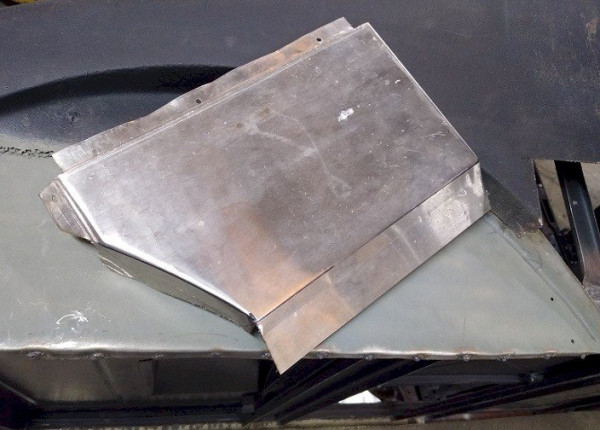

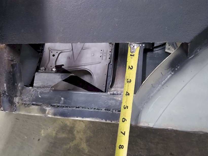

So, the rust ate up pretty high all around the bottom. This is left side bottom, between the driver's door ans the wheel well. The green etch primer is a stainless steel patch panel that I made some time ago, attached by stainless wire flux core welding. I am now just getting to the next piece, also stainless. The patch panels that I bought were too small for the damage from rot and I found some paper towel dispensers from a men's rest room that were being replaced during a remodel,

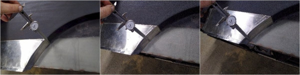

What I don't know is the taper along the wheel well edge. How far do I need to cut this thing back before I weld? I put calipers there to give an idea of what I am requesting help for. ...and thanks guys.

How much does the other end of the patch taper? I'd follow that contour.

The other side of the wheel well is the B-pillar. The bottom of the B-pillar was also rusted away and I had to recreate it. So, it's not a good guide. The doors were rusted and do not have a definite form to follow either, as they need repair too. The patch panels have a 1/2" overlap, thus not worried about rain running down the side.
Anyway the real question is how much I need to cut back on the wheel well as it tapers to the bottom edge.

I tried to measure my 26 and it is very difficult with a tape measure. But it looks to between 7/8 and 1 inch. Then I took a piece of cardboard paper and bent it into place down in the channel. Pulled it out and it measures 1 inch on the nose. Not an exact science. But close

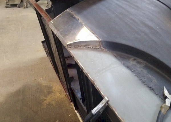

I trimmed the inner steel to 3/4" and the top patch panel to 1", welding them in place today. Now all I have to do is remember 1" when I do the other side.

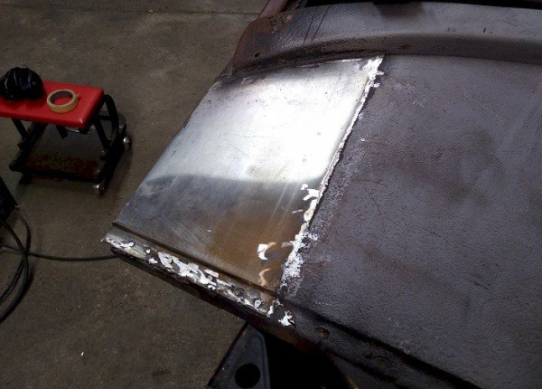

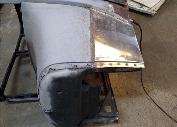

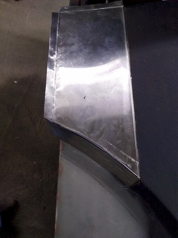

Here are the four patch panels, all were put in and need dolly work.
This shows the bead rolling that went into it.
Instead of drilling holes in the old body and plug welding to the overlap flap behind outside edges, I merely pointed the wire feed at the body until it melted a hole in the plain steel and hit the stainless behind it. I had a heat sink behind the stainless patch. Those are not shown here.

When there’s a will there’s a way. Good job varmint! Being a maintenance mechanic / welder for many years and when I saw your post I was wondering how you would do it. I thought welding the panels together would work. It’s something that’s not commonly done.
When prime and painting the panel I would imagine it would be a good idea to sand off the slick finish of the stainless to help the paint to stick.
