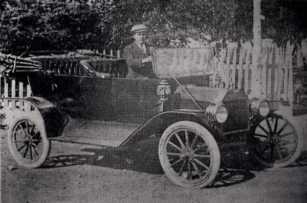

Post by John kuehn » Mon Dec 13, 2021 6:30 pm
I just saw this photo posted on a local Facebook history page. The writer says it’s a family photo and thinks it’s around 1910 going by the car. This is a T but what year for sure. I was thinking it’s a 11 but not sure. Thanks for any help.

Post by Humblej » Mon Dec 13, 2021 6:41 pm
1912 model year. Removable front doors are the give away, they were for one year only.

Post by Wayne Sheldon » Mon Dec 13, 2021 7:08 pm
A mid to moderately late 1912, slab-side as they are often incorrectly referred to as.
Beyond the usual bodies made by different suppliers for brass era model Ts, Ford itself made several styling and cost saving changes during the1912 model year. During the earlier "step-side" body style, there was one significant change to the firewall for a one-piece versus the earlier two-piece firewall used in the fall of 1911 1912 model year cars. The two-piece firewall required a "step down" at the front of the removeable side and door to accommodate the removeable windshield board. Around November or December of 1911 the new one-piece firewall and straight top of the removeable side and door came around and continued for about two or three months. Then the "slab-side" came about somewhere around February or March of 1912.
I have never gotten straight the timing or sequence of the next few detail changes. What I know is that the rear door went through a few changes. Opening to the front, opening to the rear, and some changes in bottom curves and door handle orientations.
The final easy to see change late in the model year (somewhere around June or July?) was to eliminate the outside handle on the rear doors and use an inside handle similar to what was done for the nearly fifteen years that followed (of course numerous details in the inside handles and mechanisms occurred).

Re: Is this a 1911 Touring ?
Post by John kuehn » Mon Dec 13, 2021 9:18 pm

Post by Wayne Sheldon » Mon Dec 13, 2021 10:48 pm
1912 is an interesting year. I think Ford made more obvious and/or significant changes that year than during any other model year other than 1909. Consider that there were five different touring car bodies from the earliest to the last all within that one model year. The engine's serial number was placed in four different locations, and the rear end changed from the soft center "clam shells" housing to the cast center 1913/'14 style well before the end of the 1912 model year. That rear end change in itself was a big step forward!
1910 was relatively stable. The early 1911s other than style changes to the fenders and running boards, top, etc, weren't much different mechanically than the 1910s. And all those changes were basically model year changes.
1911s I like to look closely at era photos to see if I can tell whether they are early or late versions. Significant changes were made mid-year to both the front and rear axle assemblies. They can often be difficult or impossible to see in photos, but quite a few era photos do show clearly whether it is early or late. If one knows what to look for.

Post by KWTownsend » Mon Dec 13, 2021 10:55 pm
Wayne,
Remember in 1911 tops, windshield, and headlamps were still options. Windshield spacer boards were used on cars with windshields.
In 1912 headlamps, tops , and windshields were standard, so the one piece "taller" dash was used and the fore-doors were flat across the top and fid not need the dip". I think the slab side bodies came about Jan Feb 1912.
