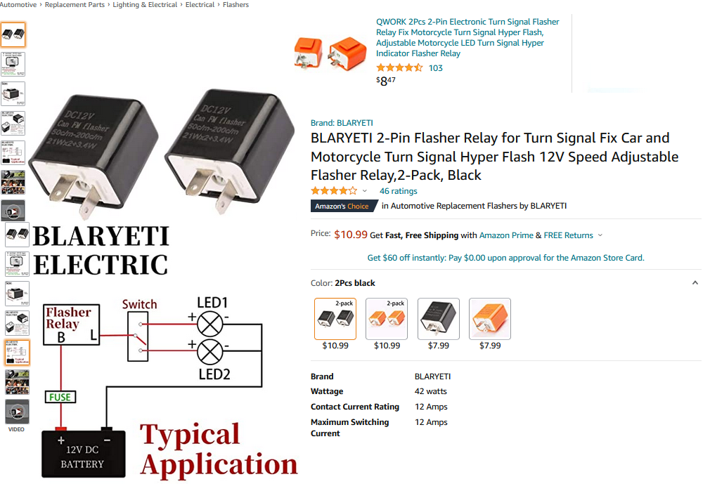

Electronic dummy here, seeking guidance. In scheming to add turn signals to my 1915 runabout, today I've been shopping online for components. Finding the LED towers was pretty easy. But in choosing a flasher one word is giving me pause. I've found the one below and several similar flashers at similar prices. Fine. But why are they all specified for motorcycle use? Is there something about them that makes them unsuitable for use on my car?

I don't know of any reason why except that most motorcycles have only 2 bulbs to flash per side, while many cars have more. A flasher meant to operate with several bulb filaments loading it will flash very slowly with fewer filaments loading it or lower wattage filaments. A regular motorcycle specific flasher would probably flash very rapidly if used on a modern car or pickup. I'm assuming the prongs are in the common arrangement, and not a motorcycle specific arrangement, and that the flasher is the old style bimetallic type. LEDs may require an electronic flasher or other mods. ****** I've never encountered an adjustable flasher, so none of the above may apply.****

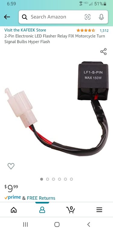

Steve. I recently purchased components to rig up a flasher circuit for my 15 RPU as well. I am using a rechargeable lithium battery for the power source. I'm still in prototype phase but should have it complete soon and will be testing on the road. The whole assembly will be easily removable from my truck tailgate so it does not harm the 'looks' of the vehicle once I am parked but is using DOT sized lights for safety sake. Here's a quick video and a photo of the flasher I am using, for your reference.
My whole turn signal endeavor should cost less than $100 in parts, and be much more visible than those for sale on sites such as Egypt Garage.

Could be that cars usually have a 3 pin flasher where one pin is to the dash blinker and this has just 2. Same flasher different color.Steve Jelf wrote: ↑Sat Dec 18, 2021 5:48 pmElectronic dummy here, seeking guidance. In scheming to add turn signals to my 1915 runabout, today I've been shopping online for components. Finding the LED towers was pretty easy. But in choosing a flasher one word is giving me pause. I've found the one below and several similar flashers at similar prices. Fine. But why are they all specified for motorcycle use? Is there something about them that makes them unsuitable for use on my car?

What a great circuit diagram. Same way I'm working mine up.TRDxB2 wrote: ↑Sat Dec 18, 2021 7:10 pmCould be that cars usually have a 3 pin flasher where one pin is to the dash blinker and this has just 2. Same flasher different color.Steve Jelf wrote: ↑Sat Dec 18, 2021 5:48 pmElectronic dummy here, seeking guidance. In scheming to add turn signals to my 1915 runabout, today I've been shopping online for components. Finding the LED towers was pretty easy. But in choosing a flasher one word is giving me pause. I've found the one below and several similar flashers at similar prices. Fine. But why are they all specified for motorcycle use? Is there something about them that makes them unsuitable for use on my car?

3 pin is usually for combination brake/turn signal with 7 wires (break in brake light circuit). 2 pin for independent turn signals normally amber and 5 wires.

Ref the Blaryeti ad above, why would anyone want a 2-pack of flashers??

Just used it as wiring diagram reference. But it always helps to have a spare when the one you have fails, like Mark'sChris Barker wrote: ↑Sun Dec 19, 2021 8:47 amRef the Blaryeti ad above, why would anyone want a 2-pack of flashers??

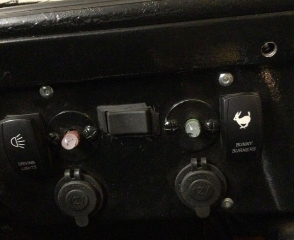

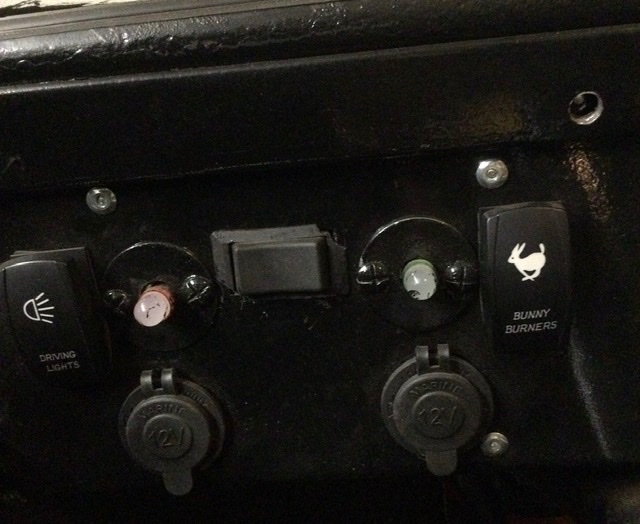

Steve, I have used superbrightleds.com when I set up my blinkers. Before I ordered anything I spoke to the technician to make sure I was buying the right parts. They walked me through and set up for me all the proper parts, I was writing as they were telling me all the part numbers, ordered everything, installed all and it works perfectly. The guys are patient and will explain everything properly, but you have to ask every bit of the way. I used a rocker switch and bulbs on the dash to remind me that it is still flashing. Then a running light switch and headlight switch. Frank

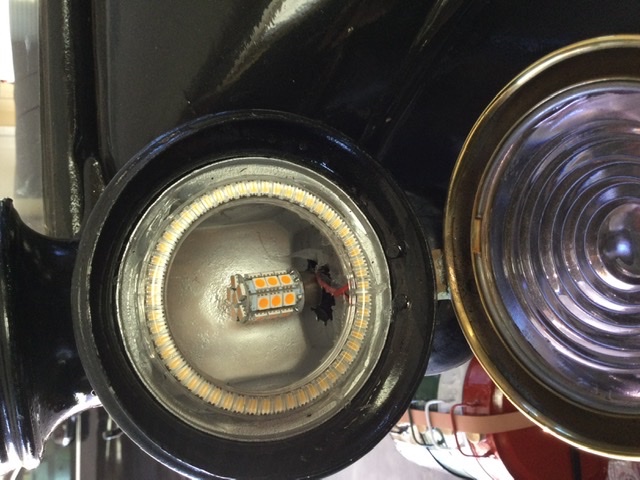

...installed all and it works perfectly.
Frank, what did you do to your side lamps to install wires?

Steve, as you can see, I installed, cilinoned in 3 inch circular running lights and then removed the Vic assembly and replaced with the bulb socket. This way you cannot tell anything has been modified till the blinker is activated. In the back, same circular led for running lights but dual element bulb for blinker and brake. You run the wires out the top chimney through a heat shrink tube, heat it and it is almost unseen except from up close, but no drilling or welding is done anywhere. I also installed a second oil light on the rear passenger side so modern distracted drivers recognize what I am attempting to do. I have extra ford brackets for the second oil lamp if you need.
If you wish, send me a p.m. and I can send additional pictures or explanations or a video of everything working. Frank
