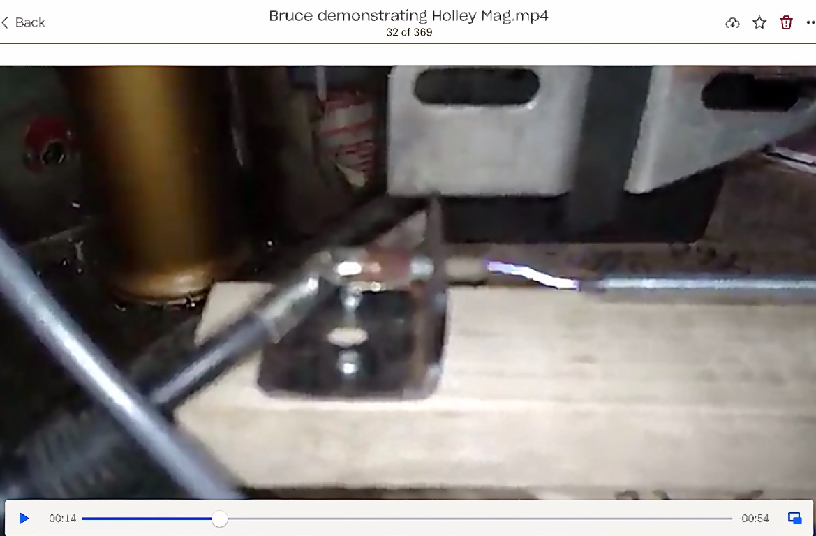

Below is a photo captured from the video link below it, showing the spark, across about 3/4th of an inch at 300 rpm. The spark is so hot it will jump up to 3 inches at higher rpm, and I am able to crank start the Model K on magneto with this unit.
Link showing Bruce V. S. running the mag with a drill at 270 rpm. The magneto is putting out about 300 volts at this rpm:
https://www.dropbox.com/s/1bx3ad41cojqp ... g.mp4?dl=0

If you watch the video, you can see how incredibly hot the spark is. The effectiveness of the magneto is also it's biggest downside. It's so hot when any moisture or insulation weakness occurs, the magneto "burns itself up." Bruce just rebuilt mine for a second time, and we're ready to use the mag again.

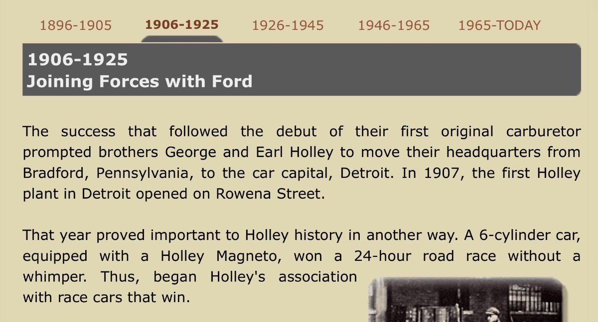

The Holley Foundation website contains this mention of the Ford's six cylinder 24 hour victory using a Holley Magneto. Unfortunately the make "Ford" isn't included:
