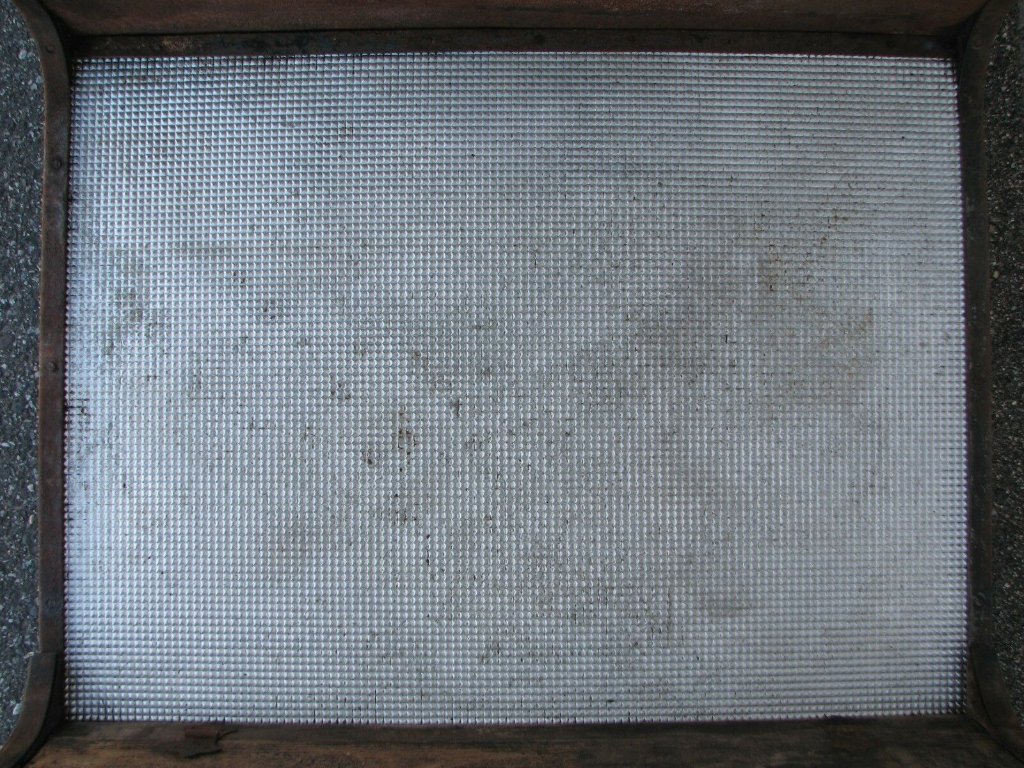

Anyone know a supplier of cover pictured below ?

I can’t tell from the picture, the size and shape of the projections. Check McMaster Carr (www.McMaster.com). Search “rubber mats” then choose projections. There might be a mat design close to what you need. Jim Patrick

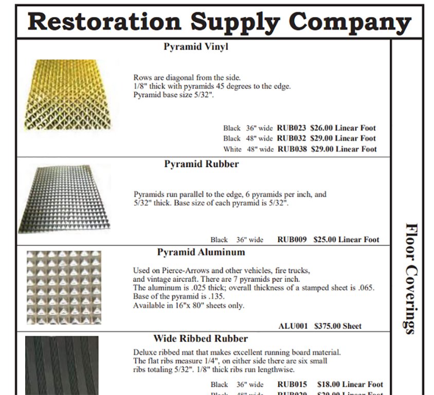

Restoration Supply Co. has white vinyl 1/4” pyramid 48” wide, $29.00 per foot.
Re: I need to find floor cover pictured
Post by Rich Eagle » Sun Jan 16, 2022 4:26 pm
Page 33 of their online catalog. They have Vinyl, Rubber and aluminum.

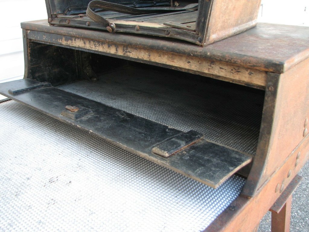

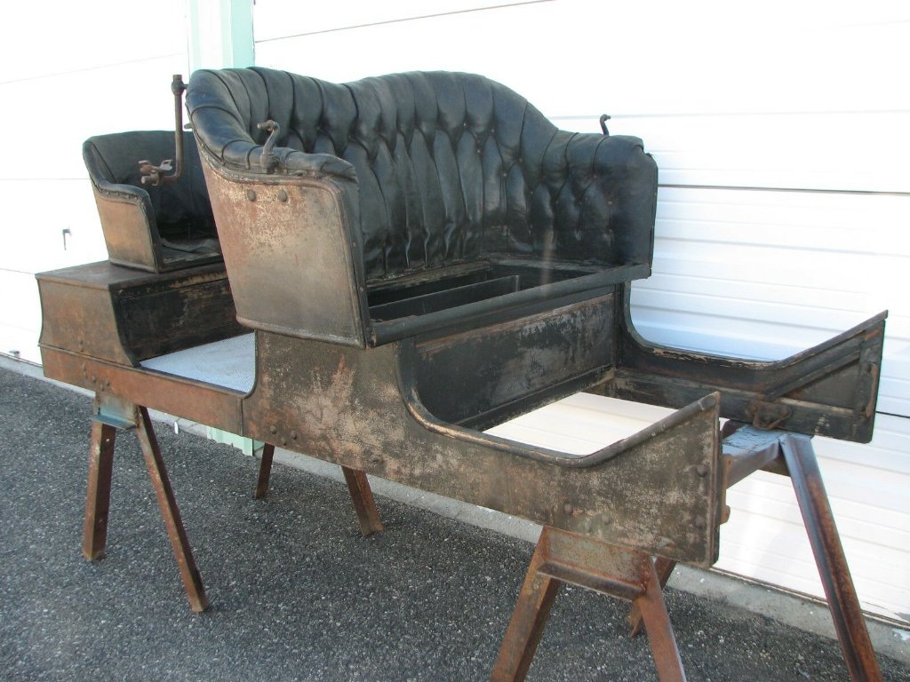

The late Ken Jones restored a 1911 roadster and it has pyramid aluminum floor covering over the rear floorboards.
If I recall correctly, the original pyramid aluminum was in rough shape but he was able to find a suitable replacement which is probably the same pyramid aluminum that is posted in the catalog above.
