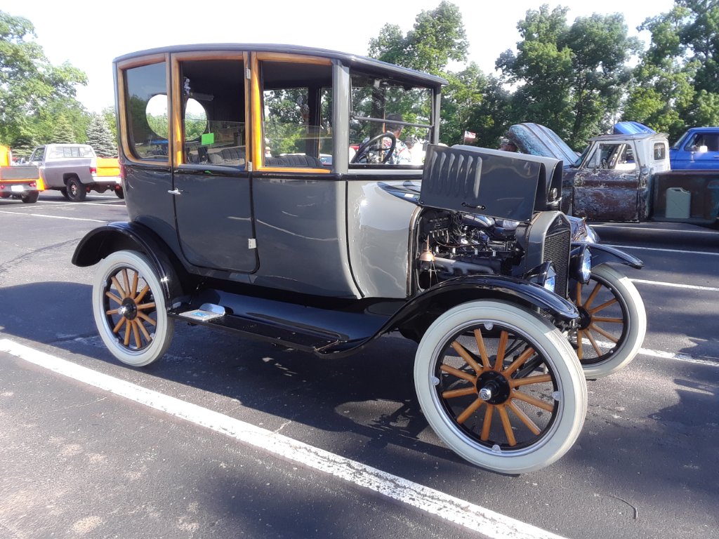

In my opinion, you won't be disappointed with a Centerdoor as these
are not too common when compared to the other body styles.
