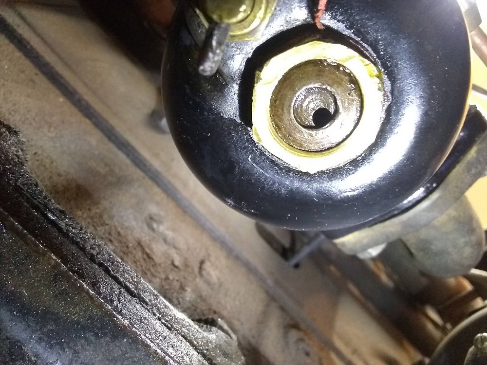

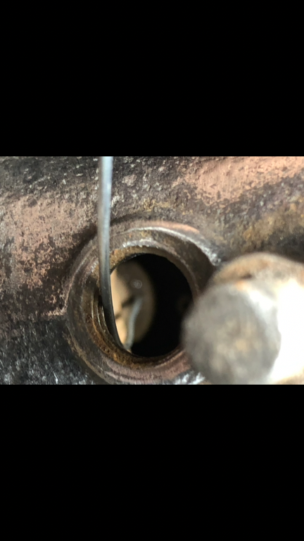

Fuel leaking does sound like it could be the carb itself.
I’ve included the photo below to illustrate a couple things. The painted body shows the fuel vent hole next to the brass model plate. If fuel is coming out of that vent hole then gas is not being shut off by the float or needle valve that the float closes. From your original post, it appears you do not have a Gross Jet style valve, shown in the middle of the photo. The gross jet has a reputation of sticking open, causing fuel to overflow.
Another reason for over flow is if your float adjustment is not quite right. I find it takes me a couple tries to get it right. On one occasion I found a glob of Permatex on the float which kept it from rising.
If the fuel is not leaking out of the vent, but still dripping, you might have a leaky gasket or seal around the bowl.
Another area that might leak is shown in the photo of the unpainted body. There is a hairline crack on the inlet that the fuel line connects to. This can happen if the brass elbow is overly tightened. It’s recommended to use sealant rather than over tighten to get it to line up.
Hope this helps.
I do agree that getting a rebuilt carb from a quality rebuilder is a great option.
Hope this helps.

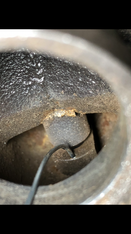

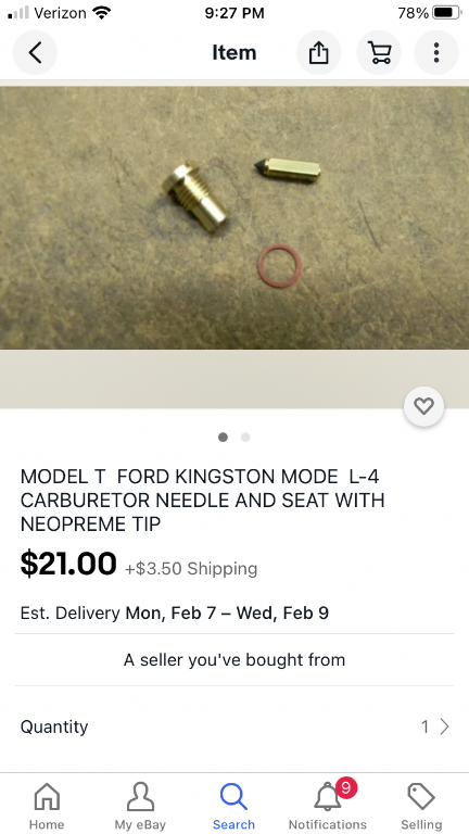

Thanks for the details and photos. Correct, the carb doesn't have a Gross Jet valve. Here's the interesting thing, which might just be my ignorance of how the L4 works, but the fuel is not coming from the hole above the bowl adjacent the air-valve shaft. It's coming out of the hole in the body where the bowl nut fastens. I've confirmed that the fuel is not seeping out from the nut threads but is actually coming out of the pictured hole even to where it makes air bubbles. It only comes out of this area when the fuel petcock is turned on and the engine is off and when I try to start the engine but can't. Your thoughts?
Agreed. I'd never mess with trying to refurbish a needle and seat to save $10. With my response to KBurket, I'm not sure the needle/seat are the issue if the fuel is coming out of the hole in the body down at the bowl nut.Scott_Conger wrote: ↑Wed Feb 02, 2022 10:10 amA common "fix" is to run the needle in a drill and hold sandpaper against it. Some folks claim that works...to some extent...but what remains is a needle which is no longer round nor straight, and the seat will still have a wide (too wide) and worn chamfer that the needle is trying to seat into.

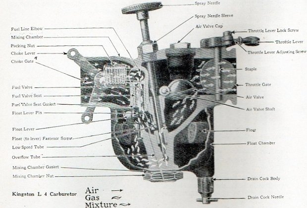

Re: 1926 Kingston L4 Carburetor Issues and Parts Source
That hole is in fact the overflow tube for the bowl, when the fuel level is not being shut off fully by the float valve, or the float level is terribly maladjusted.
Odds are strong that your float valve is failing (very common) or your float is leaky and is not buoyant enough (not as common as people would have you believe)

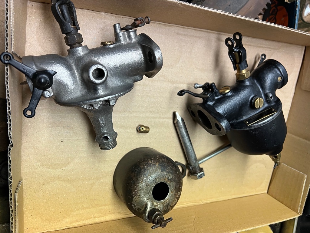

Both Russ Potter and Corey Walker do great work, but have to shout out to Corey for recently fixing my leaking Holley NH. This carb was a new rebuild and I had just installed one of Scott's Full Flow float needle seats and valve, and set the float to factory clearance, but after a week of great running the carb starting leaking.Contact Corey Walker on this site - he does a good job !
Perplexed on the cause, sent that carb off to Corey in Brownsville, TX to have him check it out. Corey always test runs any carb he does on his T, so you get a run tested carb from him always. Seems that the carb I had was a fresh rebuilt from another, and the float seemed good to me. But over course of several days, Corey found that shiny float had a tiny tiny pin hole, that let gas soak slowly into the float. He replaced the float and now the carb is leak free and running great.

OP seems to need a new needle & seat. Very easy fix. Go viaton.

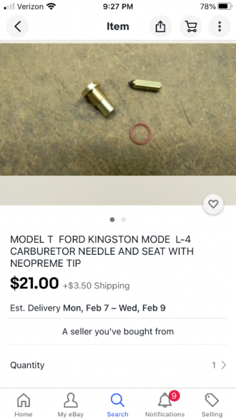

If your float valve is leaking you can get a viton tipped one. Bob’s has them on eBay now. If your float valve is leaking enough that gasoline is coming out the overflow then I’m not sure that making the mixture richer to facilitate starting is the answer. That would indicate another problem since it would already have too much gasoline. When I get one flooded I screw the needle in to shut off the fuel then open the throttle and crank it. I believe the Kingston also should have a taller float like the NH did in 1926 to compensate for the added fuel pressure from the cowl mounted tank.
