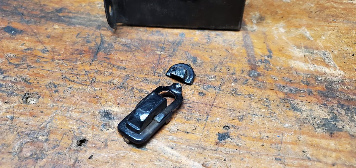

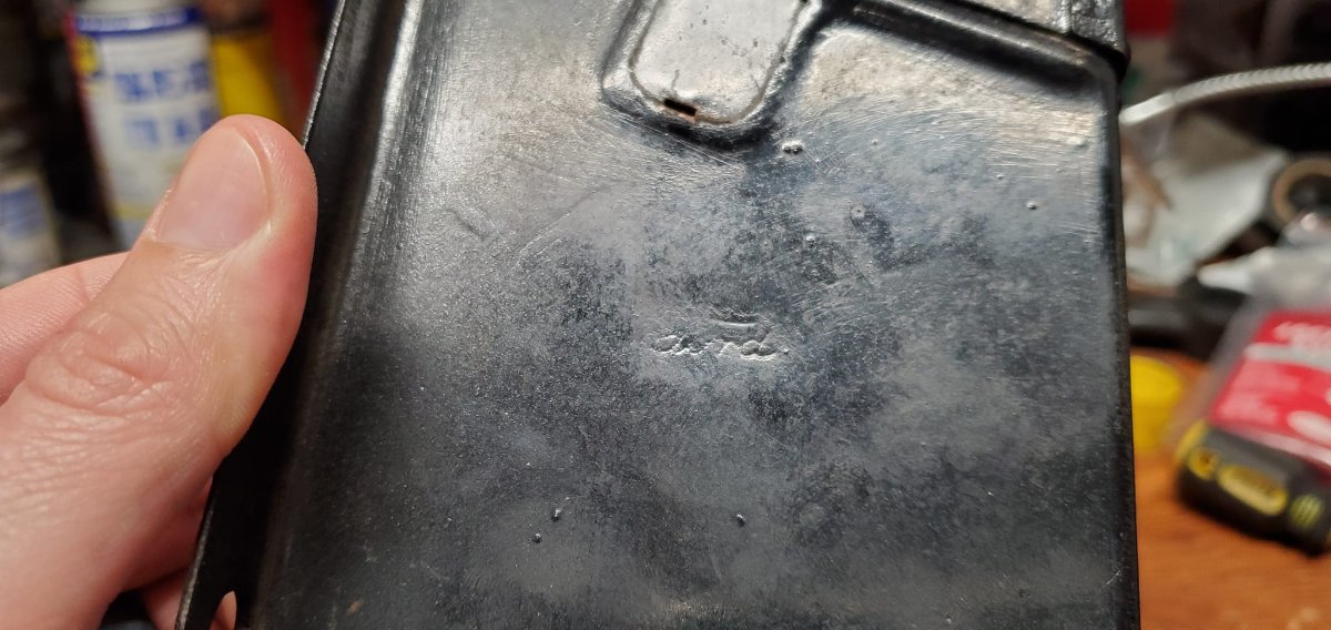

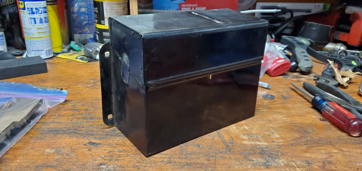

Hello everyone,
I have a May 1923 Touring car with short radiator and metal firewall.
I have the coil box apart for a rebuild and I wanted to make sure the side latches really should be nickel?
The judging standards show no mention of it, and the ones that I just took off are painted black.
From the standards: "Ford design steel coil box with sloping cover with no switch. Cover was the three-piece design. painted black."

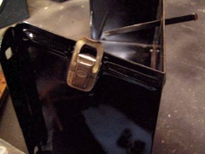

Yes, the tab fastened type latches, supplied by Corbin were nickel plated at least in '17-'24 style box with the ribbon divider between the pairs of coils.
Today that nickel is almost gone on most boxes, but if you inspect the folded tabs inside the lids, you can see remains of nickel on the exposed tabs.
At times you can find a real nice box like this one that has good remains of nickel plate on the Corbin latches.
Nickel Corbin latch.jpg (38.06 KiB) Viewed 1296 times

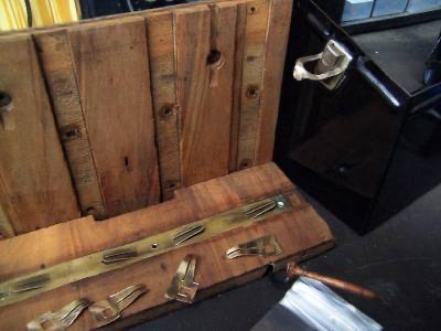

Close up of wood and brass contacts.jpg (48.7 KiB) Viewed 1296 times

Thank you so much! I am at work and couldn't access the encyclopedia. That really helps.
Next question to the group, after the box is sand blasted and painted... what is a good way to bend over the latch tabs?
