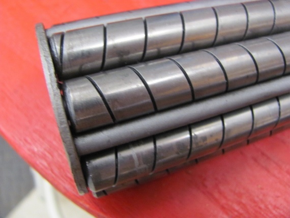

Appreciate your info on the later times of Hyatt. Seems a shame this technology is lost, as the ribbon roller bearings are the best for the Model T rear axle. Read your comments on the solid rollers and your use, but for my experience of lots of driving, and working on rear axles from Ts with what I will call limited milage, the solid rollers don't hold up.

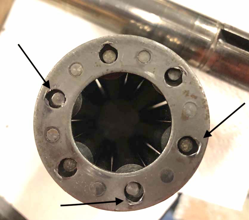

The design of these solid rollers presents 7 rollers with 7 axles. Each little axle rotates in the cage hole, and with the flex of the T, those ends wallow out and cause the rollers to become loose. Hammering on the axle shaft is the result.
Use of flexible ribbon roller bearing of the original Hyatt design is better IMO.
Worn low milage solid rollers I have pulled.
A bit more milage on this pair posted by other.

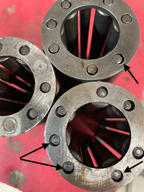

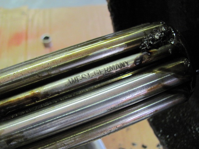

Thanks too, seems the recent versions of solid roller use 7. Have removed real older ones with 6 solid rollers, these were in the inner and marked "West Germany" so they were at least decades old. :)
Still prefer to use original Hyatt ribbon, they have lasted, and you can find very good used ones at any T swap meet.
Nice added feature is the ribbon rollers are hollow, so lots of lube passes to the axle shaft and the Hyatt sleeve race.

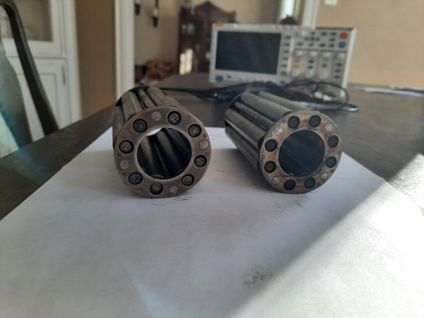

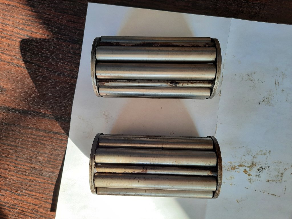

Pictures of my used bearings. Tim Wrenn helped me

Post by Art M » Tue Feb 15, 2022 8:52 pm

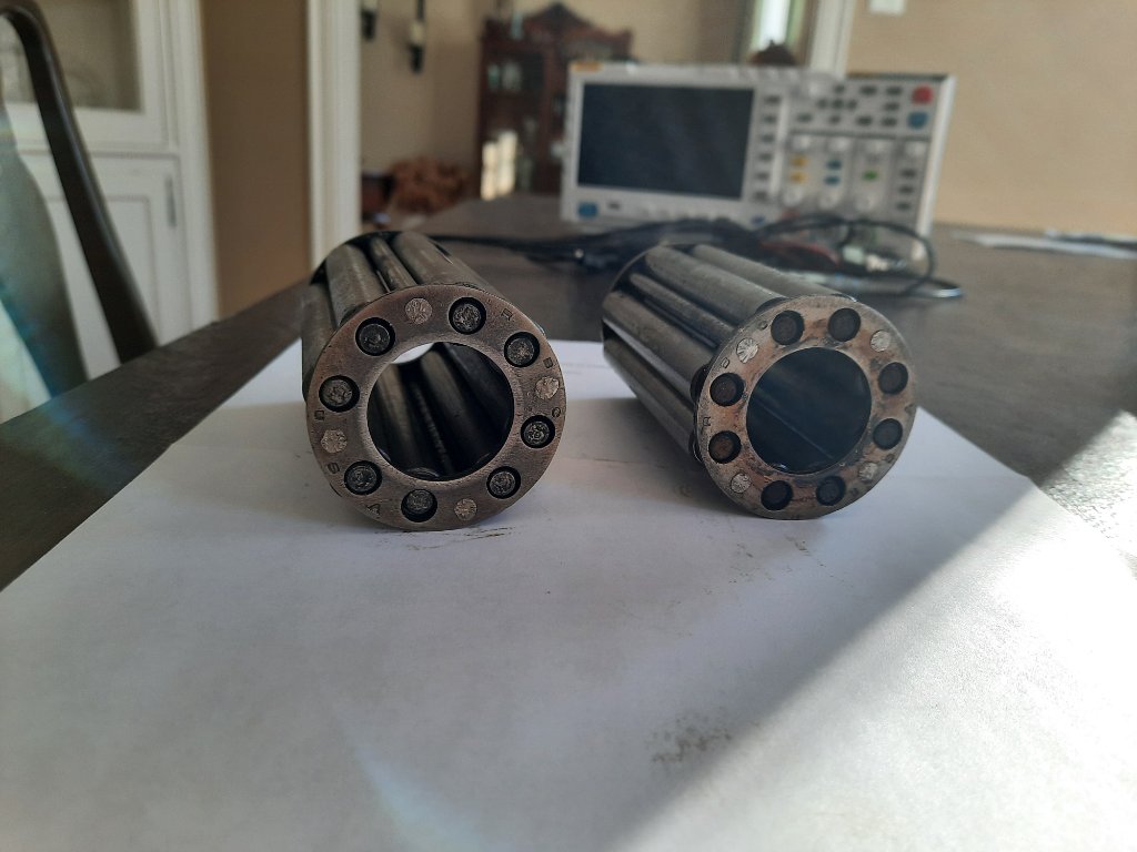

In response to several posters, picture were posted and arithmetic shows that the inner bearing misalignment more than the outer brgs.
Picture shows no wear or damage to the cages or rollers taken from my car. Thought to be 1970 or earlier.
Let's just hope that the wound roller bearing stay plentiful. Just loosen the radial play, which is a hard sell.
The pictures were taken in the dinning room while my wife was in the shower. She tolerates coil tuning in the house,, but not oily innards o21stf whatever.
Now it's time to check the condition of the wheel brgs in my car as well as check for axle seal leakage. Maybe still will be my next topic. No outer signs of oil, but I will examine inside.
Anotherpicture
