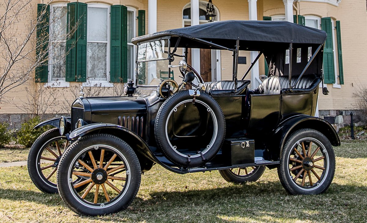

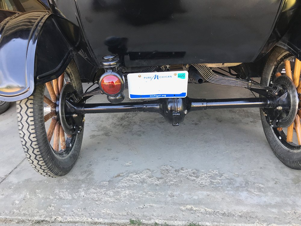

I have a '17 touring and often on tour end up offering my back seat to other Model T'ers for one reason or another. Has anyone ever built a removable rear luggage platform or luggage box for a touring of '16-'23 vintage? If so, any info and photos would be appreciated. I'd like to be able to strap some lawn chairs, etc. to it but then take it off when not touring. I also don't want to move the existing "correct" tail light and license plate bracket. My left running board already has a spare and a tool box on it and I don't want to clutter the right one. It also would have to fit in the space available when the top was folded down.

There were several "era" manufacturers of accessory trunk carriers which provided the same mounting spaces for the light & license plate - few & far between though !

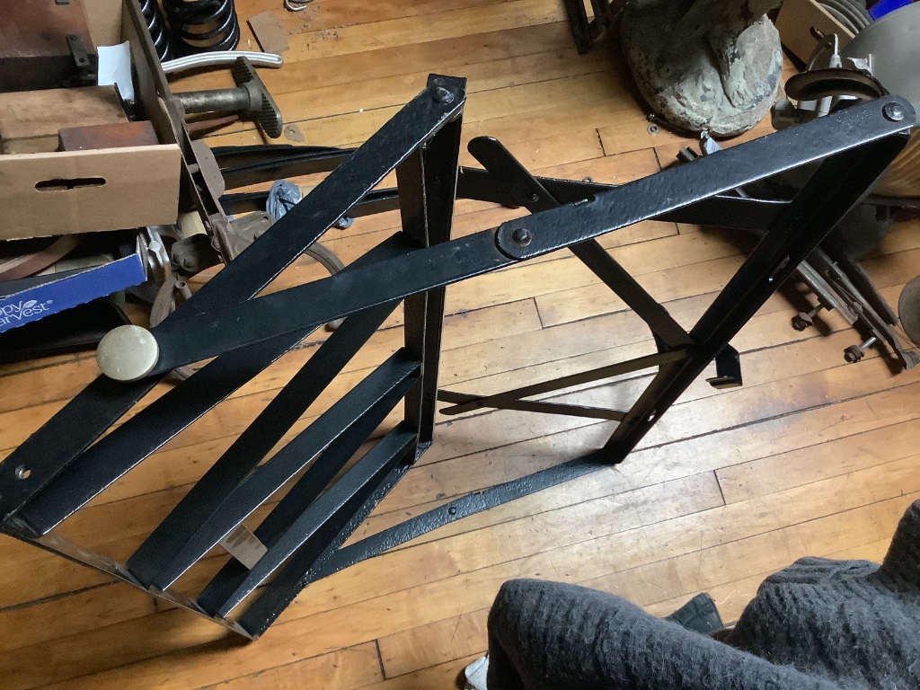

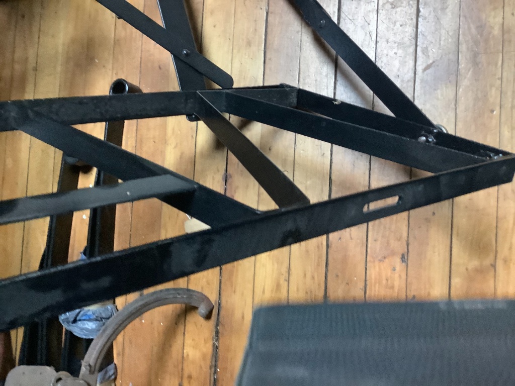

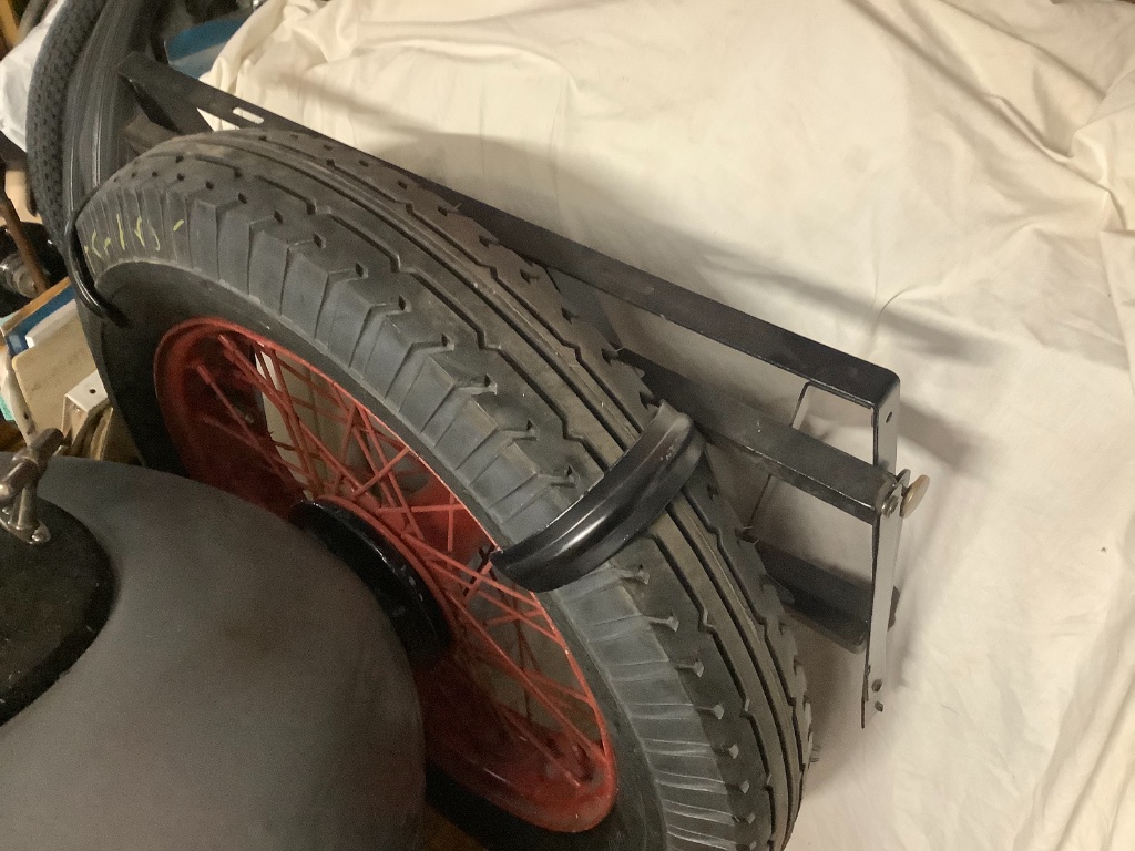

Tim, I have a nice folding one that straps on a rear spare tire. I’m using it on my merc spare tire. I can post pics as it would be pretty easy to make. Very light steel construction, and a nifty accessory you can put on and take off easily,

My '17 didn't have a spare (original wheels non-demountable) so when I added one I mounted it by the driver's fake door. I'd be curious to see what your mount is like, I wouldn't have the spare but I might be able to adapt the mechanism.

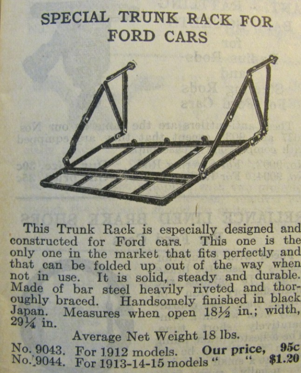

I thought about adding a luggage rack but so far I haven't.

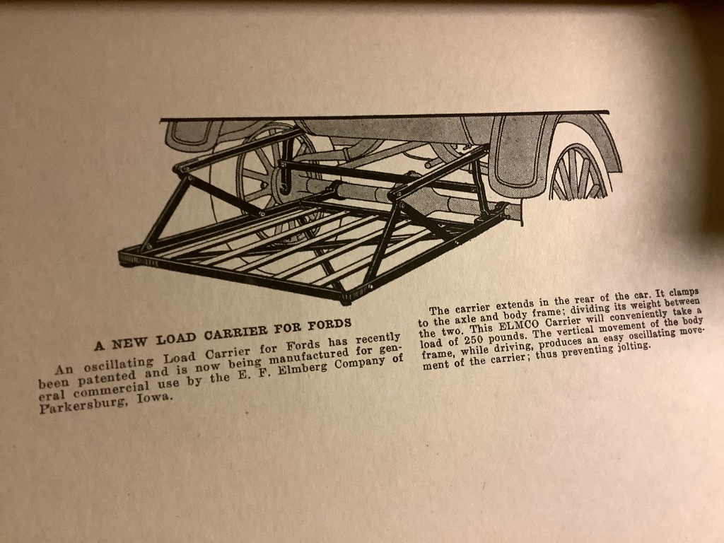

Here's a vintage picture of one.

I’ll take pics and glad to send dimensions or even send you the unit to copy. I’d say it could be easily made to hang over the rear seat. Pics later, just getting moving,

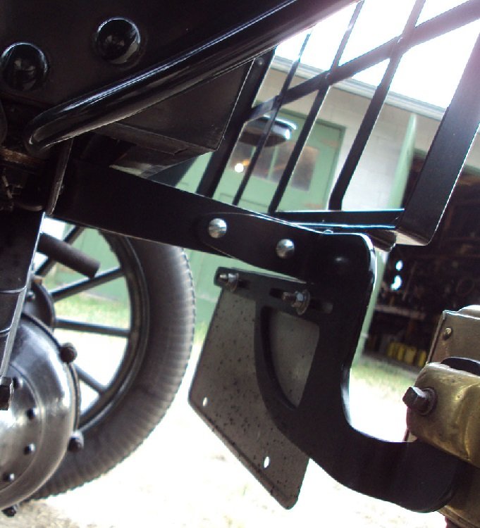

Posts: 6587
Re: Anybody ever add a luggage rack?
Post by TRDxB2 » Sat Feb 19, 2022 12:06 pm

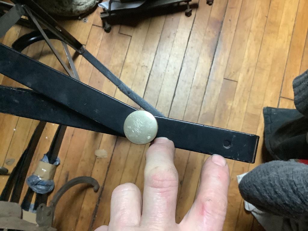

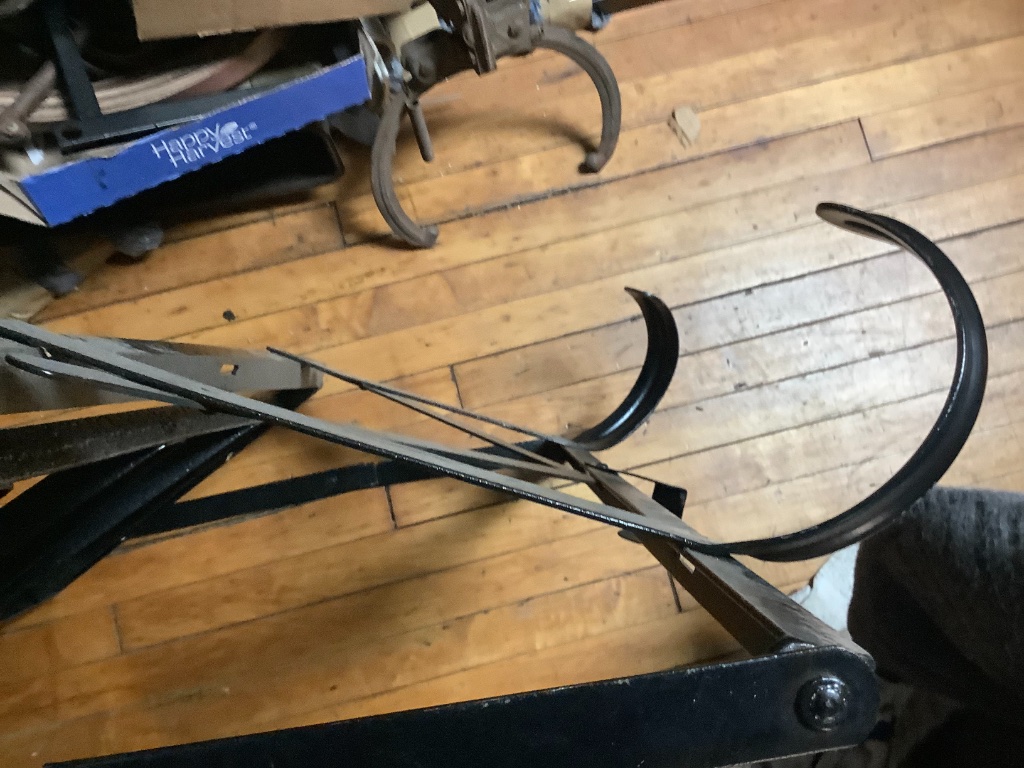

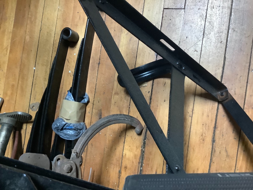

This one is very light, even being steel. Aluminum stock would be even better. I changed the hole to match the angle of my rear spare. Also has an oilcloth covered pasteboard trunk that’s held on with leather straps. Note the latch, the drop arms and also the slots for the leather straps. I’d say a junior high level metal shop project ( if they still had such a thing!) let me know if you want it Tim, and it’ll be on the way.
