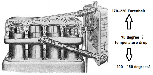

- Posts: 6587
Re: Anti freeze
From previous discussion viewtopic.php?t=24541&p=188032jiminbartow wrote: ↑Sat Feb 19, 2022 10:02 pmI use Zerex Original green antifreeze with IAT (Inorganic Additive Technology), not OAT. The directions recommend a 50/50 antifreeze to water mixture, but that is for modern engines with water pumps. I have heard that in a terms-siphon system, the greater the antifreeze to water ratio, the less effective is cooling ability (heat transfer) of the engine. Here in Florida, where this week the temperature has been in the 80’s and reaches the 90’s in the summer, what would you recommend as a more effective antifreeze to water mixture to ensure the most efficient heat transfer to avoid overheating. Jim Patrick
The answer to your question is dependent upon how much heat your engine would be generating in order to ensure that your cooling system (water & oil systems) would effectively maintain a proper operating engine temperature. Most documentation suggest a range between 180 -210 °F. .....Several older discussions have noted that their water cooling system was working properly when there was between a 30-90 °F temperature difference between the coolant entering the radiator and that exiting https://mtfca.com/phpBB3/viewtopic.php?t=4644. The cooling capacity of a radiator is dependent on many factors - air flow through it being a major contributor.
So the answer to your question also depends on how well your cooling system is set-up to can keep engine temperatures in range. The "cooling system" isn't just the radiator and fan (or presence of a water pump) but also includes the engine bay. The bay is designed to create a negative pressure to help draw air through the radiator and out through the fins of the cover (leave the pans on).
Since a 50/50 ratio provides an upper boiling point of 265°F, I would assume your Okay. A 180°F thermostat can also control the thermosphoning action by establishing the operating range - after that its up to the "cooling system" to prevent boil over.
