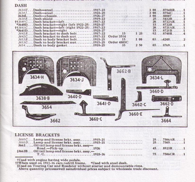

Why does the part list shows 3634-H for 1917 - 1923. Note also the * for the bracket years.

Frank B asked "Why does the part list shows 3634-H for 1917 - 1923." Referring to the low steel firewall.
Ford considered the steel firewall to be a superior replacement, and an appropriate repair/replacement for a damaged wooden firewall. Ford was not trying to satisfy our judging standards today. Just keeping his cars running, and his customers happy.
