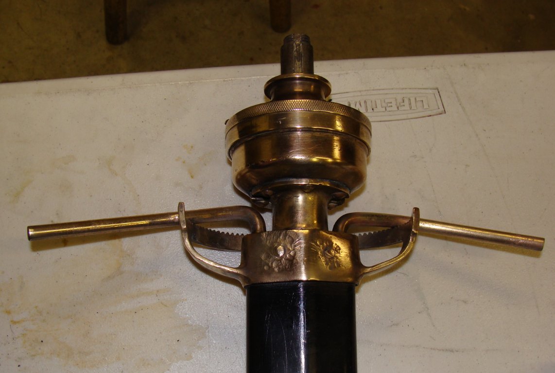

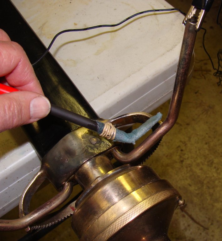

I plated my spark and throttle rods several years ago with a Caswell kit. The throttle has worn off in one area. I replated it over the past three days, but it doesn't look as good as before. Does the brass come from the solution, or from the wand they supply?
