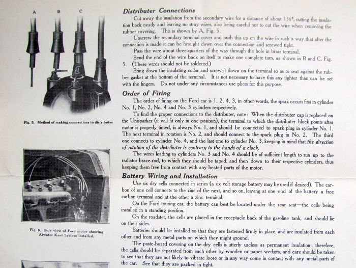

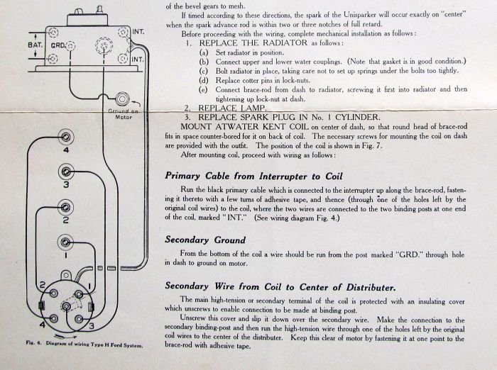

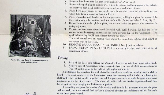

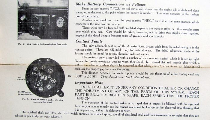

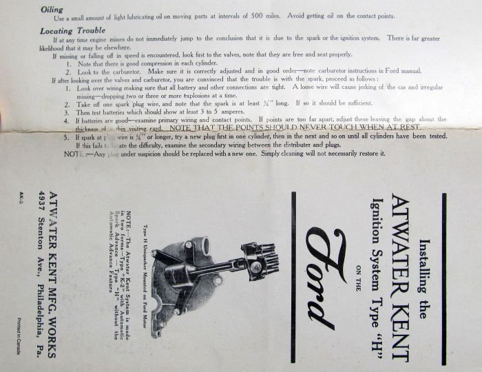

Atwater Kent Type H Distributor Instruction Sheet
Post by Jay In Northern Ca. » Tue Mar 15, 2022 12:17 pm

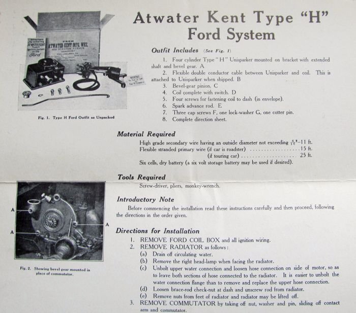

Re: Atwater Kent Type H Distributor Instruction Sheet
