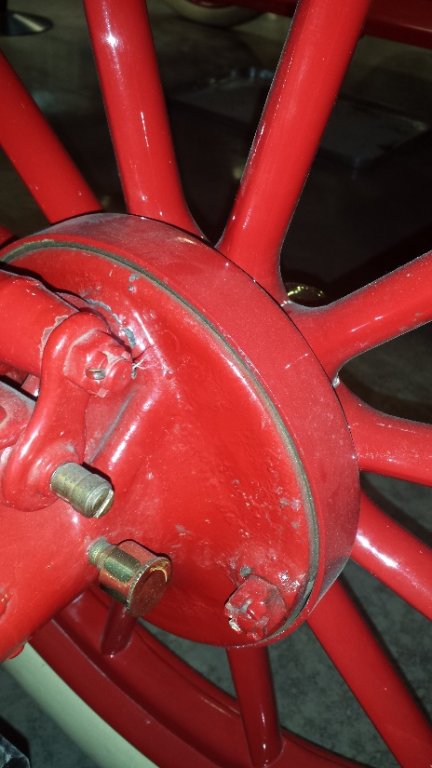

[attachment=0]20220329_100512.jpg[/attachment
Does someone here have dimensional data for the spotting bosses that are shaved off on the no-rivet rear end housings. No very clear but shown in this photo is one of these lugs at approximately 12:30. This part also has 2 similar bosses at approximately 11:00 and also 5:30.

Spotting lug in this photo is 3/4" from the backing plate/drum seam. Some lugs I've seen are not ground down this far...they stand out .01 to .02 maybe.
