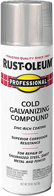

I have used this product or one very close to this and they look good on the rims.
