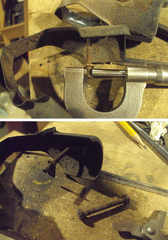

Keith:
After looking at your photo, I'm wondering if my response is out of order? Are the threads NC as I suspected, or are they really 6-32?
Larry

Post by brucesp » Wed Apr 06, 2022 2:48 pm
I'm confused. 6-32 is NC. Keith's photo is a closeup. Given that, it sure looks like 6-32x1½ with a hex nut to me (the nut is in shadow).

Post by KWTownsend » Wed Apr 06, 2022 4:59 pm
6-32 sounds too small. I'm thinking more like 10-32.
I'm not going to take mine apart to tell you tho...

Post by Rich Eagle » Wed Apr 06, 2022 6:00 pm
I measured these at #8-32.
