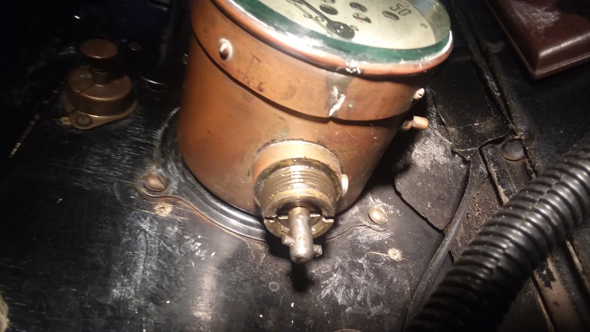

Pictures (I hope) of the receiving end of the Speedo...
Thanks again Kim,
More later

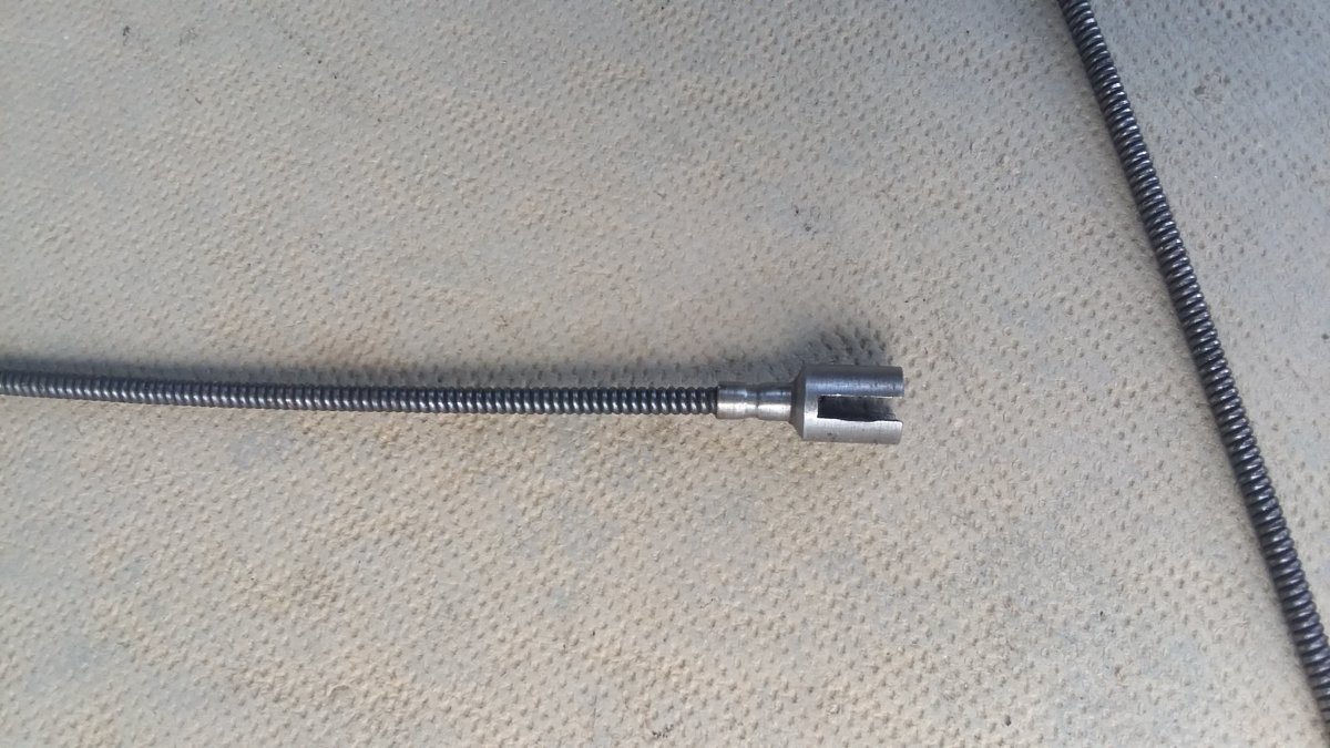

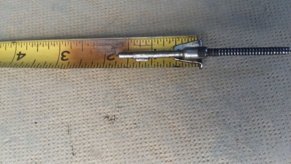

Kim= long slender end picture attached. if you have a replacement, let me know details
Cable (wound spring) is 55" end to end.
I will try attaching other pictures.'
Russ = thank you...I would like to send the cable to you for repair. I'd like to get the process started in case what I need turns out to be one of those "unobtanium" items. Would you please send me your address?
DAve
