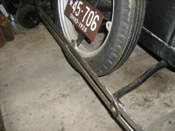

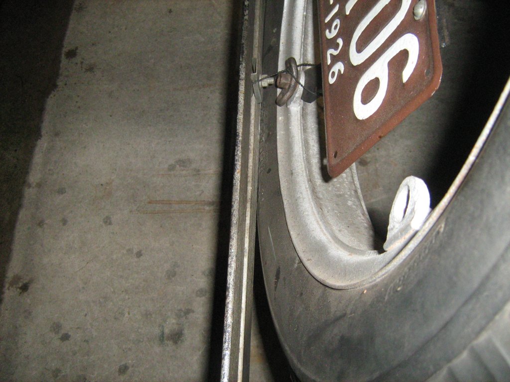

Arnie, As far as I know they all had the long bumpers but different rear brackets, short ones for sedans and tourings and longer for the coupes and roadsters not sure about the pickups. I have the short ones on my roadster and before I switched to wire wheels I would have to take the bumper loose to get the spare off. Jim

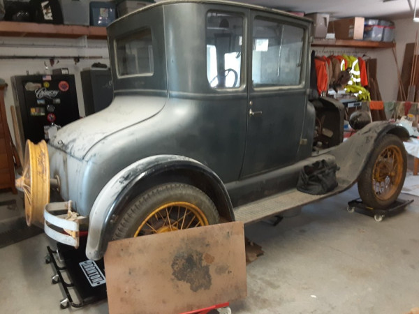

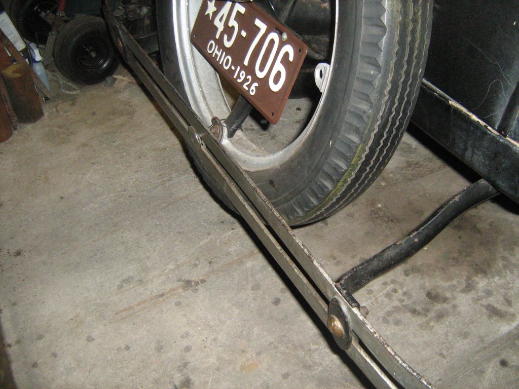

Here is a photo of my 1927 coupe showing the split bumpers.

Post by Arnie » Wed Apr 20, 2022 6:15 pm
Bruce:
Thanks for posting that rear split bumper photo.
With regard to engine/transmission assemblies: I believe Ford stamped the engine number on completed engine/transmission combinations, after assembly of the engine/transmission. However the actual vehicle may or may not have been built on the day the engine/transmission was completed. Sometimes engine/transmission assemblies were shipped to the point of final vehicle assembly. So vehicle build date may be different than engine build date which is based on the engine serial number and the dates shown in McCalley's book..
With regards to the rear split bumpers, do you know if that coupe was in the family since new? Could the bumpers have been installed at the Ford Dealer, or your relative install them himself? The reason I ask this is parts books seem to list spilt bumpers for runabouts and coupes, but in Australia.
However perhaps Ford did offer split rear bumpers for runabouts and coupes in the USA. It might be hard to find out as the bumpers were an accessory and were easy to add by individuals. Perhaps if others have improved coupes and runabouts with split rear bumpers, and comment on this forum, we may get a better understanding of just what happened. Perhaps the Bentsen Ford library has information we can research if/when Covid 19 issue is over. Vehicles that were handed down from one generation to the next especially with a know history may add to the information about split rear bumper availability.
Bruce, did your car have the original green paint on it when you got it?

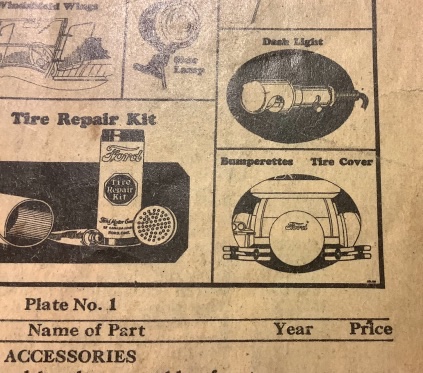

The Canadian literature and price lists on Australian marketed Fords indicates a 'split ' rear bumper, likely sourced from Canada, so maybe Canadian Ford had that split rear bumper too. But from the adv. that shows Canada Ford offered split bumper of a simple "open end" bar design. There would be no connecting tie bolt at the ends of the pair of bumpers, plus the bars seem fairly straight, with slight flare to the ends, but without a pronounced curve to wrap around the to the rear fender.
Canada Access Catalog Bumperettes .jpg (87.11 KiB) Viewed 3543 times

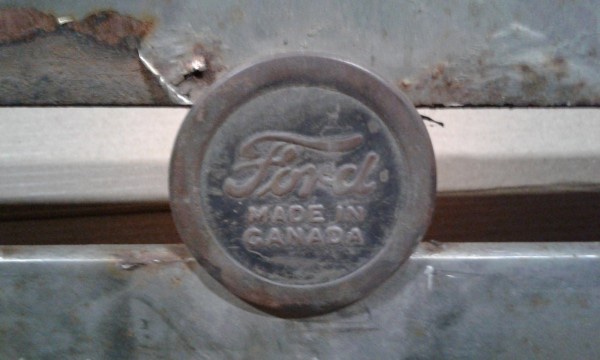

Canada bumper bar medal.jpg (55.6 KiB) Viewed 3543 times

IMO, the coupe pictured with the split rear bars is sporting non-Ford aftermarket bars, made by any number of suppliers like Marquette, Steward-Warner, etc. They may be this type:
