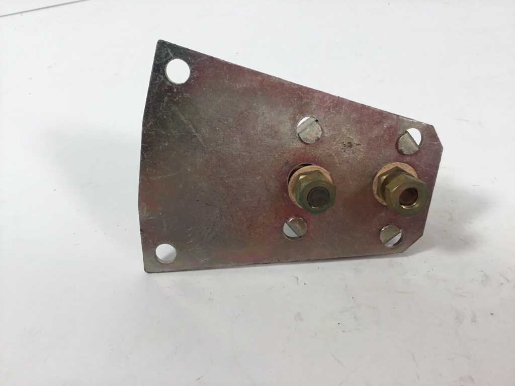

STILL LOOKING FOR LANG'S STARTER SWITCH UNIT # 5014RE
Post by lirogo27 » Mon Apr 25, 2022 4:51 pm
If anyone has an extra out there please let me know. The part has been on back order for quite some time. I will purchase the lesser item as replacement (5014) but i know this unit tends to wear out quickly. 5014RE is the better unit.
Thank you.!!

There seems to be some confusion here. The original poster is inquiring about a starter switch, part #5014RE. That's the foot button on the floor. The responses above are talking about the ignition switch, which is on the instrument panel.
MWalker
Posts: 475
Last Name: Walker
Location: NW Arkansas
Re: LOOKING FOR LANG'S STARTER SWITCH UNIT # 5014RE
Post by MWalker » Tue Apr 26, 2022 12:07 pm

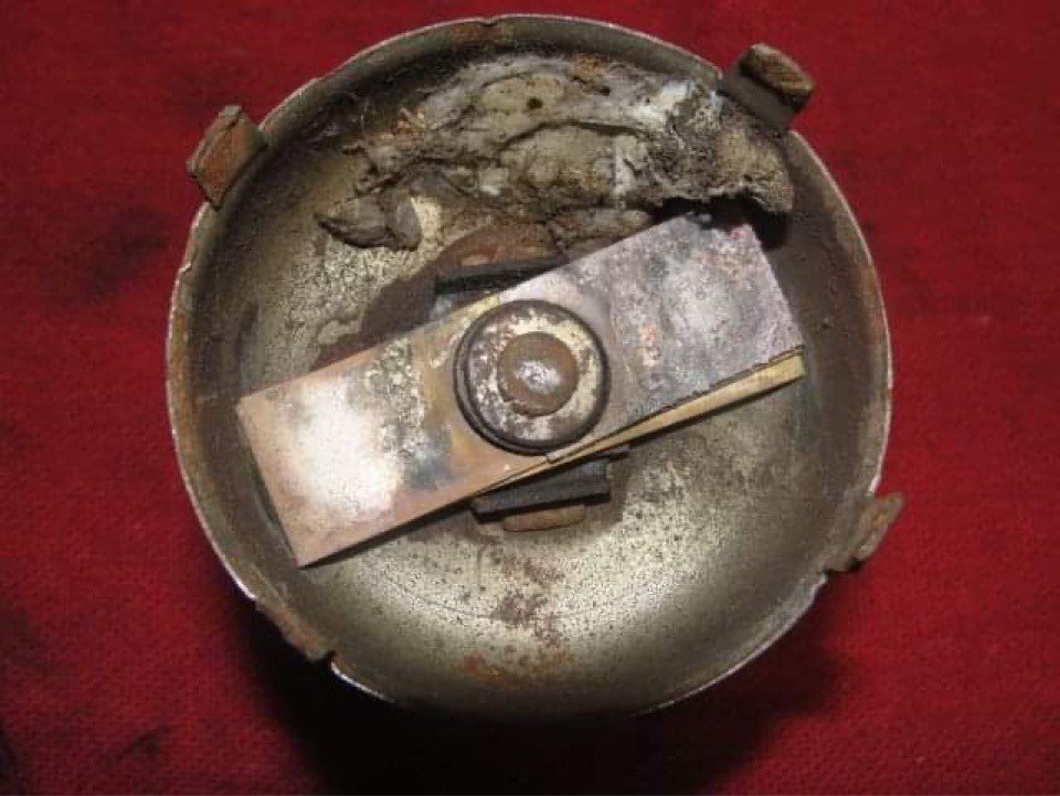

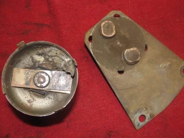

Lisa -- The original-type starter switch is prone to failure due to burned contacts, as you apparently already know. A much better solution is to replace that switch with a push-button starter switch as used in cars of the 30's and 40's, in conjunction with a starter solenoid. The push-button switch is usually mounted on the heel panel below the front seat, or on the instrument panel. This is a much better, longer-lasting setup. It does require a bit of re-wiring to install those parts, but it's not a big job. Someone in your local Model T club probably has done this to his car and can walk you through it or do it for you.

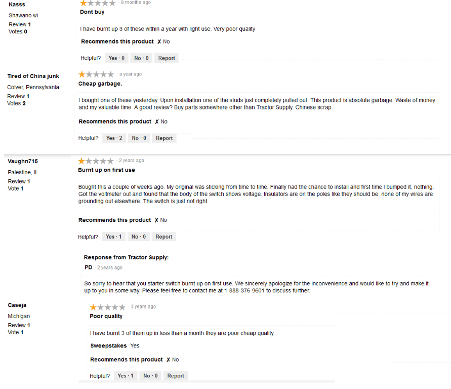

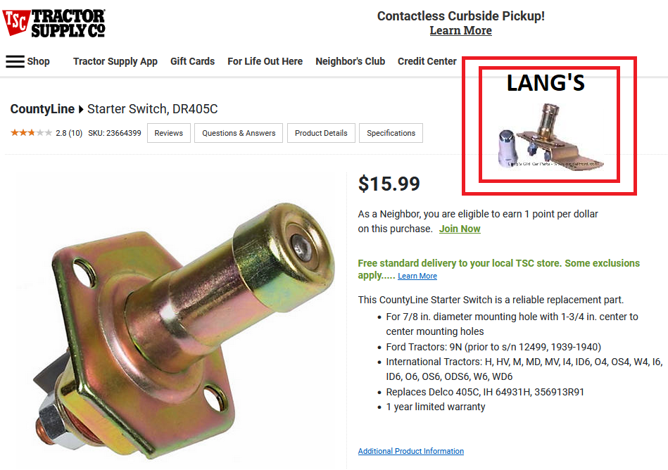

I agree 1000% Unless they have changed the guts of the repro switch I would stay away from them.
some previous discussions
https://mtfca.com/phpBB3/viewtopic.php? ... er#p216124
https://mtfca.com/phpBB3/viewtopic.php? ... er#p215691

TRDBx - Yes Agreed the guys do know how to do it and have done it. I wanted to try to keep the T 'original' but we are trending towards the push button which really works well from what I have seen on a couple of the cars.
I will speak with the Long Beach guys about moving towards that and gathering up and ordering the parts. I was able to find both an old version (Langs had one) and supposedly a new version (Ecklers) although I will believe it (the latter) when I see it when it arrives. No one I have contacted has a new reinforced version - although the picture in Ecklers catalog is the new version. Holding my breath.
Thank you for the suggestion. I am all in on the push button as long as there are no other draw backs. Thank you again!

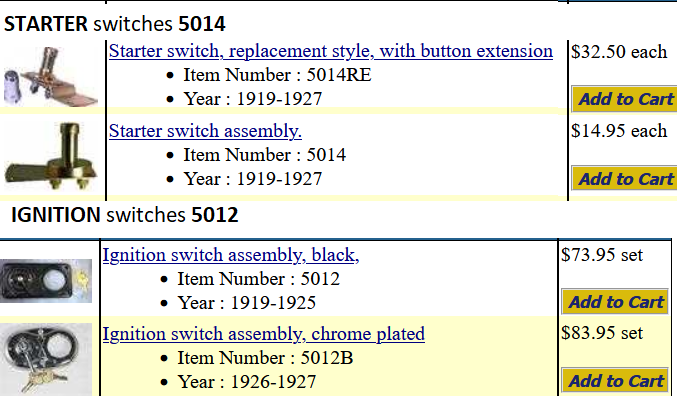

I do not have a paper copy of the Lang Catalog. I went to their site, put 'starter switch' in the search box on the left side and 5014RE was the first thing that came up on page 1 of 18 pages. The 5014 was three of four pictures down from the RE.

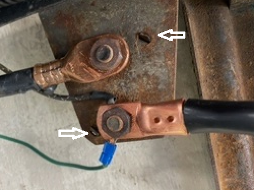

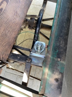

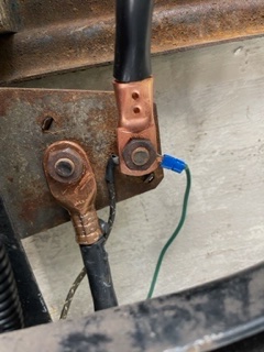

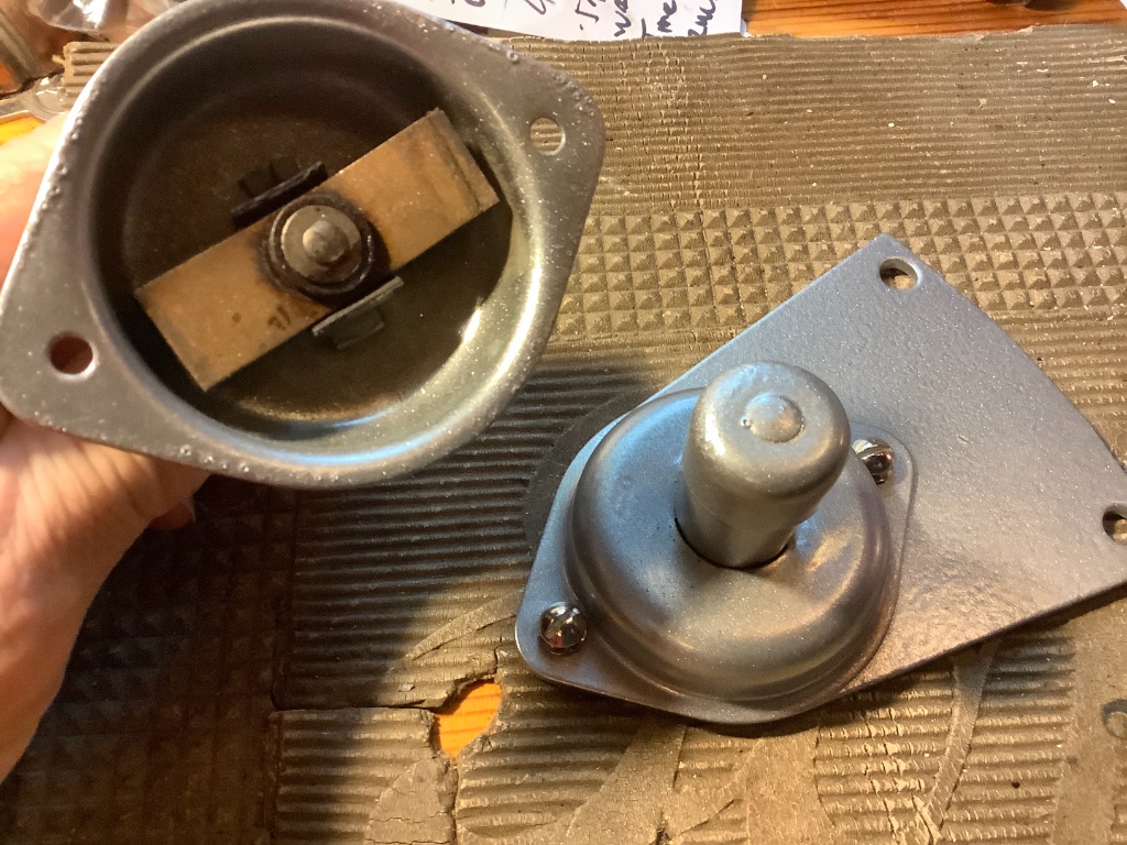

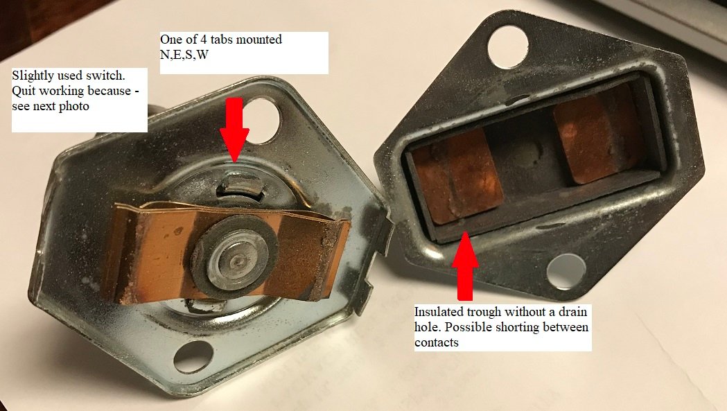

WELLLLLL it was not the wiring. The wiring is all new - every component is....as is the starter. The 6v battery was purchased on 3/25 but will all the attempts at starting unsuccessfully here and there I am guessing the battery was also taxed.
As requested - picture of wiring is attached. What the problem was was indeed the starter switch. The unit plate was corroded as was part f the insides of the plunger. There were insect nests in there and also one of the metal pieces that is depressed inside the plunger was cut in half and floating around in the plunger unit. It was this broken piece that when it came in contact with the housing shorted out the process and caused the switch to heat up. Martynn took the plunger and mounting plate home to examine them further but somehow age did the unit in.
I will ask Martynn to take a picture of the plate and plunger inside so you can see the condition but the broken metal plate in the plunger is the culprit....

that said, the cable to your starter looks too small
you want 1/0 or 2/0 on both cables and it should be crimped AND soldered
the wire to your barrier strip (ignition switch, lights) from the "hot" side is almost certainly too small of a gauge (the other wire doesn't even belong there but that's for another day) - it should be 12 gauge and that certainly doesn't look like 12 gauge
sizes are here: https://www.engineersedge.com/copper_wire.htm

Posts: 6579
Re: STILL LOOKING FOR LANG'S STARTER SWITCH UNIT # 5014RE
Post by TRDxB2 » Thu May 05, 2022 10:20 pm
I assume the first picture is your new switch in place.
If the attached picture is a before shot prior to you folks looked inside.... it shows signs of being tampered with. The arrows point to two of the four tabs hold the cover that should be bent over, not broken off.

I will look into the wire gauge and the type of wires. The first picture is the new switch installed. The picture you have a close up of is indeed the old switch from underneath. All the wiring was replaced in exact positions and locations as to where they were on the old switch.It is clear that most of the wiring is new. But yes the bottom of the old switch was in horrible condition. I asked Martynn for pictures of the plate and the inside of the plunger...he took them home to look at them closer Both the plate and plunger were in horrible condition.

Scott_Conger wrote:
Thu May 05, 2022 9:36 pm
glad you found the problem with the starter switch.
I will find out where to buy the type and gauge you recommend.
Posts: 6794
Post by Scott_Conger » Fri May 06, 2022 9:08 am
Just call Lang's and order the heavier of the two cables they offer. That will be oversize to the original and will guarantee minimal voltage drop during use.

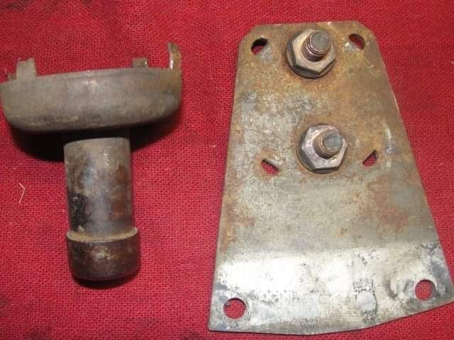

OK Folks - here are the promised pictures of the starter switch removed. If you look closely, The upside down picture of the base of the plunger unit you will see one half of the metal pieces is missing. That is the piece I sent a picture of yesterday. That piece when dislodged from its customary location was coming in contact with the housing causing the short.
The NEW 6V battery is on a trickle charge right now and it is still showing yellow after 12 hrs. I will leave it on until mid day today and have a friend unplug it for me noonish. I will attempt to restart the car tonight when I get home from work and drive it around the neighborhood for 15 -20 min when I get home from work tonight. Hopefully that will help.
Posts: 3027
Last Name: House
Post by George House » Fri May 06, 2022 12:57 pm

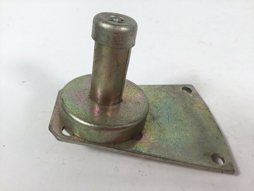

Lisa- throw that junk starter switch away but retain the trapezoid looking base. Then go to Tractor Supply (TSC) and buy a GOOD starter switch and mate it to that base. Good advice on 6V heavier cables.

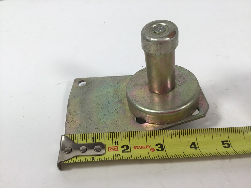

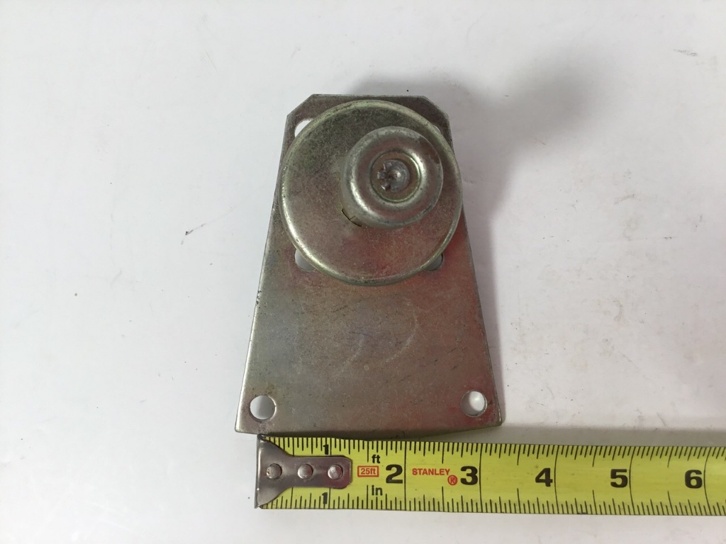

I'm back on my soap box.
The switch mechanism that Tractor Supply sells is essentially the same as what is on the repro's that the vendors sell. In fact its also available at most Auto Parts Stores. Now that you realize that, when the switch on the #5014RE fails you can just buy the switch body and replace it on the plate that came with the #5014RE. No need to try an fabricate a switch plate from the old one. Here is what Tractor Supply sells and a picture of the 5014RE for comparison.
Here is link to Tractor Supply https://www.tractorsupply.com/tsc/produ ... tch-dr405c
The switch they sell has a 1 year Warranty :? So save your sales receipt.
Here are some reviews
This is what's inside - look familiar
