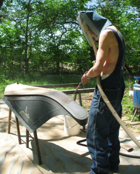

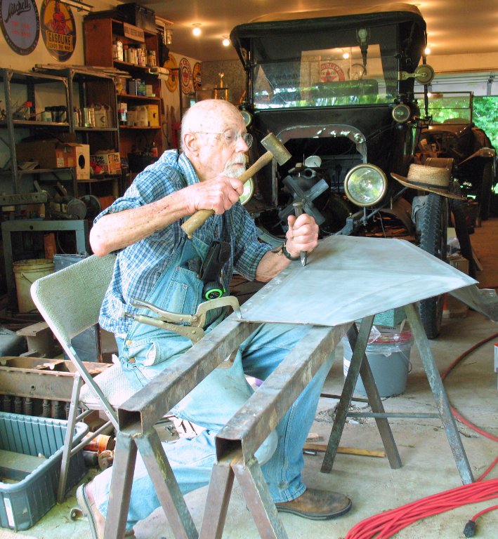

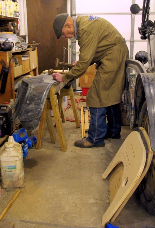

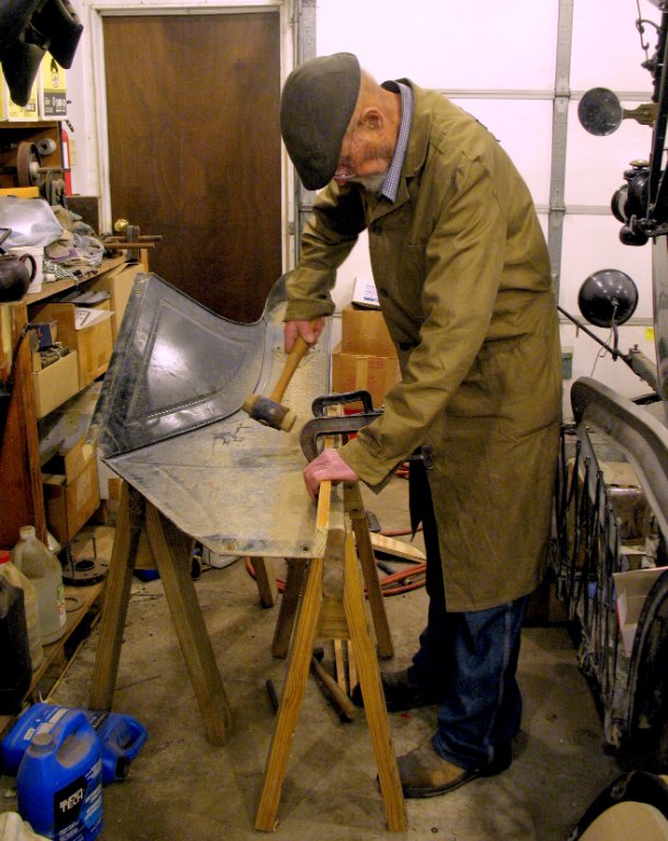

Nobody else has done it, so I'll start it off this month.
I'm not an experienced body man, but today I pounded on a bent front fender.
I got it straight so it doesn't pop back to bent. It's ready for finishing the sandblasting, and then soldering.
My other job of the day was straightening the dings on this front wheel from running on gravel after throwing a tire last fall.

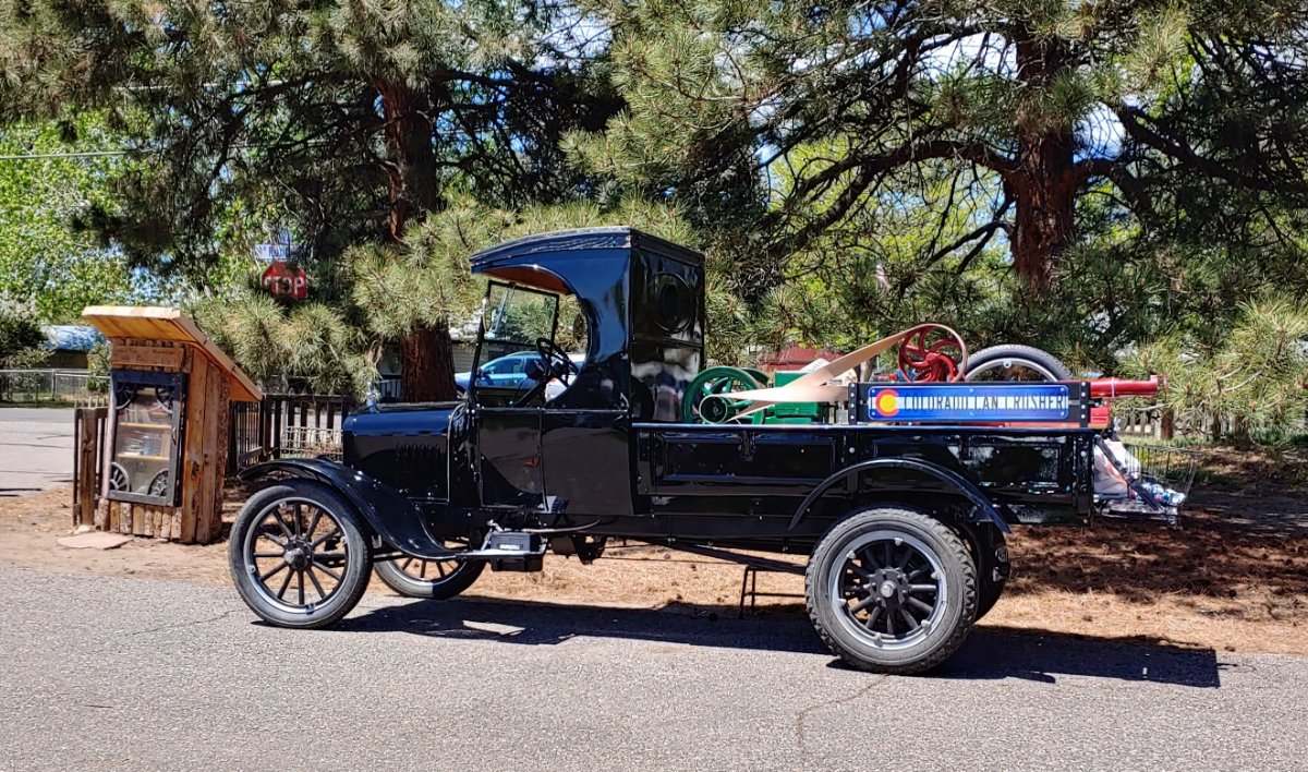

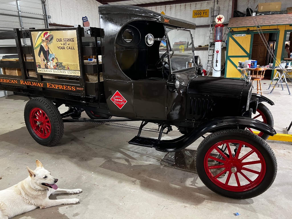

Completed the rebuild and fine tuning of a nice set of coils, then re-
-installed the e-timer I had on the truck briefly when the engine was
freshly rebuilt (removed while I worked out other bugs). Truck moved
out like a scalded dog, but died intermittently, leaving me to push it out
of traffic and ponder my problem. Seems the battery terminal in the switch
is breaking contact and requiring some love. A quick setting of the mag
wire to the feed terminal on the connection block got me back on the
road and home. Damn, would it pull hills ! I am impressed.

Steve, straightening the fender skirts can leave you with a fender with not quite the same side profile. I usually trace the outline of a good fender on some stiff card and cut the outline to use as a template for the other side fender. If the skirt was stretched when it was bent, and all you did was straighten it, you may still need to shrink it a little to get the profiles to match. This may lessen the grief of trying to get the front of each fender sitting at the same height.
Hope this helps.

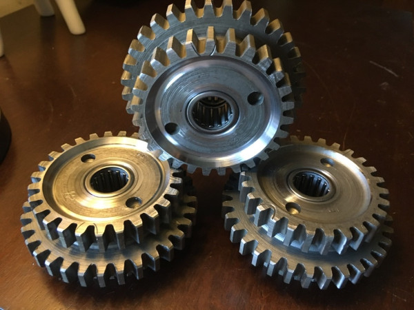

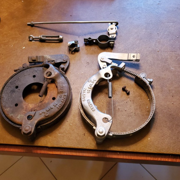

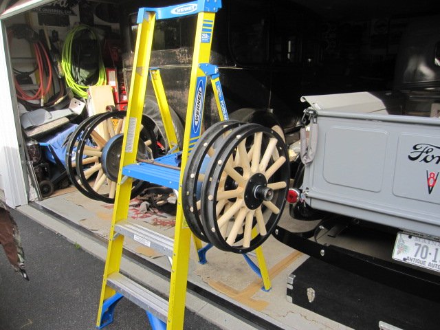

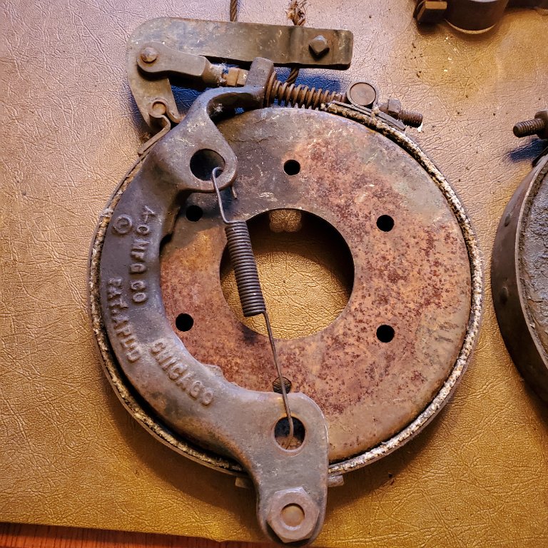

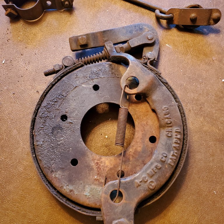

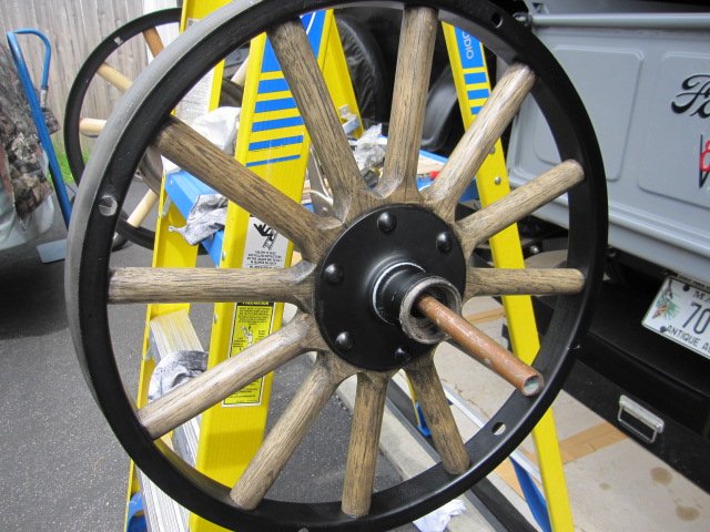

I have been getting wheel parts ready for my '14 to go to Calimer's wheel shop for new wood.

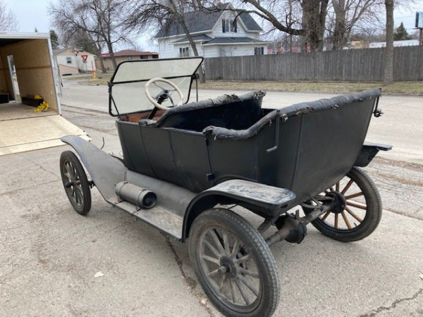

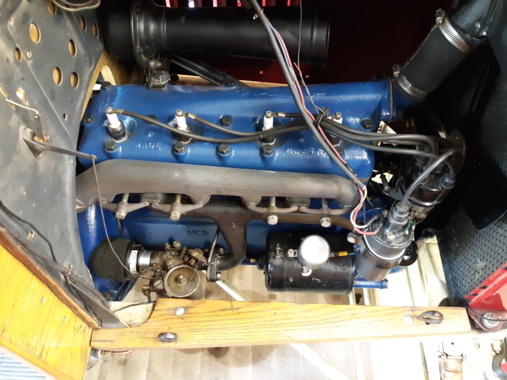

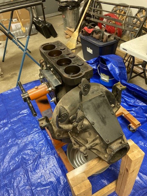

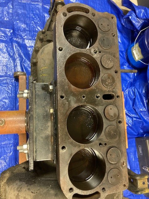

Started on the first leg of my 13 Touring project. The engine was out of the car and stored in a shed for many years and its stuck. Been soaking the pistons in Kroil for a week. Going to remove the the pan and transmission in a few days and start soaking pistons from the inside out. No obvious top end or water jacket cracks yet. Number two looks like it had some water in there for while. Really want to save this early June, '13 engine. Pics of the car and the engine.

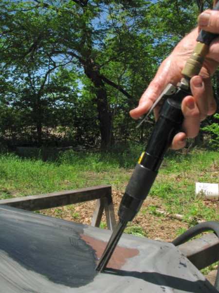

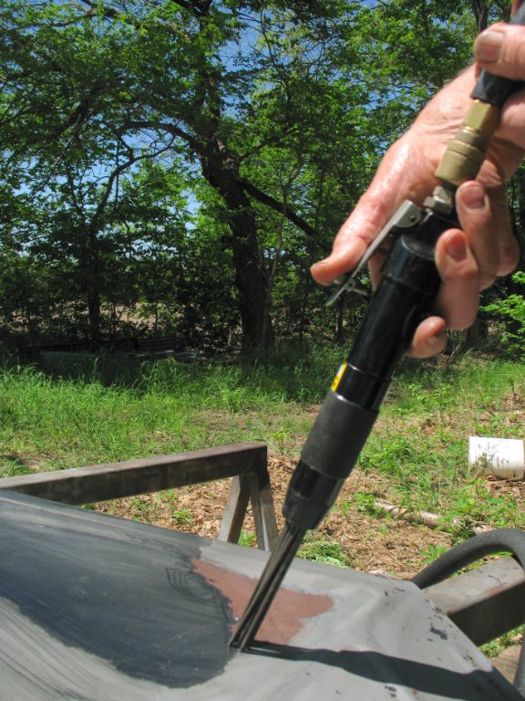

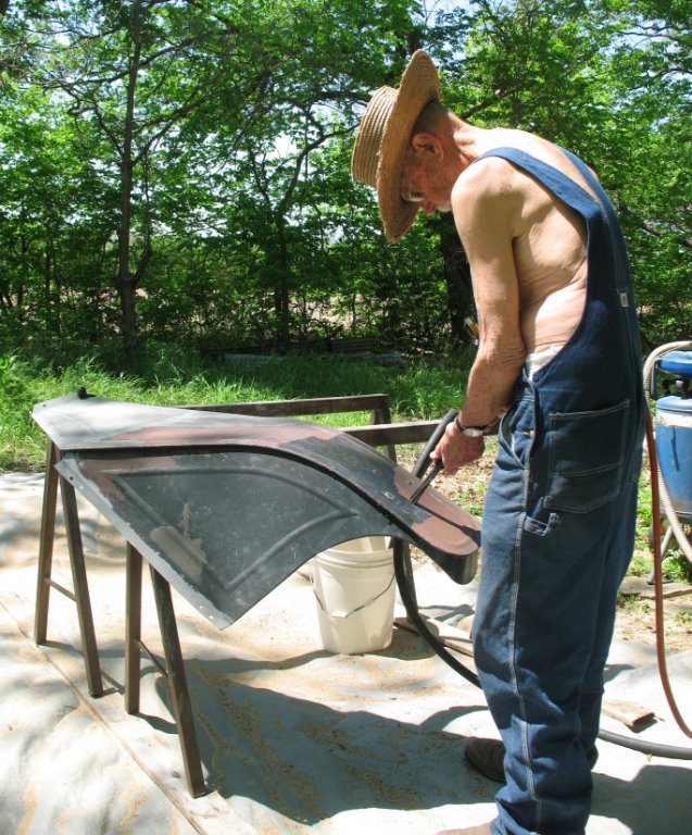

More front fender blasting.
The old lacquer was awfully tough, and it was mighty slow going until I remembered the pneumatic scaler.
That breaks up the lacquer and uncovers the red primer.
The primer comes off a lot faster.

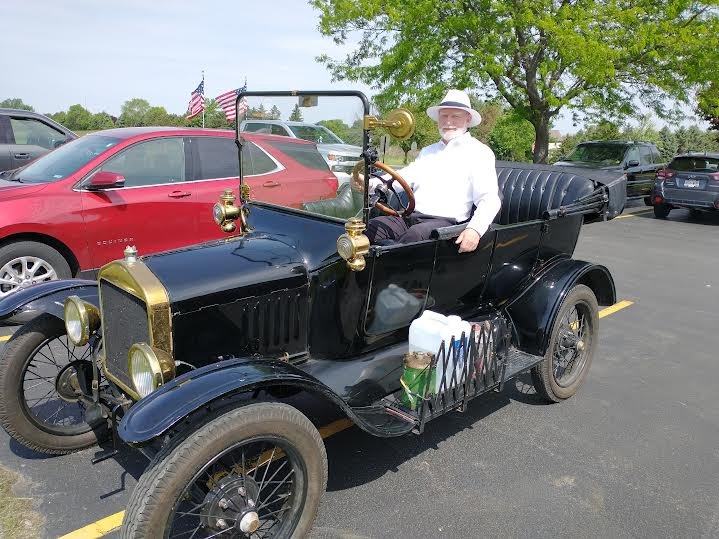

This morning I took Lizzy, my 1926 touring, on a 10 mile round trip to the bank. When we got home I changed her oil and finished greasing her universal joint and drive shaft bushing. Now we are all set for the summer.

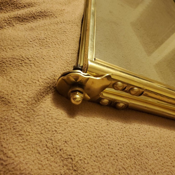

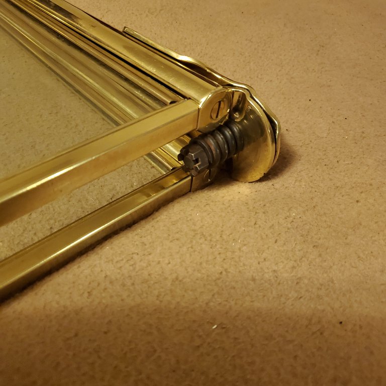

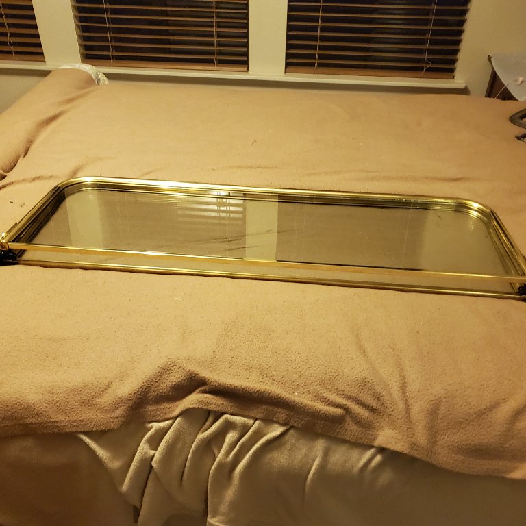

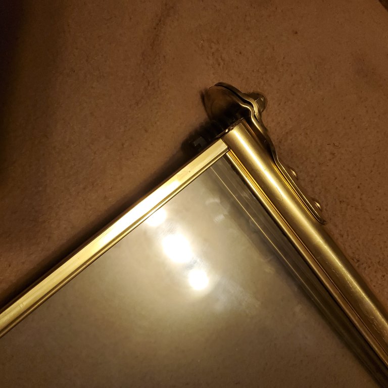

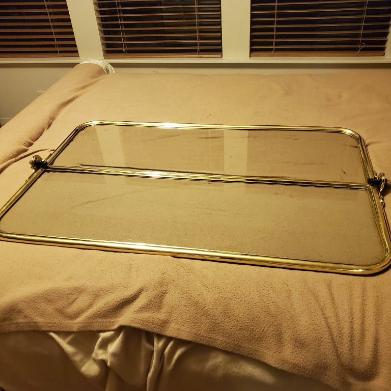

Just finished the brass windshield for a 1912 MIL roadster. The car was delivered to the painter so I'm finishing up odds and ends. The car was in an accident a few years ago and both panes of laminted glass were broken and the bottom frame and center channel were bent. I was able to straighten the frame and replace the center channel. The windshield was new 20 tears ago but was installed on two cars over the ensuing years up until the accident. It has a few niks that didn't polish out but I got it all to fit back together pretty nicely I think.

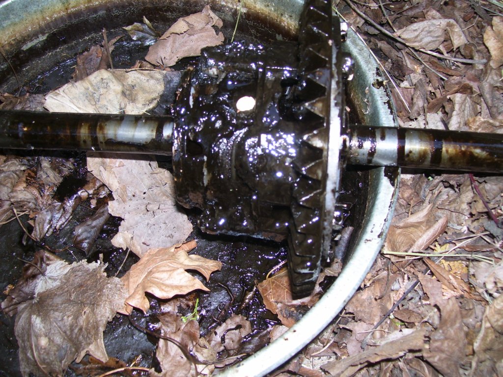

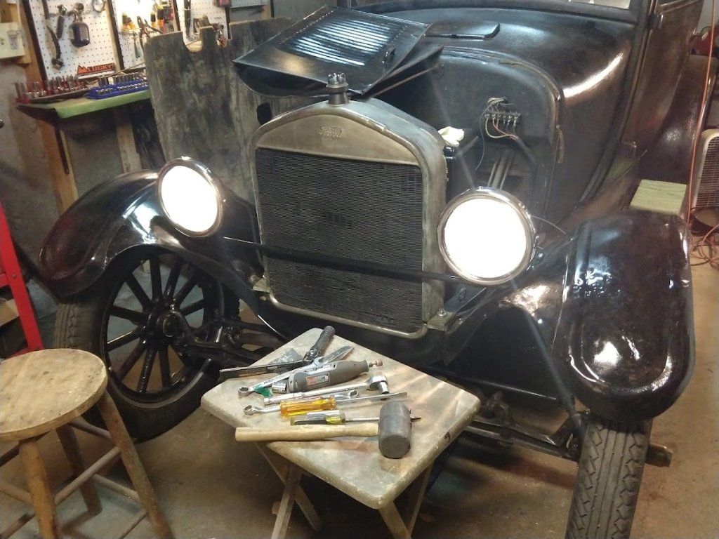

Maybe not a big deal but I took my barn-find (last October) "Barn-ey" 27 Tudor that had been parked since 1968 out on the road for it's first drive in 54 years. We didn't go far since we are still getting to know each other but Barney was very happy with his new wheels and rebuilt vaporizor. First ride was only 3 miles but second drive was 4. Still smiling because I think those that know me thought I was crazy for dragging it home. Got a long way to go with it but it is a functional car again. I bought a sewing machine and teaching myself how to sew so I can put an interior back in it. Working on putting together a rebuilt rear axle to swap out to avoid any thrust washer problems. Having a ball piecing it back together, and learning a lot. Going to be a fun summer!

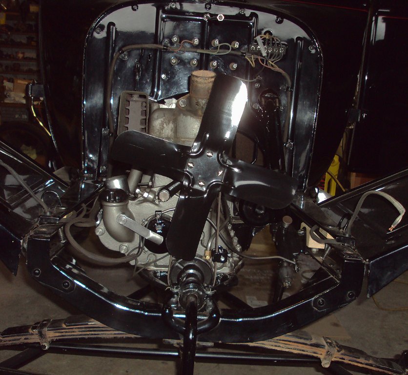

Got the motor for the 12 towncar back from Joe Bell, it’s back in the car but have a few more things to button up before starting. Installed a rebuilt ruckstell, reset the Rocky Mountain brakes, combined two rear leaf springs, added a leaf to possibly strengthen the rear bounce. Bought a new front spring but have to rebuild a new to me DB front axle with new hassler shocks to put under the car. During the winter, while no motor, built a rear luggage rack for looks, pretty happy with it. These cars were either used as a limousines or taxi cabs and I figured a luggage rack in the back is somewhat appropriate. Once it is back on the road, I want to install led directional and brake lights into the existing light fixtures so they are not noticeable till in use. It seems I have rebuilt everything on this car again for the third time but it is finally the way I want it. I think I am like a lot of T owners, like tinkering and working on the cars more than driving them but with two in the garage that is going to have to change. Our club has a tour every month and I enjoy it every time.

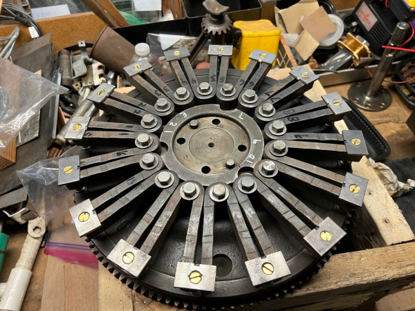

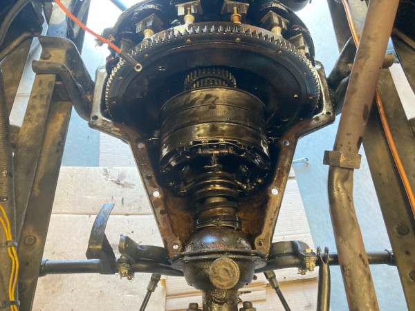

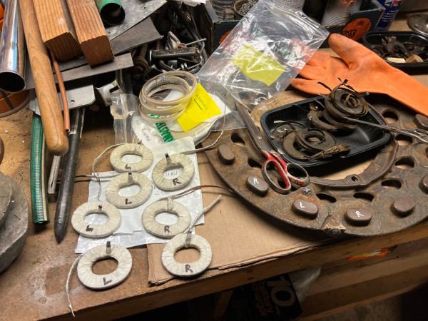

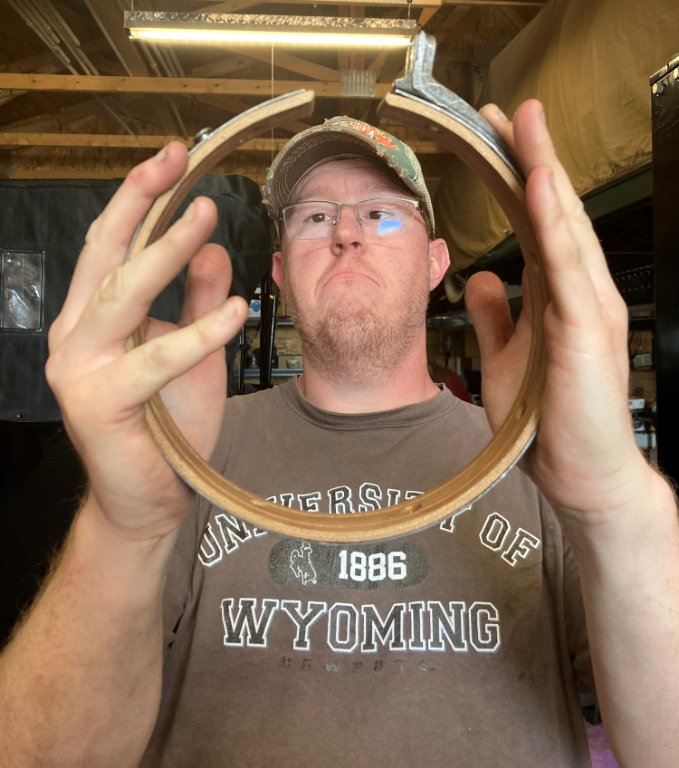

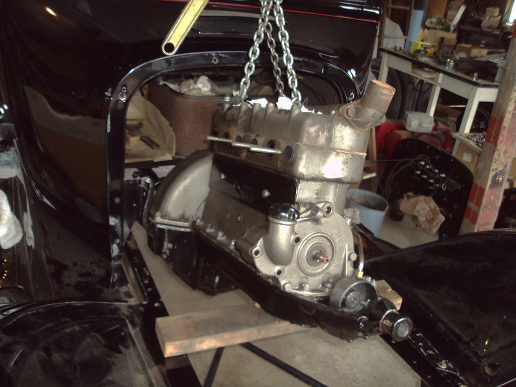

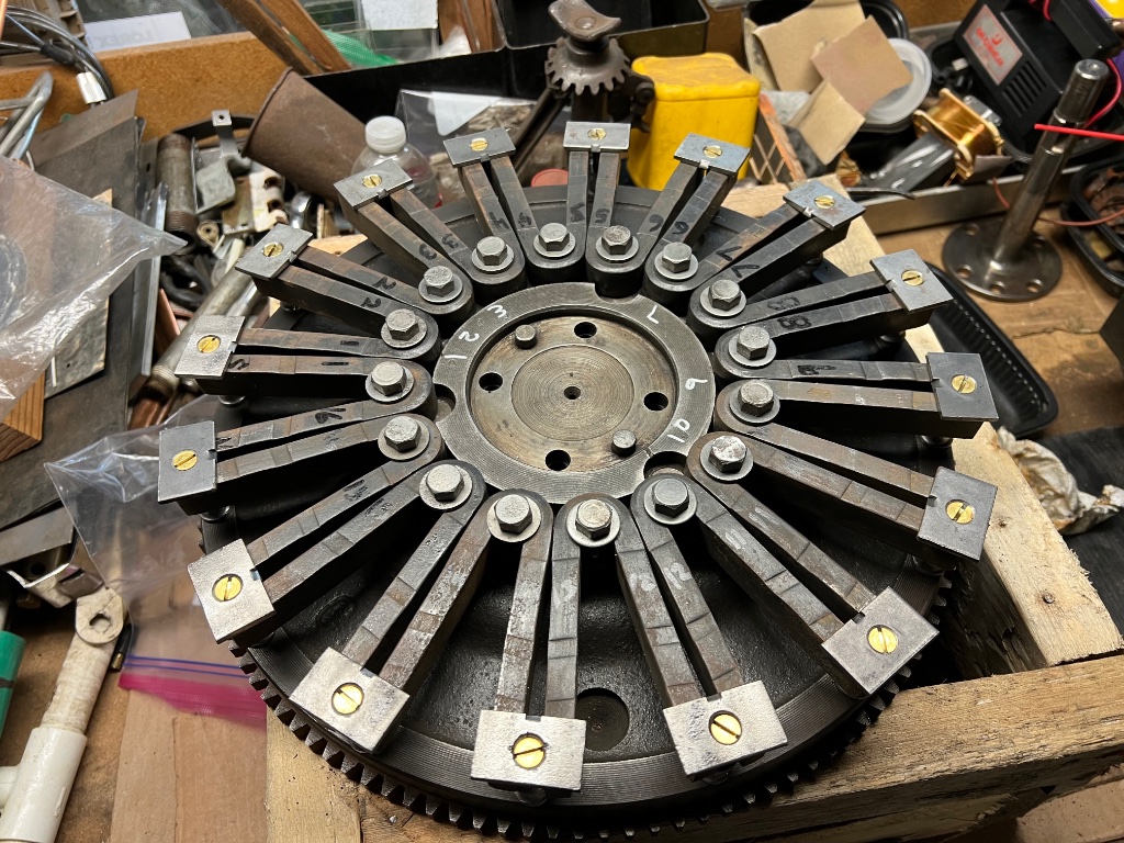

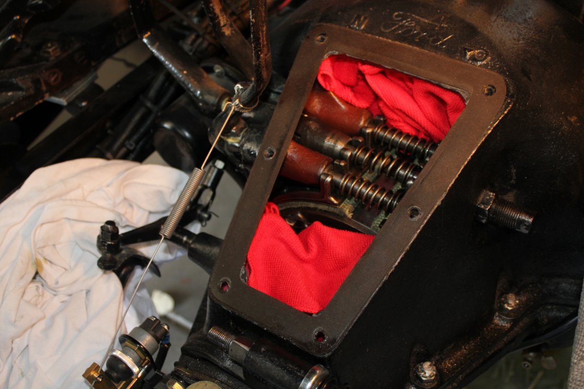

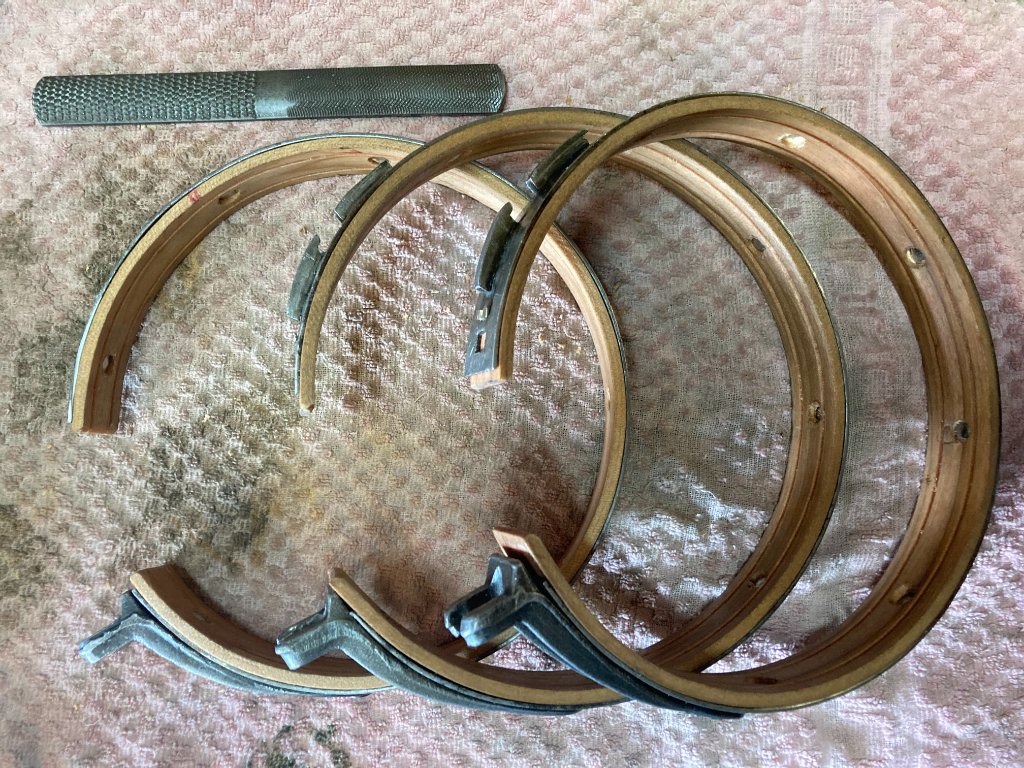

At long last I set the engine back in the Tudor. We lost the bands on a tour last Fall. I managed to repair the damage and after some illness, the Winter weather and some yard work, I have gotten back to it.
viewtopic.php?t=23886#p183662
The Kevlar band lining didn't smooth out like it should after riveting the ends flush. It worked well on the last batch but this one left some humps. I installed them and tightened them to the max hoping the lining would compress. Then I loosened them to give clearance for breaking in.
Rather than fight the transmission cover in the car I decided to install it on the test stand along with the starter. Removing the firewall was necessary for this. It went in easily except for the usual go round lining up the U-joint. I will work up the courage to put the firewall back in place later today.
As Larry mentioned a few days ago, it is very rewarding to and remember the work in putting the car together the first time. Those extra details to make it as right as possible are soon forgotten and a treat to see again.
Keeping my fingers crossed.

What you have done with kevlar bands is a transmission disaster in the making. Those hi spots will create constant heat/friction. Take em out & properly re-rivet the lining. For the cost of a few rivets & a little time, you are going to loose some drums & pull the motor again.Rich Eagle wrote: ↑Fri May 13, 2022 12:06 pmAt long last I set the engine back in the Tudor. We lost the bands on a tour last Fall. I managed to repair the damage and after some illness, the Winter weather and some yard work, I have gotten back to it.
Kevlar lining is great stuff when done properly, but is very unforgiving. It must be respected.

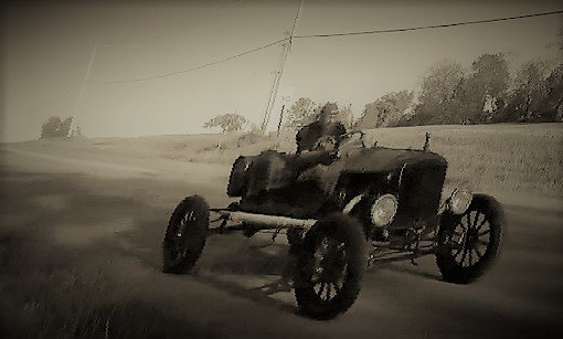

I got to drive our 1925 home from school, and had a lot of fun!

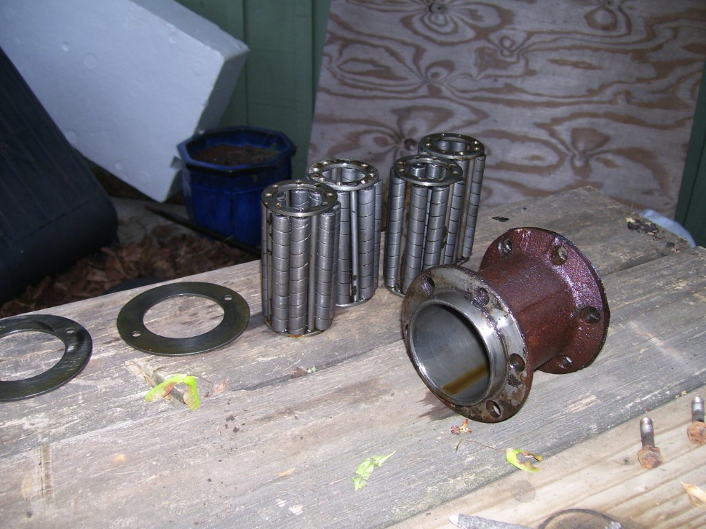

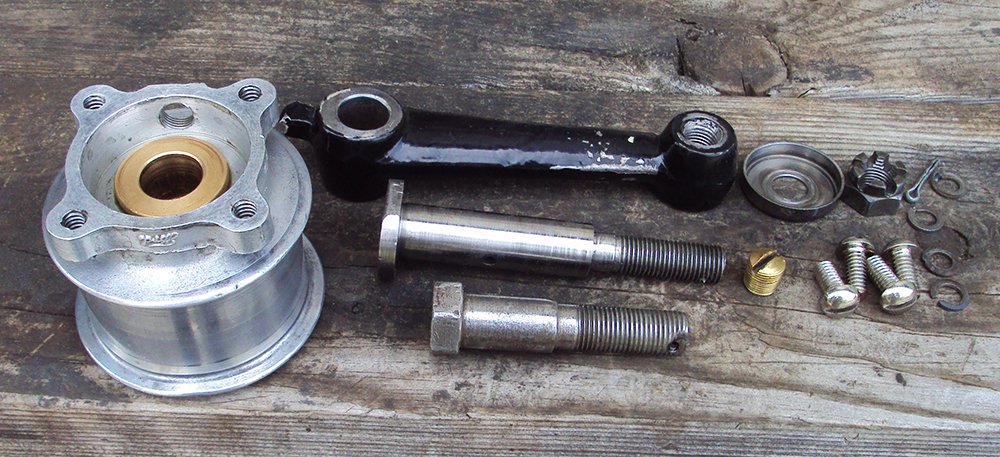

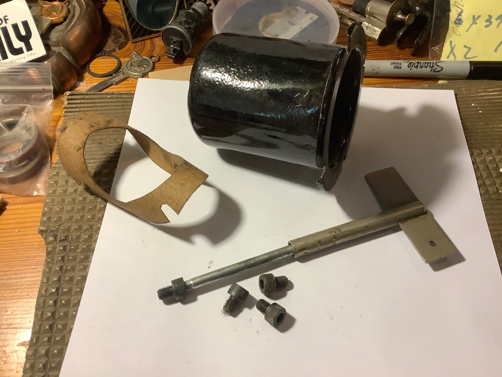

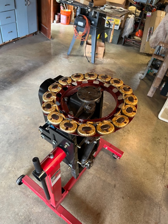

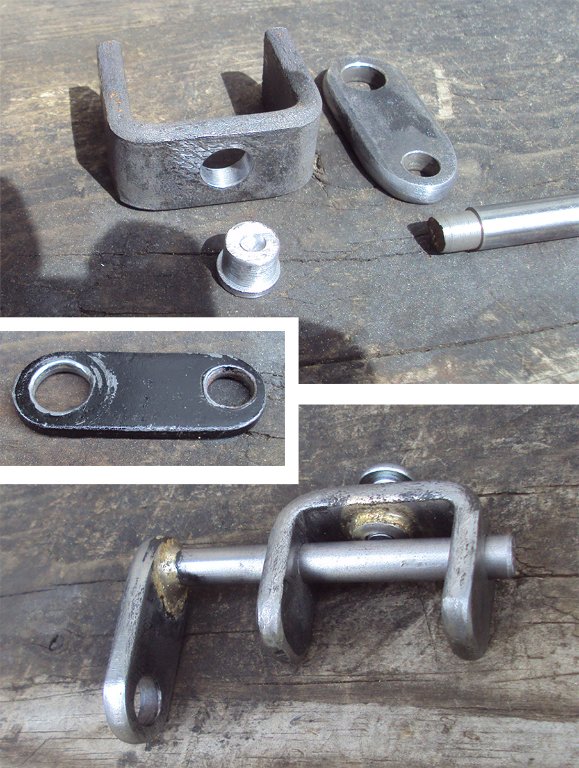

Fixed the starter bending on the ‘25 roadster. I had postponed doing this for several years fearing what I might find when I got the old bendix out. Turns out it was just the long bendix bolt that was broken, and the missing piece was still in the bendix cover when I removed it. No harm to the rest of the motor. Still, I had to deal with my least favorite part of a Model T: the inside bendix cover screw. The getting it out part wasn’t too bad, but the getting it back in part is what strains my patience.

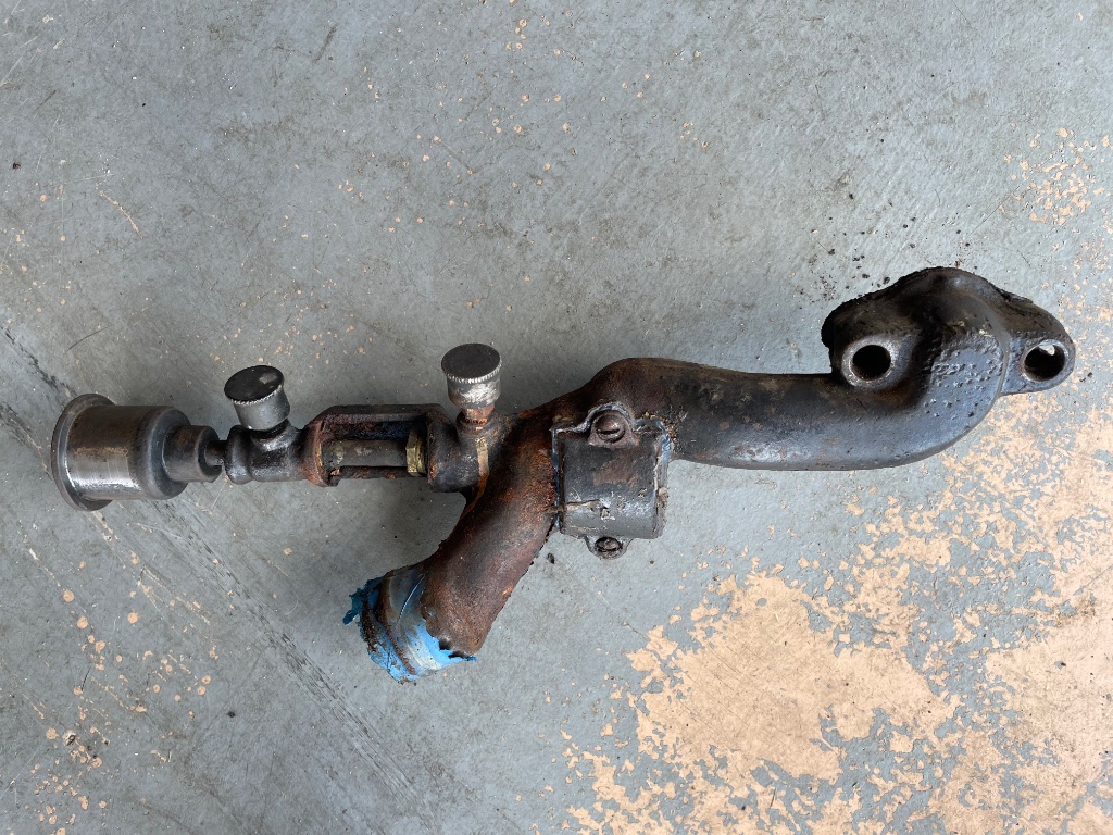

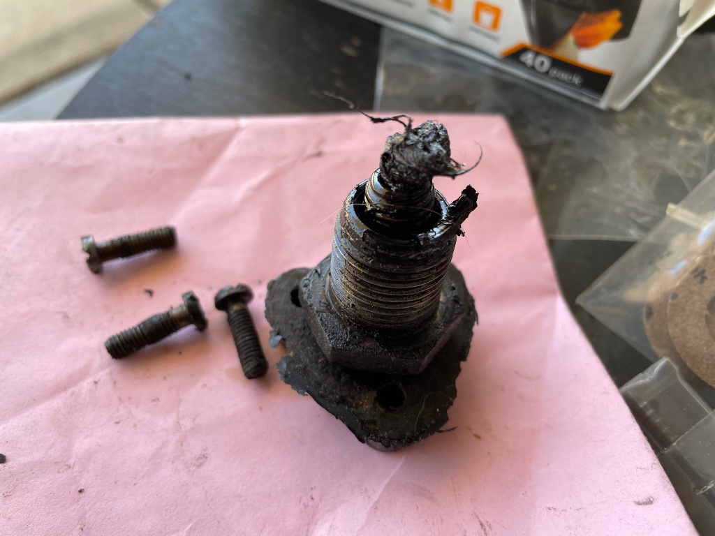

My ‘24 touring came with a water pump, and was cooling fine. I went to add some grease to the shaft cups and what was inside looked more like candle wax than grease, so I pulled the pump to clean it up and found it locked up tighter than Dick’s hat band and a nice polished section on the pulley where the belt had been slipping. I have a new inlet elbow, pipe, hoses, clamps, and belt to go back original. I figure if cooled well enough with a stuck pump, it should do even better without it.

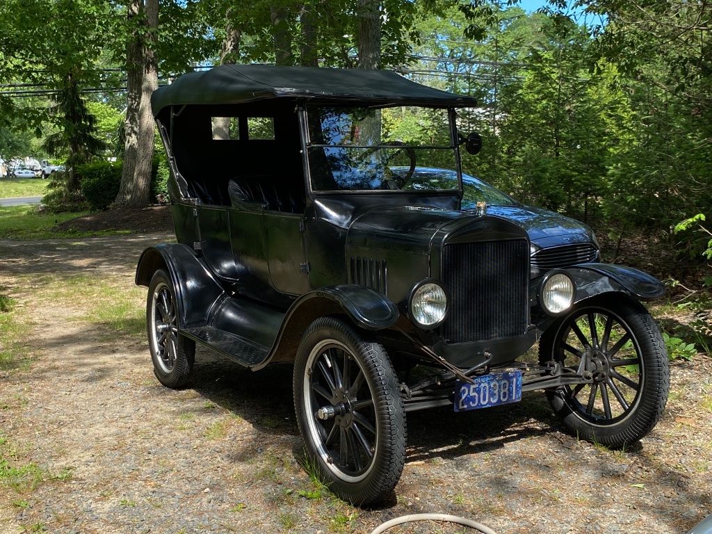

Finally got new windshield glass installed (plate glass had cracked due to sagging windshield frame). Then finally got headlights wired and running properly. When I restored the headlight buckets, I left paint on the surfaces where metal to metal contact is necessary for grounding. One headlight worked, the other was barely on. When cleaned of paint they both worked fine. Next is the horn wiring. I have a Fox locking keyed wheel and the inner contact ring needed some restoration as some of the plastic insulation was gone. Solution? Black liquid tape. We'll see how that comes out. Thanks MTFCA for all the family help.

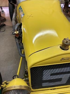

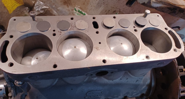

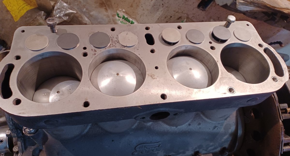

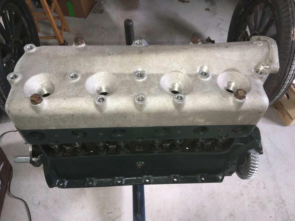

Test fitting this increased compression head for clearance. Thanks Mr Prus! had these triple gears fitted with needle bearings! They took a trip to California and back. Thanks Mr McEachern! Otherwise having a blast in the model T world

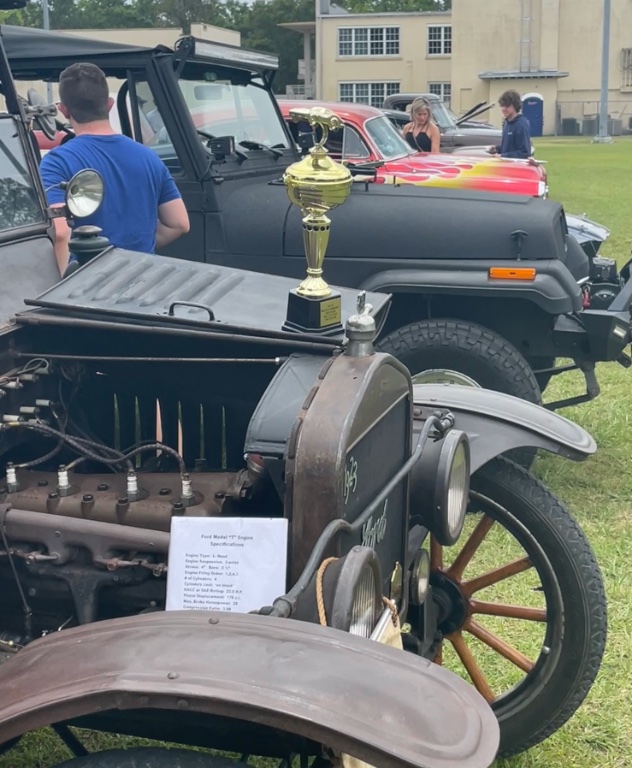

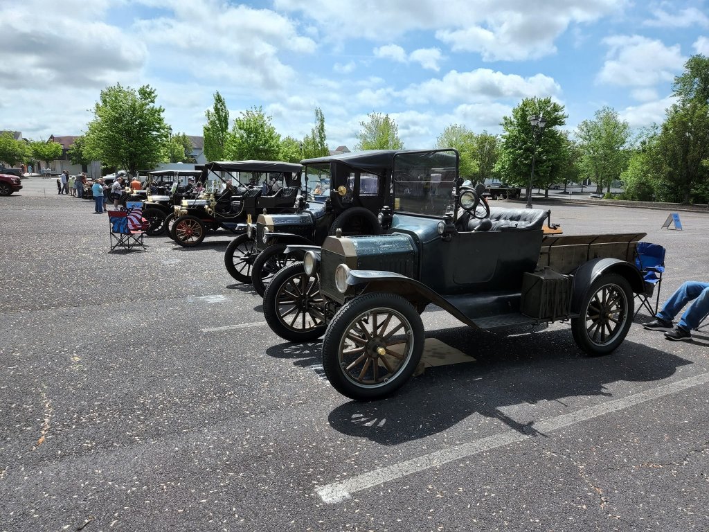

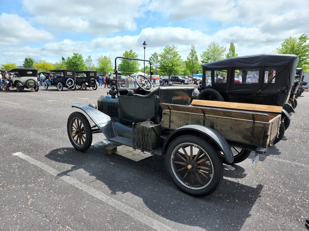

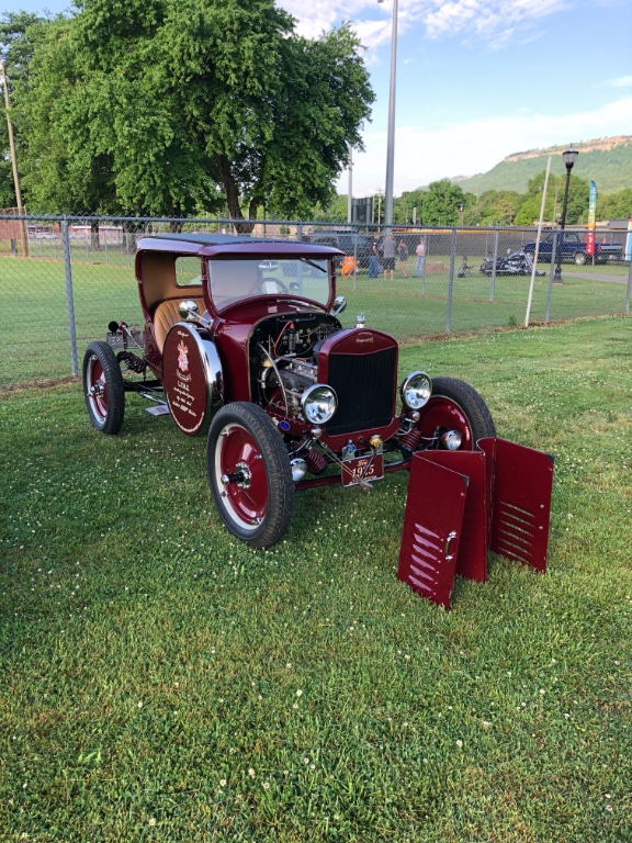

Benefit car show for a young man (37 years old) Fighting an aggressive cancer! This is my first car show..., imagine that. Really!

That is one sweet ride Hank!!!

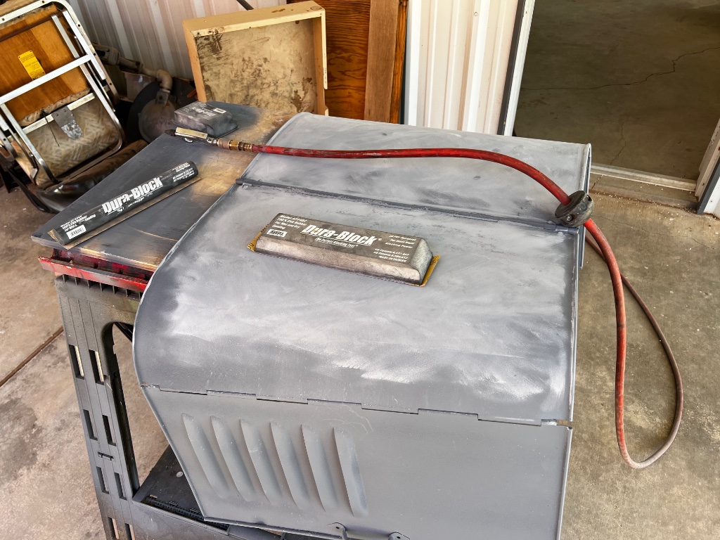

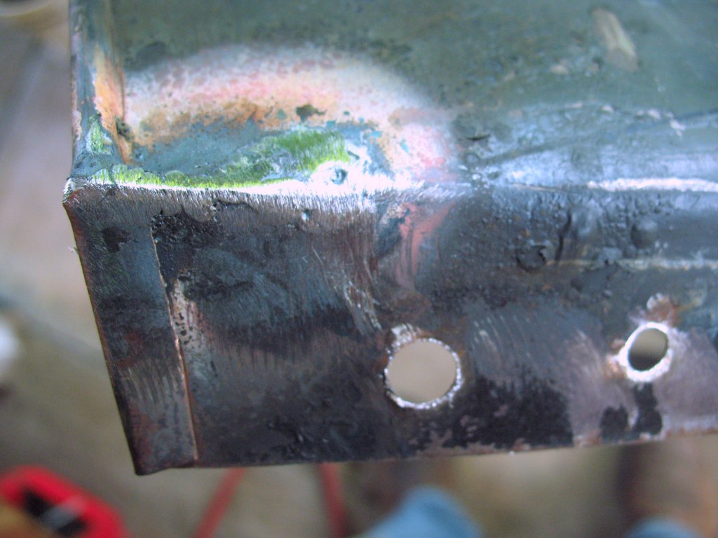

Did more pounding on my fender-straightening job, and welded up a split. My attempt to learn wire welding did not go well, so I used acetylene and a 000 tip. I think I did it well enough to hold together.

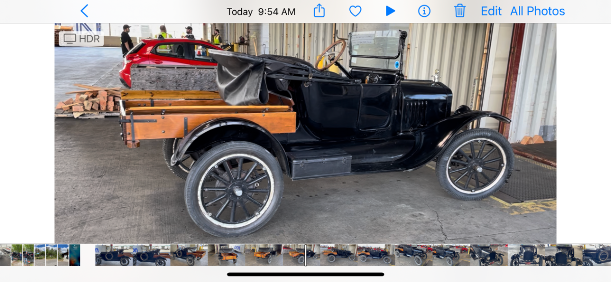

I pulled it out of storage and started it for the first time.
I purchased this ‘26 runabout last year pretty much site unseen as it was several thousand miles away from me in MA while I was wintering in AZ. The owner was unable to get it started although swore he did run it but was afraid to drive it, so he only did so once. Based on the collection of very high Dollar 50’s and 60’s automobiles in a very nice garage I believed him, and figured the T was simply an impulse buy for him and out of his league. We negotiated a lower price due with his inability to start it. I suspected what was wrong with it and offered advice, but it was worth more to him to move it at a lower price and free up a bay than it was to mess around with a T.
I had moved it into storage for the winter and then retrieved it in March and brought it to our new home with workshop that I purchased in upstate New York. I spent the last several months restoring the house which is a Victorian cottage built in 1910. Finally on a nice evening I decided to start the T. I jacked it up and put stands under the rear axle, reset the air fuel mixture, set choke, cranked it over twice, turned on the ignition and it started instantly.
Didn’t even smoke! I’ll get the necessary state issued paperwork for my YOM plates for her this week and have it on the road by the weekend.

For Trent and others…….unless you are afraid of the “correct police” , I went with a Ted Aschman tip years ago, and have never regretted it. I did this way before bifocal age, and agree the original bendix cover screws are a nightmare. Even worse is using the required lock washers. I’d say impossible for me with old eyes AND bifocals. Using a metric cap screw goes well into the odd threaded hole, and the width of the cap screw takes care of the washer need, especially since you can get them tighter than a screwdriver usually allows. Wouldn’t hurt to still use one, but I’d likely use a star washer instead. I had a box of 50 screws but have given them all away over the years, along with a bunch of these metric wrenches I made up out of clock keys. Works for me, and the “police” be damned !

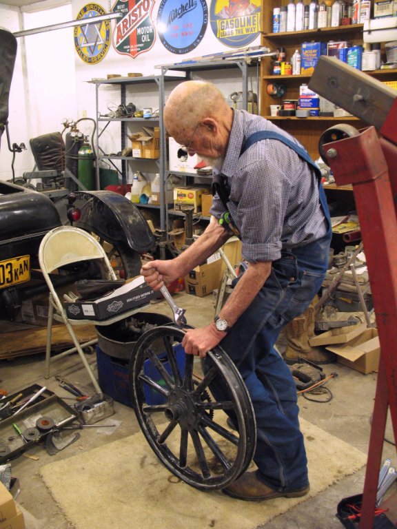

Working on replacing the clincher tires on my 1923. I have one more to go and I plan to tackle it tomorrow. My hands are beat, patience is thin but the goal line is in sight. What an incredibly difficult job. I wonder how they did hundreds of tire mounts each day at the factory......
If you're not already doing them, try these three things:
1 Lay the tire out in the sun to let it get warm and soft.
2 Lubricate the tire with dish soap or baby powder. I use powder.
3 Use long irons. Model T irons make tire changing the job from Hell. I use three HF two-footers.

Took my RPU to the May 15th HCCA BBC Tour/Car show in Gettysburg, PA. Lots of T's and three Model K's there, but I didn't take too many photos.

This past weekend, we got our 1923 Model TT fire truck going! Woopee! We now have a serial number issue however, and found out that the 1923 truck has a high radiator. Now I don't know it it's a '23 or a '24 or '25.

In the process of disassembling and bead blasting a set of original and complete AC brakes. Surprised me how nice they cleaned up. I doubt if I'll even have to to reline them. Purchased a few years ago from Mark at Chaffins. Thanks Mark!

I replaced the cotton bands in my 19 with wood. The NoCo Model T Club helped me out by turning the day into a seminar on the transmission system.
Finally also got some new tires.
Re: What have you done on your Model T in May?
Nice selfie.
I hope they work well for you.
JBog
- Posts: 302
- First Name: Jason
- Last Name: Bogstie
- Location: Cheyenne, WY
Thanks! I'm the second one in the club to use them.

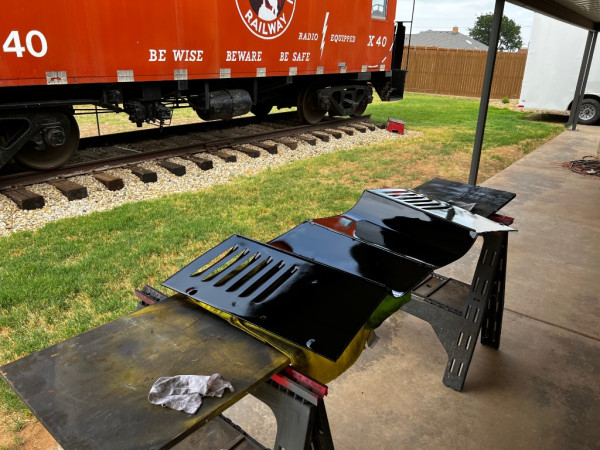

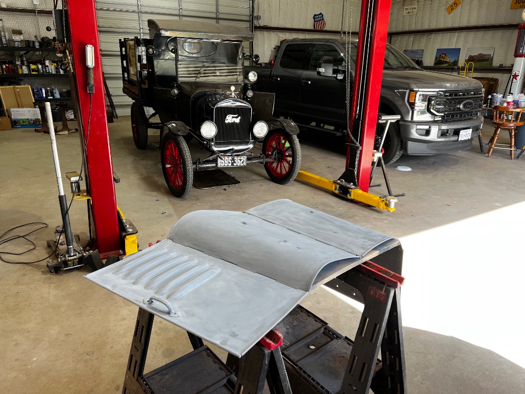

Last project for Clarabelle’s 2022 refresh was to remove a dent I put in the hood by dropping it two years ago. My body and fender/paint skills have improved so the hood looks markedly better than the adjacent fenders. Oh well, projects for another day.

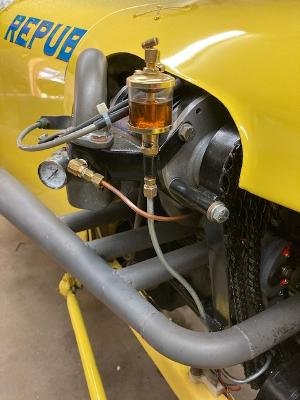

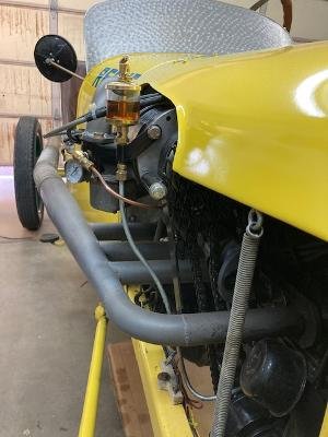

I’m in the process of adding an external oil line. From the condition of the old post, it’s hard to believe this engine was running on the magneto.

Work continues on the Tudor repair as time and ambition permit. This has been a good opportunity to clean and service everything especially parts that came off in removing the engine. It's nice to see the Dulux Black has survived the 20 years it has endured. I'm taking pictures while it is still clean.
I was also pleased to find the fan bushings fitting the shaft so well. A .001 shim produces definite drag. It was still well oiled but cleaning and fresh oil will help it last longer.
I know full well that a fan belt guide is not necessary but they are cute and I like to make them. The previous one had escaped it's mount and was long gone when I tore things down. I made a new one from materials on hand. This time I swaged the parts and then silver soldered them. I was happy to see that the one that failed was an original accessory rather than one of the several I had made. I can afford to made mine a bit heavier.
They tell me that if your fan pulleys are properly crowned the belt will run true and "never" come off. If that is true then this guide won't wear the belt much.

Installed new band springs in the transmission of my '25 coupe with assistance from my son. Been putting this task off for about a year (yes, way too long). Now to start driving in earnest. And we avoided dropping ANYTHING into the black hole.
Drove it! And not worry about the small stuff..

got the new wood spokes stained to give that old look and show off the grain.

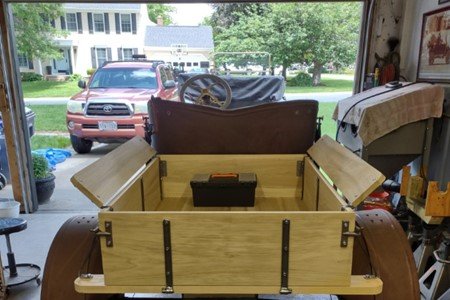

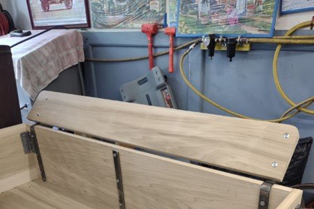

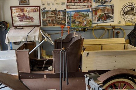

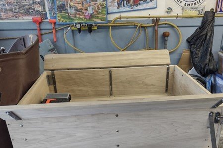

Just picked up the buckboard I had made by the Lancaster area Amish wagon builder ($500). I am converting a 1912 roadster torpedo
to a pick up. It is challenging and fun to creatively put a 1914 gas tank under the seat, drill holes for the battery box, 1927 engine from Ed Henline,
selling the 1912 rear to replace with a ruckstell, disc breaks were put on last fall, demountable,.............
I bought the car as a project car which came with many parts. I sold many parts at Luray and made just about enough to buy a Ruckstell.
I don't want my estate to sell my parts. I am selling my parts now to make money and to put back into the T!

I set the rebuilt engine back into my 26 roadster today.

I took a nice ride yesterday evening in the '27 Touring after finishing up rewiring some new lights in the shop and painting an awning for above the entrance door.
Still waiting on the machine shop to call and tell me the '22 Coupe block has been bored out and to come and get it. I'm hoping to have it back up and running by July 18th it's 100th birthday.
John Codman
- Posts: 1532
- Last Name: Codman
- Location: Naples, FL 34120
Rickd, I have seen engines with cylinder bores far worse then yours brought back.

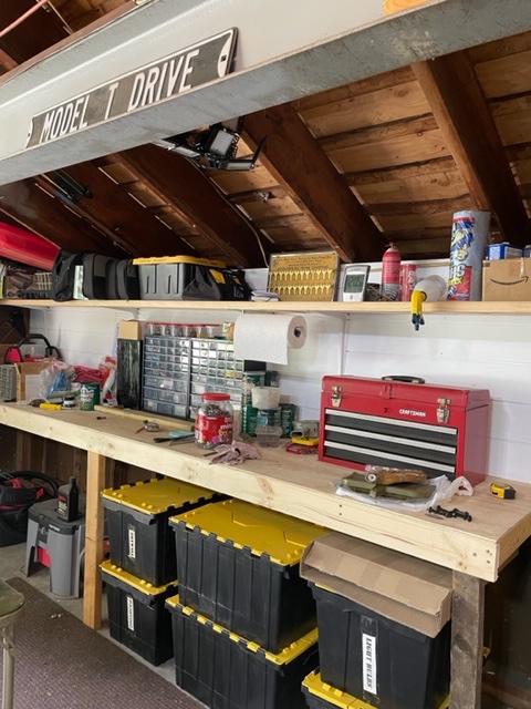

With the 15 stewardship changing to my youngest son…and the 25 likewise to my oldest son….what do you do to a two deep garage bay if you’re not planning on something new?
Build a new workbench…lol. And organize the house garage for the first time since the 80’s!! (Still a work in process, this is the left side…)

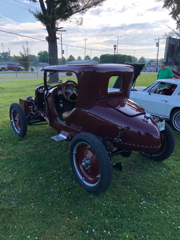

- Posts: 4090
Took Nellie to a local street rod show, and lots of folks enjoyed seeing an old Ford. There was just one other '23 Ford there, a fiberglas roadster with 350 chev motor!
Anyway got the trophy, there were 51 cars in attendance, and trophy given to the Top 25....woo hoo!

Congrats on the trophy. I like your vintage fender brace.

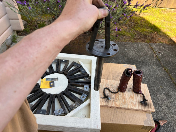

I continued my months long quest to rebuild/assemble my August 1920 motor. I rebuilt a mag coil ring I bought off of eBay, recharged my magnets using a single 12 volt battery (they can lift a transmission gear shaft which weighs 2lb 9 oz according to my wife’s food scale), and started setting the gap between the two pieces. It took me a few hours to find the brass shims that I put away someplace safe.

Just finished a long challenge from a friend. He challenged me to figure out how to install a Judson supercharger on a model T. The Judson rotary vane style has been used for lots of purposes for close to a hundred years. Judson Engineering & Electrical Co. was founded in 1880. This one was designed
for a 36 & 40HP VW in the fifties. The challenge is to turn a Acc. at 4800 RPM max speed from a model T engine. The VW is 80 cu.in. but will turn 3800 RPM and the Judson was over driven 1 : 1.3. Produced 6 lbs. boost at best so even @ that speed will produce less than half the volume needed to produce that in a model T. So over driving the Judson by 2 1/2 times crank speed produces 2+ PSI. End result is only a hand full of horse power
( somewhat like installing a high compression head ) noticeable but not overly impressive. As the new vanes break in it may improve some. The best results should be at higher elevations where model T's seem to suffer the most from thin air. Biggest problem was making it look period correct.

Went to the Memorial Day parade today. I offered to take a veteran or a firefighter. Lady in charge could not come up with anyone, so I asked the first couple I saw on the parade route. No they wanted to watch the parade. Second couple - no. Young man with 3 kids grabbing candy. Sure. They had a blast and dad was thrilled.
Then I stopped by the new neighbor and offered a ride. Convinced him to go. An hour later his whole family was there, so I took about 12 relatives for a ride. Then I stayed a bit and got a tour of the house, and met everyone else.
Then I went to my buddy's house across the street. Had a couple of beers and talked about his family.
Next I went home and finished taking apart a couple of axles I got at an auction. The grease was thicker than molasses in one axle. This axle had 1 good bearing. Differential is questionable.
Second axle had 4 good bearings. Differential is soaking in kerosene. Now it is time to go make dinner.
I would say it was a good day.

I just drove 1,100 miles to get my new 22 runabout pickup (whose name is “Burt”) and dropped it off at the freight company to ship to Alaska. The picture is a snap of a video I took just before they rolled him into the container.
He has not been driven in a few years so there is some tinkering to do, but once it gets to Anchorage in a week or so the fun will start. Bert is joining my speedster project “Thelma” in the garage.
I have been working hard on Thelma to get a rolling chassis. The Rajo BB head for her is still being rebuilt. I got a new old stock 26-27 front axle and am finishing up the front lowering brackets. I also got a bunch of model a steering parts that will be modified to mimic some of the steering equipment available in the 20s for speedsters and race cars.
As an archaeologist, my summers are crazy busy so progress is going to slow down for the next 4-5 months.
