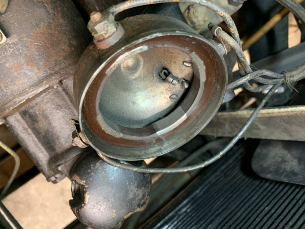

I did a little exploring this morning on my ‘26. I think, based on what I hear on here, that this is bad. True? Replace the roller, too? Could this be causing the misfire? I’ll probably just go back to stock at this time.

Re: Bad Commutator?
Well, that didn’t work….

Re: Bad Commutator?
It won’t let me post another picture, but the inside of the case has big dips and ridges. It’s not a smooth perfect circle inside.

Re: Bad Commutator?
I'd replace ALL of it.

Re: Bad Commutator?
Looks like the standard Ford style roller brush on the camshaft using the usual commutator case

Re: Bad Commutator?
Wash board road. timer skips firing @ higher RPMs.
Fit the symptoms?? Change the timer & get those coils tuned & you should be @ least 80%.

Re: Bad Commutator?
The roller timers are supposed to be cleaned out and oiled occasionally. That certainly looks dry in the picture.

Re: Bad Commutator?
Snyder’s has the same style roller style timer you have. Well made timer https://www.snydersantiqueauto.com/prod ... &cat=41853

Re: Bad Commutator?
I posted earlier that you do not show the thin steel disc that goes on before the roller is fitted to the camshaft. This is part of the felt seal deal, keeping the seal in place and giving it something to seal against. The rest is standard roller timer stuff, and sounds well worn out by your description.

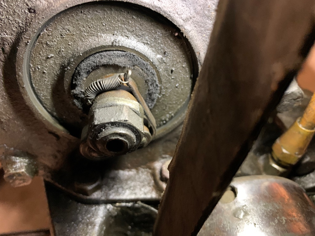

Re: Bad Commutator?
While you're tinkering in this area you might want to replace the felt cam seal with a modern neoprene one. Then a dust shield isn't required. FWIW, I have a New Day from Tip Top Timers that works great. 5000+ miles and still going strong.

Re: Bad Commutator?
Is that hard or take special tools?

Re: Bad Commutator?
Nope - pretty easy as I recall, just presses in.

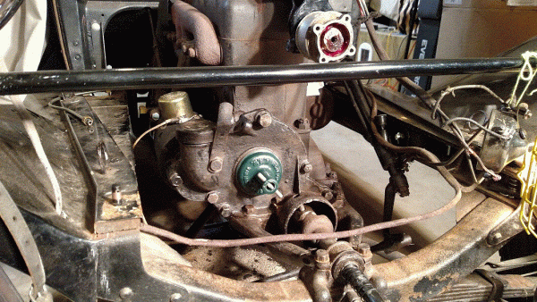

Re: Bad Commutator?
I am finally able to post a picture of the interior of the timer. For some reason my phone wouldn't let me post 2 pictures this weekend.

Re: Bad Commutator?
That looks like a Tiger Timer since the insulating material is maroon. Yours is definitely worn with dips in it. I don't know if it would be cost effective to have the roller surface turned back to round. Replacing may be your best option. I have a Tiger Timer that has a perfectly round surface and have never had a miss with it.

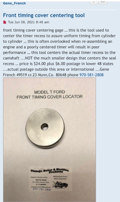

Re: Bad Commutator?
Scott, could be off center, Gene French makes and sells a timer cover alignment tool for a very reasonable price. Handy to have even if you don’t need it now. Right now though you have a ton of questions in multiple areas. At the same time you have a bunch of folks trying to help you with those issues based on their experiences. This exhibits the quality of folks here by their efforts to get you up and going with the best possible outcome. I would strongly encourage you to act on one thing at a time. Handle that issue until resolved, then move to the next issue following the same process. What could happen if you try to tackle multiple issues not knowing if the one issue is causing collateral issues. I do know at least one thing for sure, based on experience, if you don’t have a process and check list of things to do and solve one at a time, you will have a yard sale going on in your garage, get overwhelmed and walk away in frustration. The good folks here want you to succeed but you’ve got a bunch of things that you’re already working on, planning, trying to solve and you’re adding more. The commutator is one of those things that you need to take your time with. A process is needed here. Given the fact you’re thirsting for knowledge, with no help close by puts you in charge of the outcome. An example of disassembling the timer, brush, oil seal & control rod is getting it back together! That is if you remember what you did. Not knowing the engine, you may have a style camshaft with the pin hole that is straight through. You take the brush off and haven’t marked the side where the pin went in, you could be 180 out, causing your to redo work already done. Attaching wires to the new commutator requires you to get them in order and attached so they don’t ground to the plate when clamped ont the timing cover just to mention a few things that could go wrong. Scott it’s not a sprint, it’s a marathon. Take your time, establish a process and succeed. We’re rooting for you.

Re: Bad Commutator?
Do not use the "small" centering tool as shown above - you want the "large" one as John mentioned above as it actually does center the timer case to the timing cover !

Re: Bad Commutator?
I just ordered it so we'll see how I like it. Thanks! I also ordered just enough parts to put that part of the T back in good specs. That's it.....except a fan belt as mine is in two layers now.John kuehn wrote: ↑Mon May 16, 2022 1:47 pmCatguy
A roller style timer like you have is available at Snyder’s antique parts.com. They have them in stock for 69.95.
Tiger was a brand that was a copy of the original Ford style timer. Other less known companies made copies of roller timers also back in the T era. Tiger was a better known brand.
The one that Snyder’s sells is a well made American copy of the original Ford timer. Here is link to Snyder’s.
https://www.snydersantiqueauto.com/sear ... rcht=Timer

Here's how the timer wires go. If your wire colors don't match this (some repo wiring is colored wrong), just follow the procedure John outlined.
The KRW cover alignment tool shown in Mark Nunn's picture apparently is no longer sold. It's not on Lang's website, and it's in none of the other dealers' catalogues. If you can't borrow one it looks like the only choices are the one Tim posted or nothing
- Posts: 1967
- Last Name: Tannehill
- Location: Hot Coffee, MS
- Board Member Since: 2002
Re: Bad Commutator?
Per my previous post on this thread concerning a centering tool made by Gene French. Quality work at a great price.
https://mtfca.com/phpBB3/viewtopic.php? ... 26#p218526

Now Cat what’s s better? Spending $ Willy nilly like it was suggested to you or taking the time to learn about the cars systems and what commonly goes wrong? Sure you’ve got to spend some but at least you’re on the right track. You actually diagnosed and found a problem. The information in this post is invaluable. The knowledge is priceless.
- Posts: 6804
Re: Bad Commutator?
Actually, replacing the shot timer was one of 3 items I suggested to do based on much experience. I never said he HAD to replace it, but suggested it out of expediency and statistical probability based on the history of the car and the symptoms it presented. I doubt that many knowledgeable people on the forum would have wanted to start a tour or cross-country drive with that timer.
So far I'm 100% spot on for the first 1 of 3 items I suggested (against an absolute myriad of possibilities), so if that is willy-nilly, that must be a new phrase for "I was correct". If all 4 coils are new and flawlessly balanced to each other, and the carb is brand new, I'll be wrong on the remainder (except I've seen pix of the coils and I've seen the carb, so am not too worried about them being like new). A coil that usually fires is still a coil that is faulty as it should pretty much always fire (and be balanced either in current or TTF with the other 3), and an NH carb that has not been rebushed and rebuilt in the last 3000-4000 miles is likely worn out with a wobbly throttle shaft. I'm betting that this is the case with this car.
Time will tell, and it will take plenty of time, relative to the 2 days work my advice would have provided. If the journey is important, or the destination is important, there are two different paths to take. I was focused on the destination.

I agree that the timing gear cover shown by Mark Nun is the best one, and recommend that you check for centering. However don't remove the cover unless it is off center. And I warn you that some T's have been fitted with a neoprene seal at the front of the crankshaft where the timing cover is located. If so, you can't get the seal off without separating the crankcase from the block because you can't lift the cover off because the seal goes all the way around. So if you try to remove the cover, you could damage the gasket which should be replaced anyway if the cover is removed, but you might need to remove the engine to get the cover over the crankshaft. The centering won't be quite as noticeable with a New Day timer than with the roller or Anderson flapper timer, however it could alter the timing slightly between cylinders.

Good morning... Removing the timing gear cover is no problem at all, .... Installation of the cover is crucial and it helps with accurate engine ignition timing. A camshaft centering tool is necessary before tightening the bolts.
- Posts: 6804
Re: Bad Commutator?
A slightly off-center timing cover will give different inter-cylinder timing of spark. If the engine has a RAJO head, performance will suffer. With 40PSI compression, performance will suffer in theory but will be well hidden by the overall condition of the motor. The last thing you want to do is pull the cover now, before the engine is running WELL. I would not be inclined to throw another variable/distraction into the mix right now. A face-contact timer like a New Day removes nearly all error of an off-center timer, as will an e-Timer (?) (Mike Kossar can clear that up). These things can become Rabbit Holes for the Curious, so I would focus on a known problem that is directly related to misfiring and work those issues first and foremost.
Once the engine is running smoothly, then I would tackle the cover issue...if it is even an issue at all...it could well be perfectly centered if the engine was last torn down in the era when repairmen knew of such things. If it was removed/replaced in the '50's or later, by a hobbiest, it's probably off-center.

As others have pointed out, your timer appears to be dry as a bone which has resulted in premature wear to the roller and contacts ring. Timers need to be lubricated fairly often with oil or thin grease to prevent this wear.
In the 52 years I have owned my 1926 Model T coupe, I have tried virtually every type of timer on the market and have recently come back to the original roller type timer which I prefer above all others. I mixed a very thin concoction of grease using a can of 3 in One oil and Vaseline which I spread on the contact ring and roller and my T has never run better. With my mixture, I don’t believe I will need to oil as often but that remains to be seen. Either way it provides a great lubrication without affecting the electrical current passing between the contacts and roller and also prevents wear to the roller and contacts ring. One must be very careful as to which lubricants to use, for some contain ingredients that are electrically conductive, which could bridge the gaps between the contacts causing all of the contacts to fire off together and cause havoc to your electrical system. Vaseline and 3 in One oil are not conductive.
I suggest you get a new roller type timer and keep it lubricated with a simple, not conductive lubricant. I’m sure it will run much better. Jim Patrick
