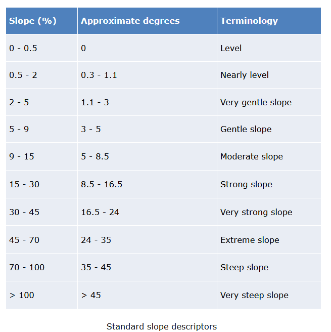

Post by TRDxB2 » Sun Jun 05, 2022 12:51 pm
"It cost as much to keep a gas tank half full as half empty" until you run out of gas :lol:
To calculate the approximate angle use this calculation tan (X) = opposite side/ adjacent side and then convert that value to degrees
The angle X is the slope of the hill and that depends on the height of the fuel (opposite side) in the tank because that can vary and the distance from the carb to the sediment bulb (adjacent side) is fixed
Foe example
the RED line represents when the carburetor is higher than the fuel in the tank
the GREEN line is the distance from the carburetor to the sediment bulb
So these numbers are just to show the example
The fuel height = 6 inches and the distance between the carb & sediment bulb = 48 inches
So 6/48 = .125 which is the Tangent of the angle x.
To convert that is easiest to use the internet calculator https://www.rapidtables.com/calc/math/A ... lator.html
TrentB
