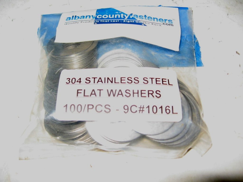

You probably don't want to build your wheels with spacers, but you should be able to. You can't really see them once the wheel is built.
Albany County Fasteners C916L 1/32 thick 5/8 ID 1 OD stainless steel
https://www.albanycountyfasteners.com/1 ... shers.html

That is a brilliant idea! Thank you!cslandry wrote: ↑Thu Jun 09, 2022 3:20 pmYou probably don't want to build your wheels with spacers, but you should be able to. You can't really see them once the wheel is built.

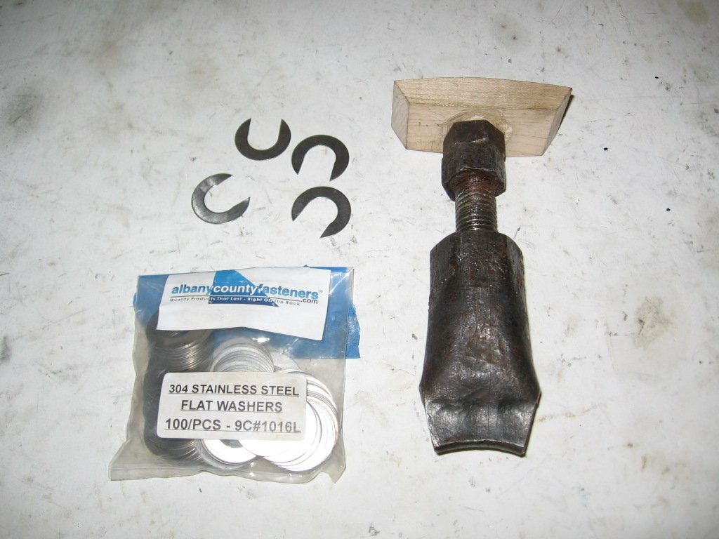

Regarding washers, here are the ones that I cut a slot in to use as shims on already built wheels. They are 1/32 inch thick stainless steel. The ID is 1/2 inch and the OD matches the OD of the end of the spoke. If building a wheel with them, they could be put on the end of a spoke without having to cut a slot.
Update - I measured one and the washer ID is actually 5/8 inch, which is a good thing because it allows room for the fillet at the base of the spoke tenon.

Mark, have you had any of your slotted washers come out? How are they fitted? Being thin, I can't see them being driven in. Have you a spoke wedge to help with their installation.

Allan, I typed up a long reply to your question, but it got lost somehow, so I'll try again.
I first installed shims on some of my spokes in 2013 as a temporary fix. So far, temporary has been nine years and counting.
None of the shims have moved since I first installed them. I used a spoke jack to push the metal felloe away from the end of the already-loose spoke, then slipped in the shim. I used a small punch and hammer to drive the shim home, then loosened and removed the spoke jack, leaving the shim jammed in tight.
I marked the felloe with a small white dot at the location of each shim so that I could keep an eye on them. So far, so good.
A full rebuild with new spokes is always the preferred, permanent solution. I'm just sharing my experience as requested.

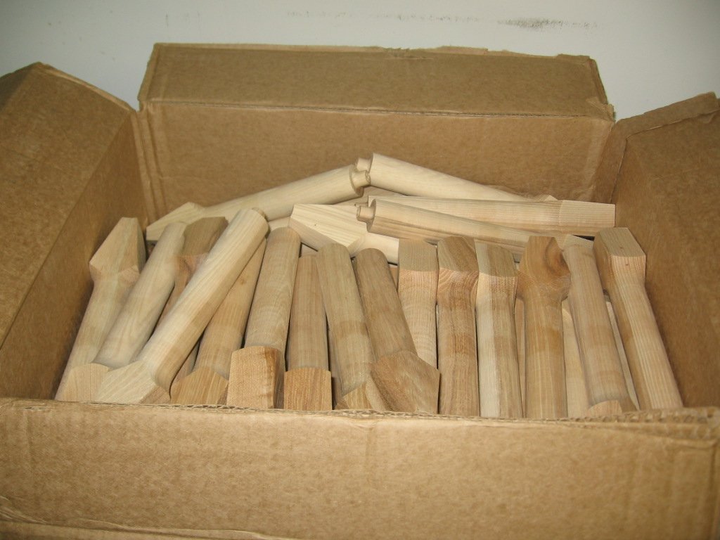

I have a box of new Hayes spokes, all sealed and stained, along with a Regan wheel press ready to go to rebuild my wheels if my temporary shimmed spokes ever loosen up again.
- Posts: 7292
Re: Wood Spokes (Hayes vs. Ford)
Mark, the spoke jack is the key. That way they will be tight, without the need for driving in. It is amazing how temporary some fixes can be.
