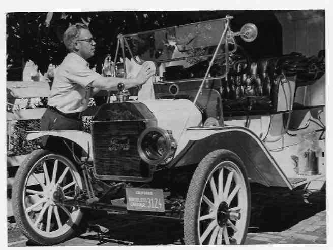

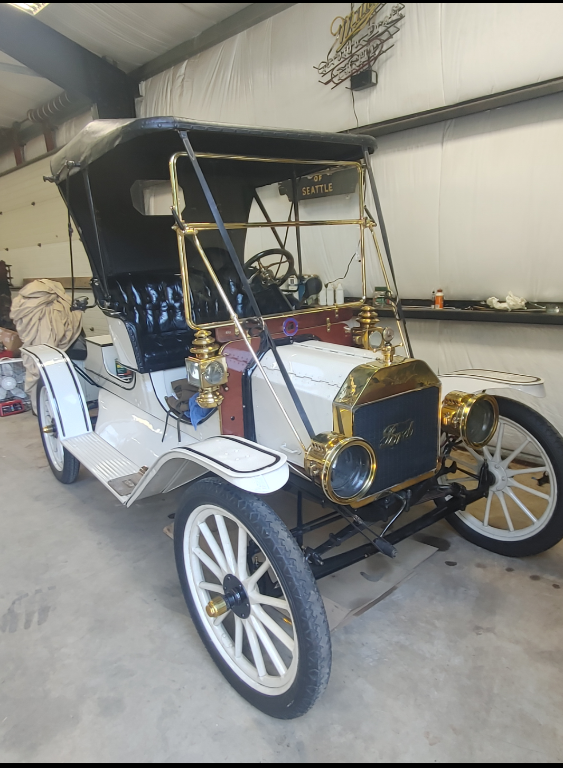

Got her firewall adjusted. I realize the brackets that connect the winahield to the board it rests on are incorrect for 1909, but I am putting her back to her 1960's trophy winning era. Black and white picture is of same care, firewall and windshield. Current paint and condition is from the 1960's. In 1964, Ray Head a fire captain in Chico, California found the 1909 Model T with mother in law seat in Frank W. Boyle's house garage due to a fire. Ray acquired to T from Frank who has purchased the T in 1920 to use with his new wife on their honeymoon. His new wife couldn't resist the cute looking T.
Ray took from 1964 to late 1966 to complete a full restoration which is the current condition of the car. Ray and his wife showed the Model T named Esmeralda (by Ray's wife) all over California and Nevada from 1966 to 1970. Newspaper articles claim that Esmeralda won 17 first place trophies during that time period. My good friend Dave met Ray and his wife on 1968 or 1969 at a show and left his number with Ray and his wife on hopes they might sell Esmeralda. Sadly on Feb 2nd 1970 Ray was injured in a commercial building fire in downtown Chico. He was transported to the hospital and passed away mid Feb 1970. Soon after Ray's widow contacted my friend Dave and sold Esmeralda to him.
I first met Esmeralda when I was around three years old. I was in love with riding in the mother in law seat. Esmeralda was owned and showed by Dave and his family from 1970 to 2021 when my family was able to continue caregiving for her. Thanks to Dave and Elaine for letting me enjoy her=)
