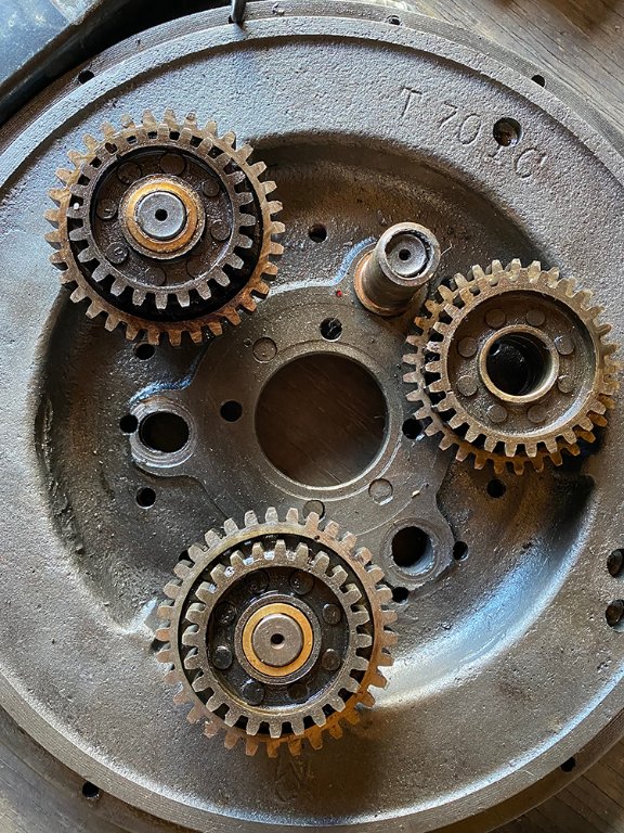

Triple gear bushings too tight on the pins as fitted during rebuild
- Posts: 5560
- Last Name: Hatch
- Location: Alabama
Re: Bye-bye flywheel
This may have been the second set of pins for this flywheel. Holes too big for replacement pins. Have seen it before. Dan
- Posts: 7310
One triple gear bush was obviously too tight a fit and seized on the pin. That may also have been the case on the flogged out one too. If the pins had been replaced at the same time as the bushes, the holes in the flywheel may also have been compromised.

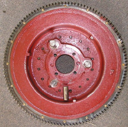

That happened to me about 20 years ago.
There were complaints at that time about a different combination of te bushing materials that made them swell when hot and not shrink again when cold.
This one just tore into.

If you use the pins from most vendors and don’t polish them the bushings will lock up. The finish is not smooth enough. Look up an old post from Herm. He showed this years ago.
Also check the size of pin in flywheel. As I said, if it already has had pins replaced the new pins will not stay tight in flywheel. Seen it before.
And ball sizing the bushings instead of reaming will make bushings not slip in gear.

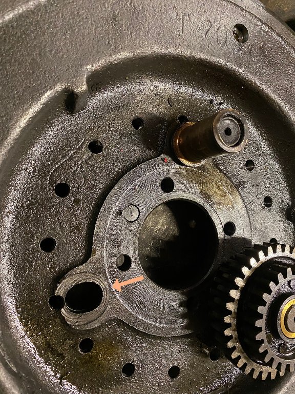

Thanks to all of you who have shared your experiences and observations. I finally found time to drag the damaged triple gears out of the box and look them over more closely. It is obvious that the bushings locked upon the pins. It appears that the gears were spinning on the bushings (and eventually spinning at least two of the pins). I have to wonder just how long this was going on before it failed? All seemed to be fine until I tried to back up a little incline and something let loose.
I never suspected such a thing was a problem with Model T's but from the other postings I see that it is more common than I would have thought. My confidence in the car has dropped a few notches and I suspect I'll be listening very carefully to any new noises the car makes.
I've attached a better photo of the flywheel and the triple gears. Two of the pins spun out, one of the gears game off the bushing which is locked to the pin.

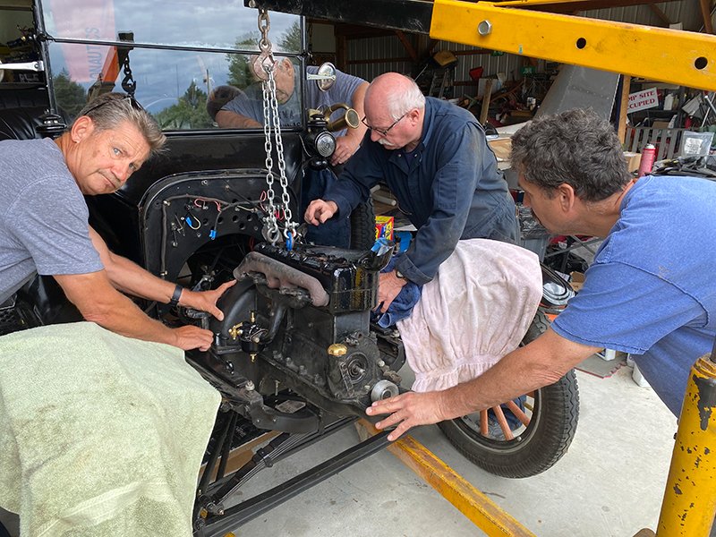

Carole King's song "You've got a Friend" applies to the times in the Model T world when you can use some help. A little over two weeks ago the flywheel under discussion above finally gave up the ghost, setting into motion an extraordinary series of events, all aimed at helping me get back on the road. I am truly humbled to have friends who are there when I need them, and wish to acknowledge them here
The list is pretty long but Charlie Volkening and Tom Graham rebuilt my transmission and checked over my engine in record time. Don Booth served as a way-station in getting my engine to the North Country to be rebuilt. Dave Nolting who trusted someone he'd never met enough to ship out a set of new drums before he received my check so that I wouldn't be held back waiting for them. Denny Newman shared his knowledge and advice on a couple of issues that could have developed into additional troubles. Gene Butler has been there for every step of the process as has Brian Dowell who provided much of the tools, expertise and energy to get the job done. Tony Osentoski, Ron Stratton and Wayne Lepola did not hesitate to get greasy and lend a hand where needed.
The result? The engine is back in the car and I am in the process of hooking things back up and getting ready for a road test and further adjustment. Thanks to all who helped, I hope I can be as good a friend to you......
