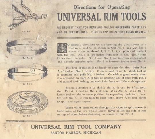

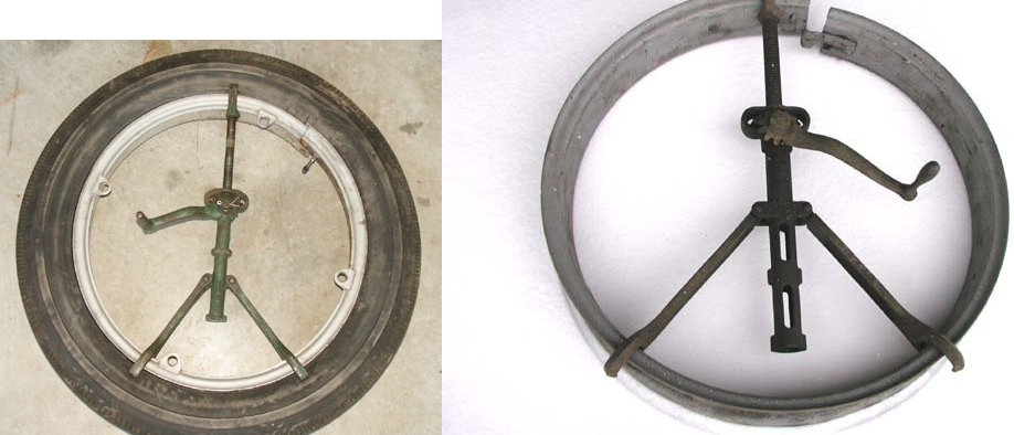

Solution. Figure out how to do it yourself or find a competent, experienced guy. You need a rim spreader tool. See recent past discussions.

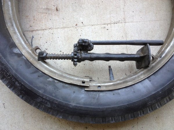

It MIGHT be possible to use a jack inside the rim if the rim is only out of round & not twisted. Depends on how badly bent up they are.

I will loan you my split rim spreader if you pay shipping. PM me with your address.

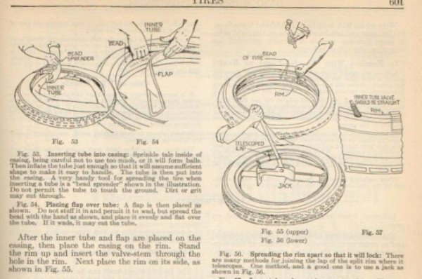

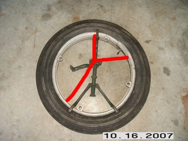

Instructions
By Dave Roberts October 16, 2007
Then, when mounting a new/repaired tire, turn the spreader assembly 180 degrees so
the 2 swing arms are at the 2:00 and 10:00 aspect and the 'bird beak' arm at 6:00. When you
crank the handle, the 2 ends of the split rim should easily glide over each other and lock.
