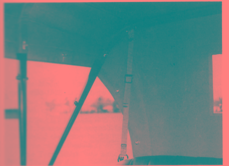

Anyone here have a description AND a very good and clear picture what the rear curtain or rear top straps look like and how they attach to the body and to the rear bow on a true 1919 touring. Also what material these straps are made of, the width and thickness and also their length.

The photo above is from page 285 of Model T Ford (McCalley), and there is also a nice photo of an original set of straps on page 276. They should be black, woven cotton webbing, and I believe they are 1" in width and I have the same question as to their length.

Note, original rear straps are just long enough to pass through the buckles. The strap in shown in Joseph's post is too long and a waste of webbing.
