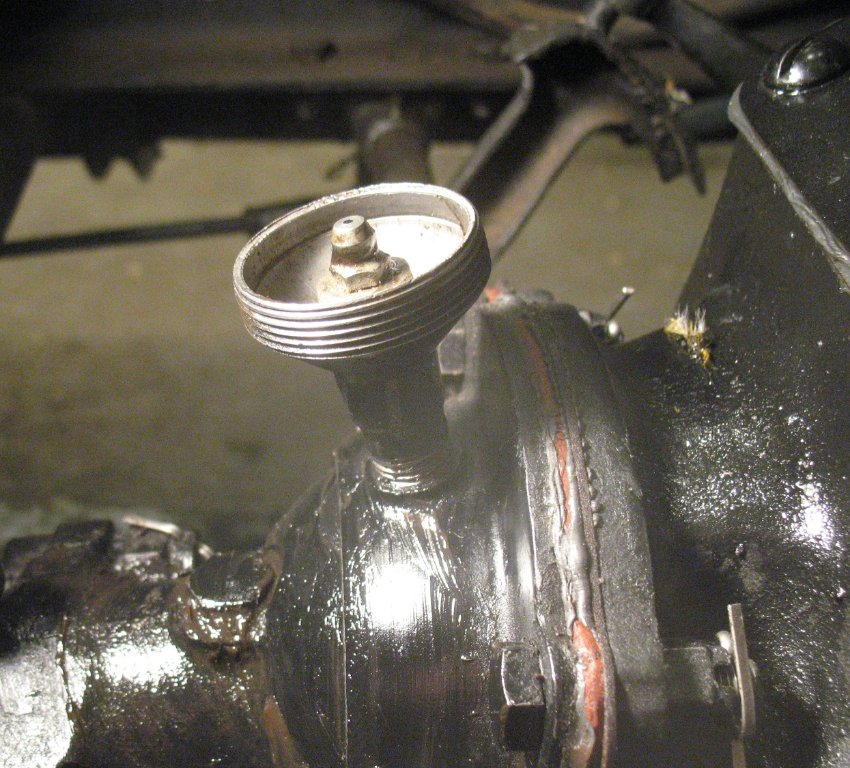

Post by Steve Jelf » Fri Jul 08, 2022 11:51 pm
I put one in my U-joint grease cup. Larry pointed out that it's not original, but Arthur Itis overruled him. :)

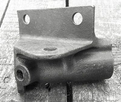

Then there are these if you choose to replace press-in oilers with zerks

Post by Professor Fate » Sat Jul 09, 2022 2:22 am
Steve, 8 years ago I tried one of those in that exact spot. I found that I couldn't get the threads to start. So I never put it in. The old one got reinstalled. Too much "donkey" pain to be bothered at the time. Convenience became a project....
