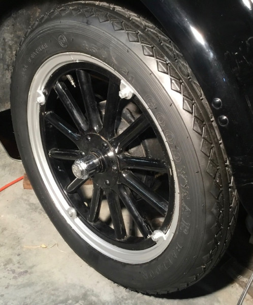

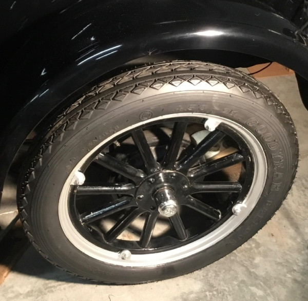

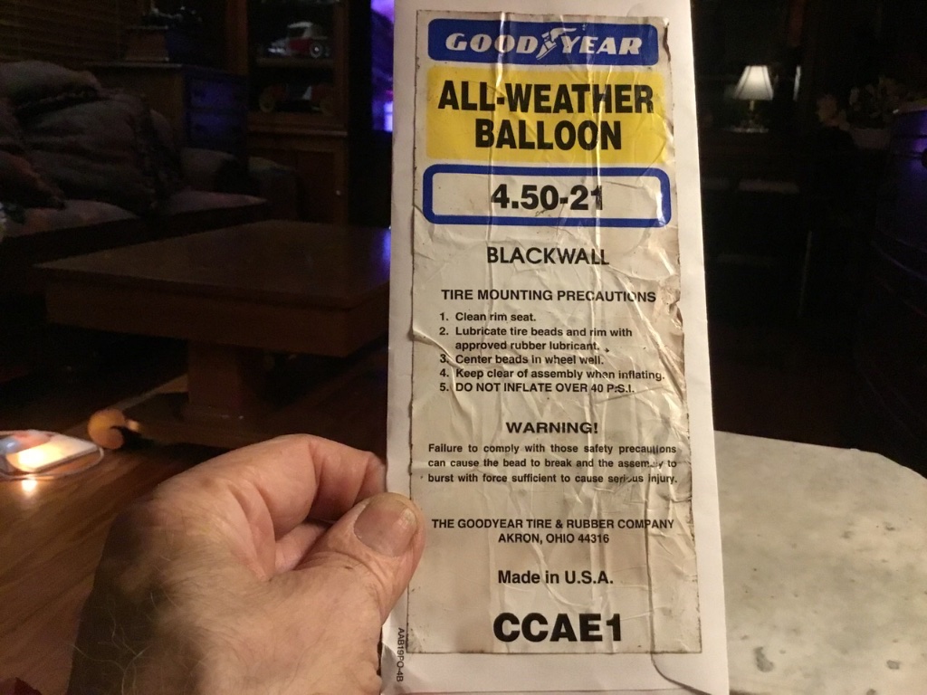

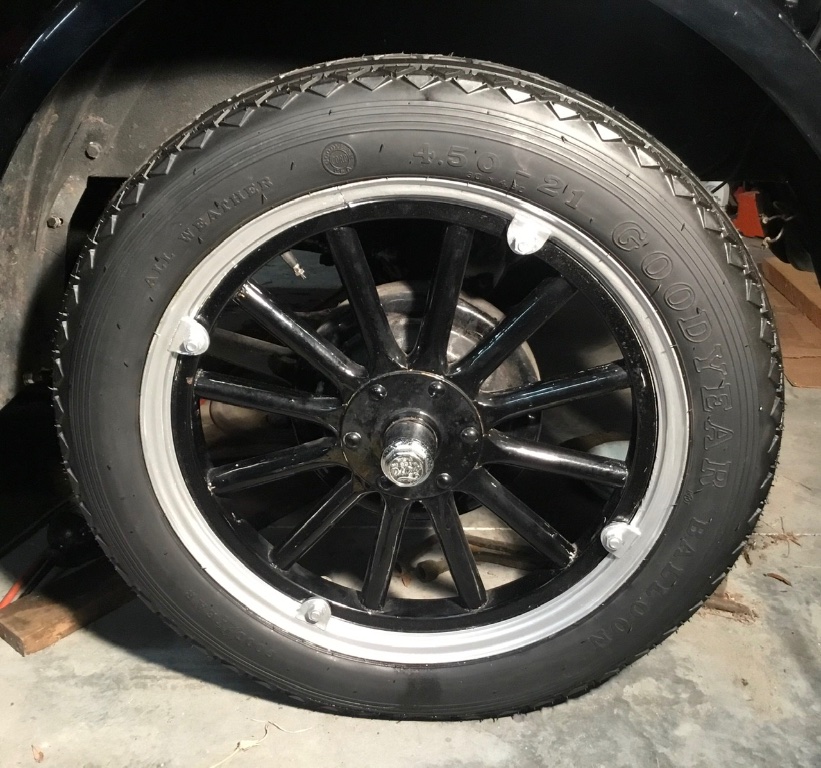

Here is the label affixed to one of my new Goodyear tires I recently installed. It says not to inflate over 40 psi, so I inflated all 5 of mine to 34 psi so the tires would be soft enough to allow the tires to take up some of the shock and relieve the springs of the shock experienced on rough roads. Jim Patrick
