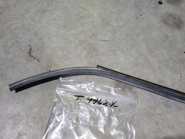

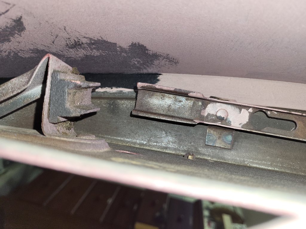

1) Is there a set distance between the top and bottom clips or do I have to measure to verify the distance between the anchor points (which looks like it would be difficult to get a good measurement)?
2) The first photo shows the top and bottom clips and a new clip. The bottom clip is on the long piece of channel. The new clip is too wide for the bottom anchor point, so I will have to drill out the rivets and reuse the bottom clip. How do I reattach it? Do I have to find some kind of rivet or can I use small bolts?

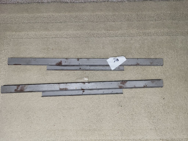

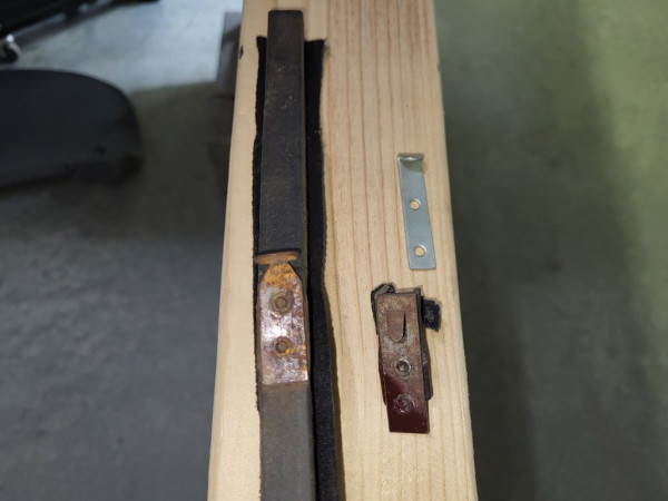

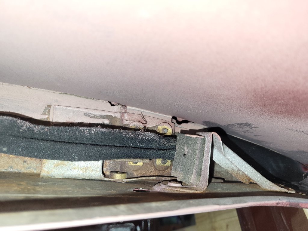

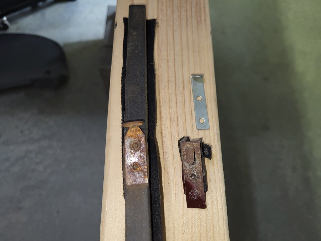

4) The second photo shows the rubber cushion being inserted into the metal channel that is attached to the top of the door by three screws. Should adhesive be used on the rubber cushion? The cushion seems to be held firmly in place by the three screws and its "shaped" bottom as shown in the third photo.

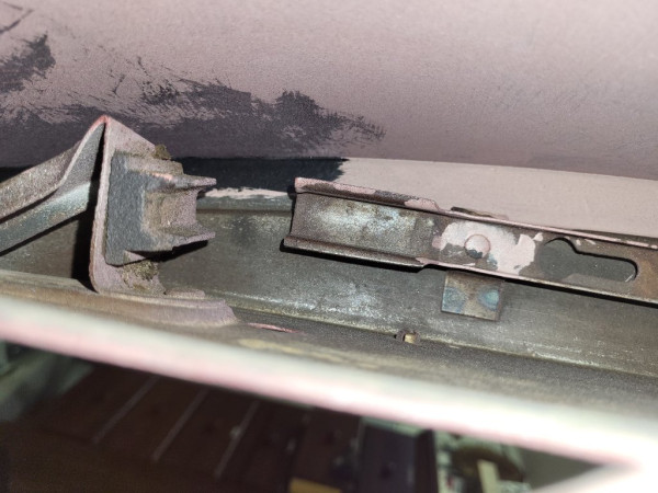

5) Is the rubber stopper shown in the fourth photo in the correct position or should it be rotated 90 degrees to the position in the fifth photo? I have new stoppers, but I am thinking reusing the existing ones because it looks like it would be difficult removing and replacing them. What do you think?

Regarding my first question, I now believe it will be fairly ease to determine the length between the anchor points.
Regarding my second question, I have drilled out the rivets on the top and bottom anchor clips and will use small bolts to reattach them.

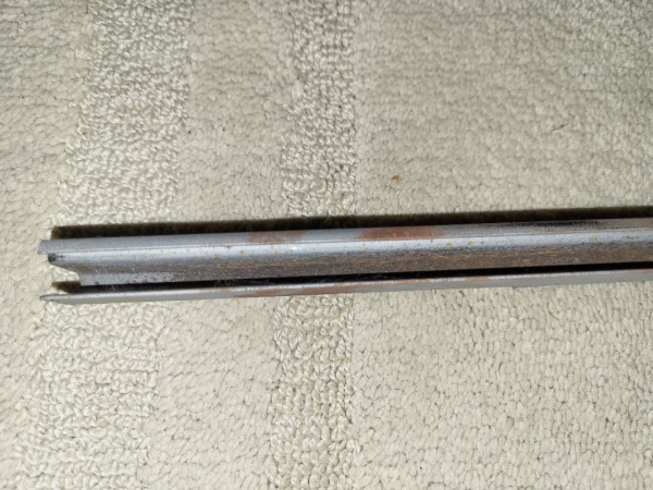

The attached photos show my metal channels into which the glass will be is set. Should I paint the inside or would the bare metal provide better adhesion for the setting tape?

I used small pop rivets with washers on the reverse side. Unlike screws and nuts, rivets will not vibrate loose. I sanded, primed and painted my channels so they would not rust. Jim Patrick
