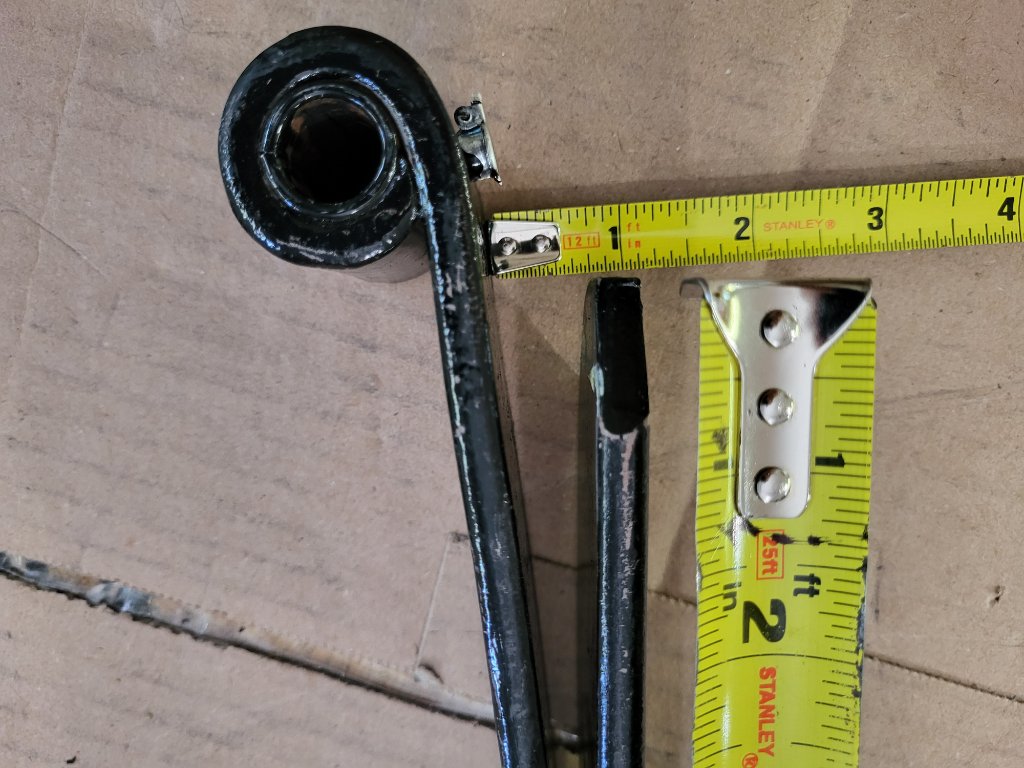

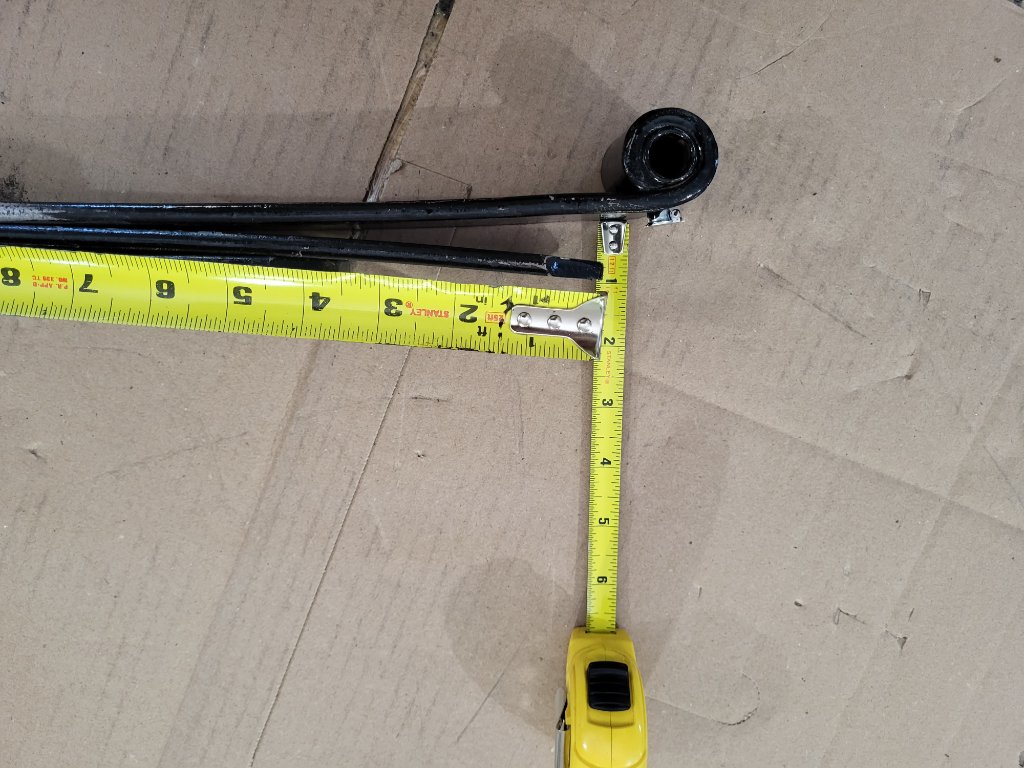

I have noticed an odd situation with rear spring for my 1927 coupe. The end of second leaf on the right side is not in contact with the bottom leaf. The attached photo show the situation.
While not shown in the photos, there is a slight wear pattern on top of the bottom spring below the end of the second leaf.
Is this problem??
Is this problem??

That may have resulted many years ago when your T hit a bad pothole. It looks like the second leaf is bent up a little. I would put a 2”x 4” block crossways under the point where the bend starts and, using your entire weight, with one foot on one side of the 2x4 and the other foot on the tip of the leaf, apply a controlled downward pressure to the tip until the bend is out and the leaf fits the bottom leaf properly. If you have trouble doing it by yourself, have a helper use his weight on the leaf inside the block while you apply downward pressure to the leaf tip. Do not apply heat. Do this cold. Jim Patrick

Those are plenty tired, and one is bent as noted by Jim
They should not "nest" in their free state, rather the ends of each subsequent leaf should rest on the top of the preceding leaf and take quite a significant draw-up pressure via all-thread rod to get them to stack properly and insert the center bolt.

Scott is right. Those leafs are tired and should not fit so close before securing. My front springs were weak that way so I put a block at the tips of each leaf with the curve facing down and, one at a time, I stepped up on center of the leaf and with my weight, gradually put more curve in each leaf. After doing each leaf, I put them against eachother and had 1/2” to 3/4” space between the centers of each leaf. With a revived spring, the ride was much smoother. You can revive your rear spring by doing this with each leaf. I would be happy with 1/2” to 3/4” between each leaf when stacked together before securing with a rear spring bolt through the center. Again, do it cold. Jim Patrick
PS. Look at Neal Wilford’s rear spring compared to yours. His has a lot more space between each leaf. Looking at Neal’s rear spring, perhaps 1” between each leaf looks to be a better space.

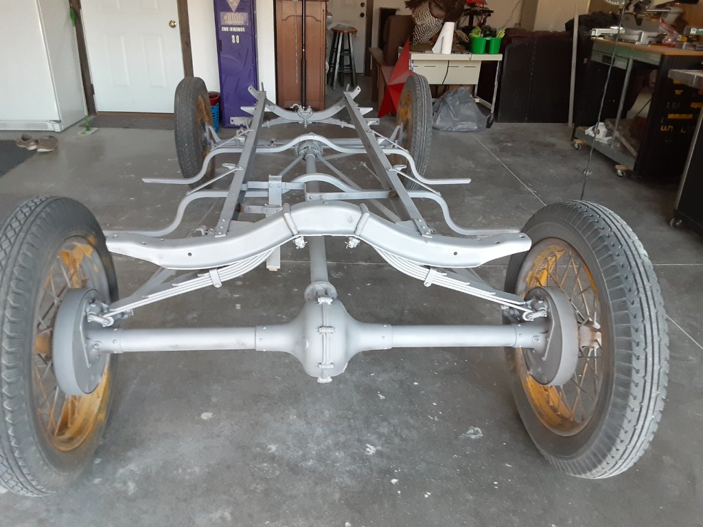

Norman, The first photo shows the spring on the chassis. The gap between the ends of the bottom and second leaf on the right is visible.

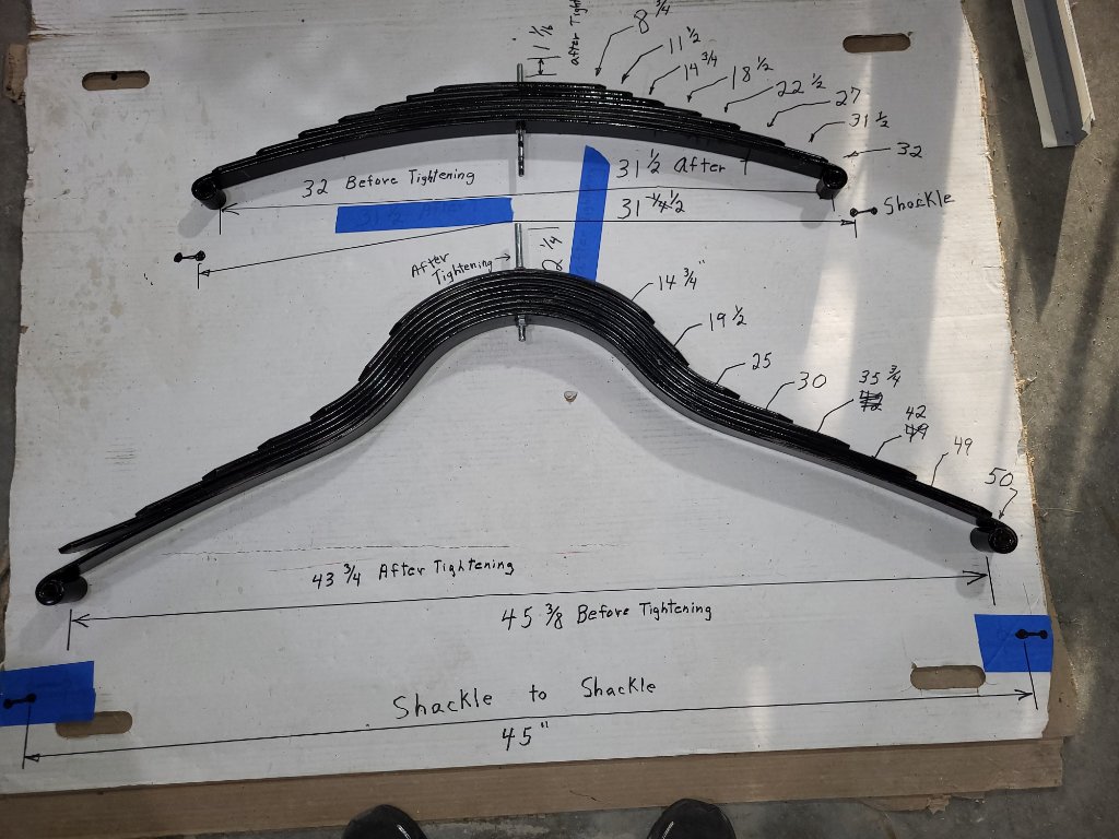

Here is detailed information for my springs.
The numbers on the right side are the lengths of each leaf.
Comments?
Comments?

Very good looking springs. While the springs are on the paper, go ahead and outline them so once you re-arch the leafs, you can see if there is a difference in the arc of the springs. Everything I said before still stands. First thing you need to do is take the upward bend out of the second from the bottom spring as spelled out earlier. It appears that the bend starts to bend up at the end of the third from the bottom spring. You should mark it with masking tape so you will know where to position the block under the leaf before taking the upward bend out. Jim Patrick

In the photo that shows the dimensions of my rear spring, it shows the eye to eye measurement of the rear spring to be 43 3/4 " after tightening. The shackle to shackle measurement is 45". A difference of 1 3/4". Is this unusual?
How can I make the connection? Snyder's has a spring spreader. Is that what I will have to get or is there another way to install the spring?

Normal. Loosen the nuts that hold the perches so they are holding by only a few threads. Move the perches inward toward the center. Move the rear axel to a height where the shackles will slip in. That's it.
- Posts: 4694
Re: Rear Spring--Odd Situation
I place the eye of the spring in one side with the shackle. I jack up the body to get the weight completely off the spring then put short piece of 2"x4" under the spring eye on each side. Between the spring and the axle housing. Then let down the body and frame on the axle. If it doesn't spread, add some weight to the body such as someone in the back seat or a fly wheel etc. When you get the weight just right the shackle will slide in on the other side. When you have everything tightened up, jack the frame just enough to get the wood out and let it down.

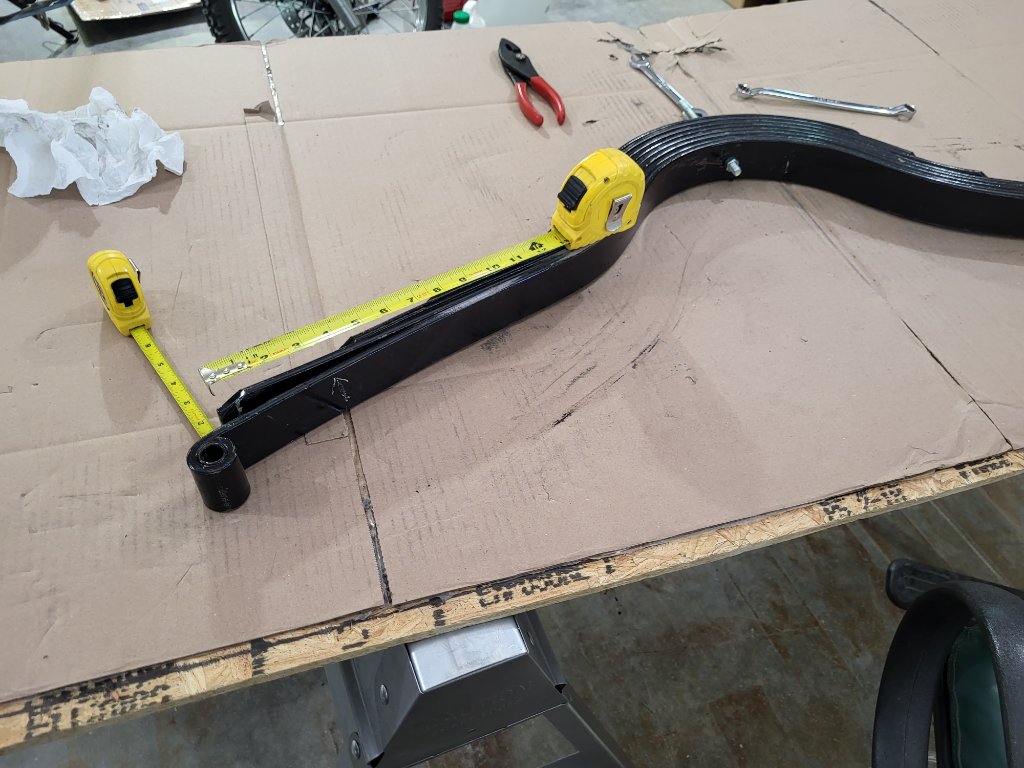

I used Jim Patrick's method to straighten the end of the second lead. It worked fine. Thanks Jim!

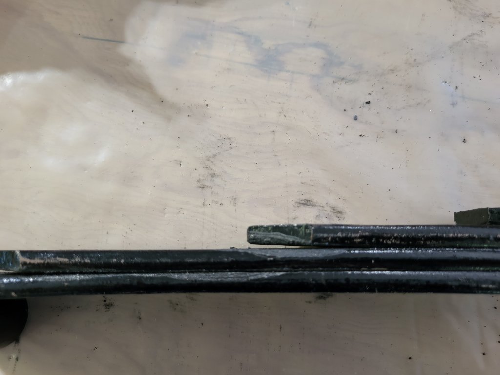

The attached photos show close ups of the straightened second leaf. Should I have tried to straighten it more?
The second photo shows the first, second, and third leaf.
- Posts: 8438
That looks fine to me. When the weight of the car is on the spring, it will settle like it should. If it doesn't right away, it will after you drive a few miles. You will probably need to retighten the clamps that hold the springs to the front & rear crossmembers after 50 miles or so of driving. The spring leaves and clamps will need a few miles in service to "bed in". It's a good idea to go over the entire car after driving it 50 miles or so. Check all bolts, nuts, and screws to be sure they are still snug. Pay special attention to chassis fasteners and lug nuts. Doors, deck lid, fender bolts, etc may need minor adjustment.
