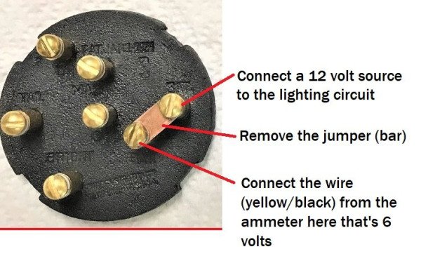

Is that weak magneto I smell? If you haven't already, try using a fresh, hot 12 volt battery for an ignition battery.

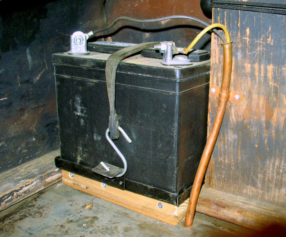

I think you’ve mentioned in earlier posts about a hot shot battery set up. Does your 15 have one. Wasn’t that an alternative after several years owners would use one in their magneto only cars?
Could your issue be a weaker mag over the years since you built up your 15 ?
Model T’s are cantankerous after they get some age on them after a rebuild.

The juice for the coils is from a 12 volt mower battery. It buzzes the coils, but I'll put a charger on it to be sure it's all the way up.

Maybe you could use a standard std 6 volt battery from your other T and use it to jump off your 15. I dont know how you’ve got your 15 wired for the hot shot but it might be worth a try. And if it started that would tell you it’s a voltage issue. Like R eagle mentioned it’s probably something simple. Could be the voltage.

I was having same issue with a small 6 volt battery, and I hooked up a freshly charged 12 volt car battery, and easy starting was restored. My smaller battery was registering fully charged but it wasn’t the same as the 12 volt.

Try a new battery.
A coil will “buzz” with less than 6 volts DC.

I need to revise/update my mag charger page. Last winter when I set about installing brake/tail lights and turn signals in the car I replaced the little six volt battery strapped in the frame with a 12 volt riding mower battery in the trunk. LED's for 12 volts are much more plentiful than for six volts.
The present battery is an EverStart U1-7 (230 CCA) from Johnson Controls via Walmart.
In our last exciting episode you will recall that Sunday morning, after an overnight battery charge, the hard starting was "cured". But by Monday evening (last night, same carburetor, same everything else) the car was again a non-starter with too many pulls to count until I jacked a rear wheel off the floor to get it going. That's the frustrating thing about this adventure. Sometimes the problem seems fixed, then it isn't, then seems OK, then isn't.
I was going to try out a Holley G I've been working on, but for now I have a charger going to see if that will "cure" the hard starting again as it seemed to do Sunday morning. I'm leaving on the same NH that "didn't work", then did, then didn't. We'll see how that goes.

Voltage choice, 6 or 12, is simply decided upon the device requirements being 6 or 12 volts. Amperage has to do with the the load on the system and how those amps need to be delivered to the load.

Two battery solution 6v and 12v simply remove the jumper and hook your light battery to light circuit and your coil battery to the other post
