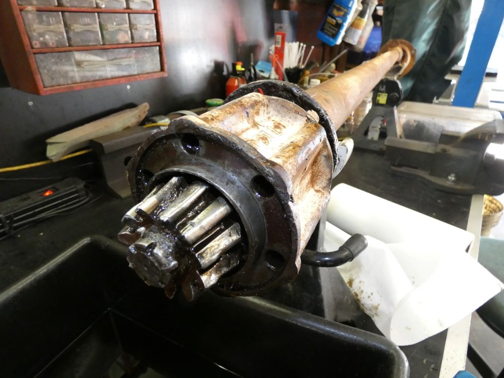

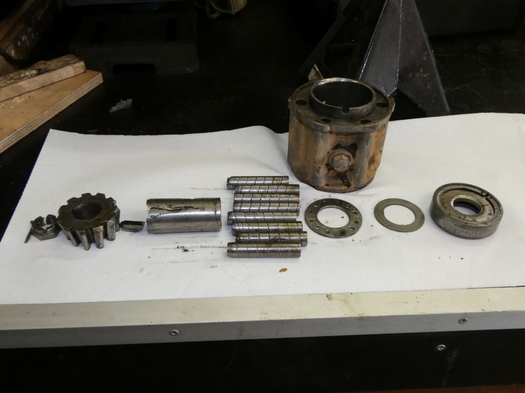

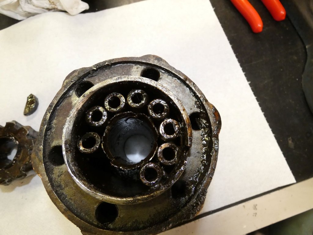

There was some noice on the driveshaft and the car stopped.
Post by AndreFordT » Tue Aug 23, 2022 7:11 am
"The car was barn find and driven as it was for a few miles.
Than there was some noice the car lost traction and the brake failed".
Here is what I found.
Next step will be the rear axle inspection but I think it will be no better.
Andre

babbit washers failed on either side of the ring gear causing the ring gear and pinion to go half mesh which stripped things.
