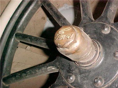

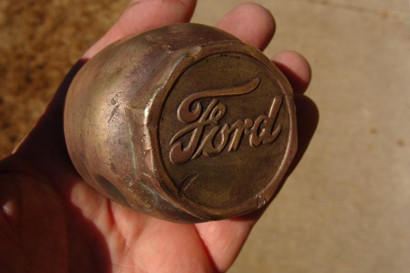

One of the hubcaps on my car.There is a raised edge around the front but it's very faded.

Darren-

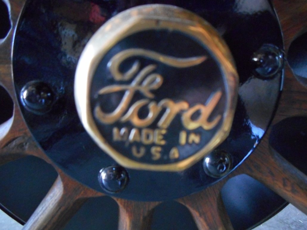

That style came out in July, 1911, but most cars of that era still used the earlier style. I had these restored for my Oct-Nov 1911 car.
The background should (and will) be black oxidized. I suspect the hubcaps you have are correct for your car.

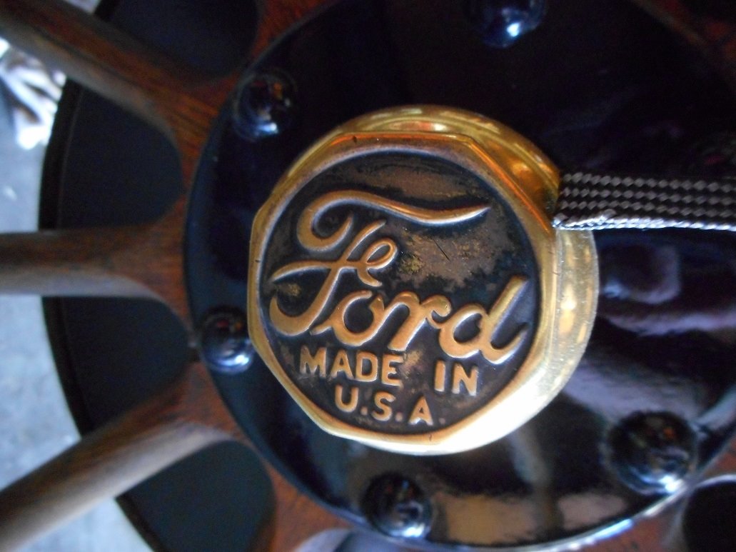

On April 16, 1912 (the day after the Titanic sunk) MADE IN USA was stamped beneath the Ford Script. (Has anyone ever seen one?)
On May 13, 1912 the MADE IN USA was embossed (raised), just like the script.
On May 7, 1914 the background was black enamel, instead of oxidized.

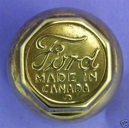

I have seen this type of hubcap, which I believe to be Canadian (since there is no MADE IN USA,) but could only guess on the year. The small script would lead me to believe late 1917. I have seen these nickel plated, too.

I have see nickel plated hubcaps with MADE IN CANADA, but they all have had the smaller script.
hubcap made in Canada.jpg (49.4 KiB) Viewed 9505 times

I have never seen a tall script hubcap with MADE IN CANADA. Has anyone? What hubcaps are on other Canadian cars 1913, 1914, 1915?

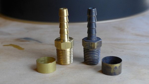

Please pardon my ignorance... but how would I go about applying this black oxide background to my hub caps? I looked online and all the methods I saw were dipping the part and turning everything black.
Any insights?

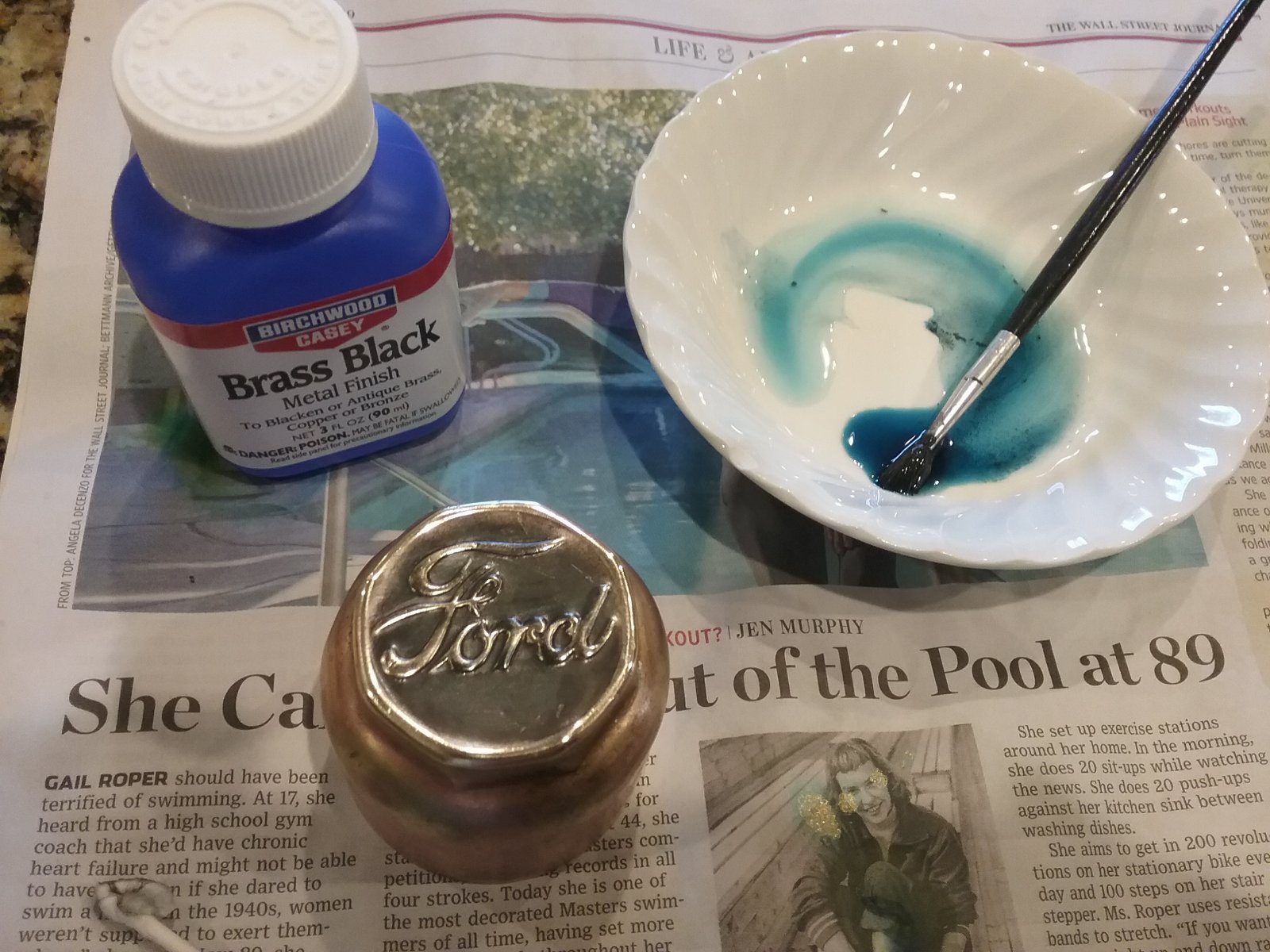

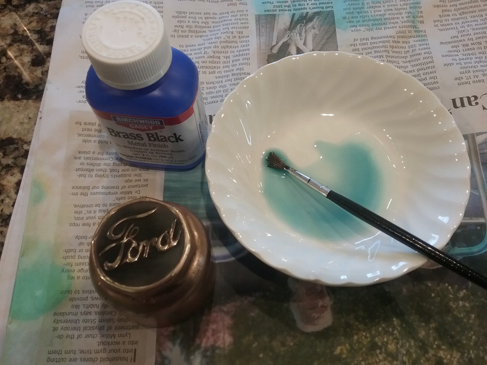

I have heard good reports about this product:
https://www.walmart.com/ip/BIRCHWOOD-CA ... Z/23237826
Here is the finish it leaves..
Casey Black brass.jpg (25.66 KiB) Viewed 9454 times

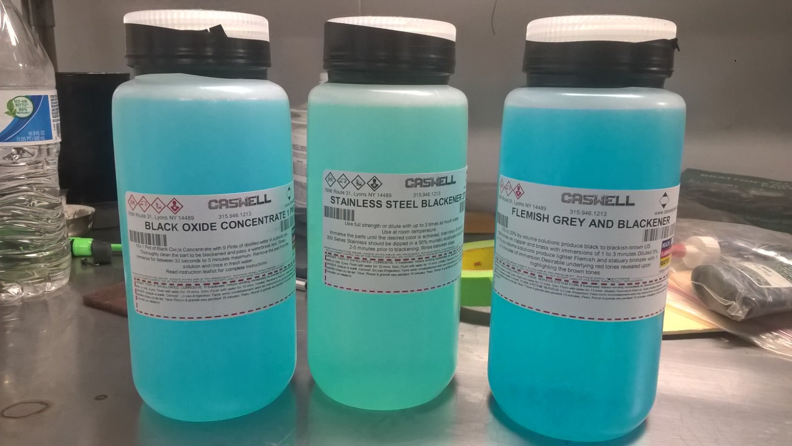

To add another one to the discussion, last year I used Caswell's "Flemish Grey" with good results. It was tricky in that it was very particular about the soak time. Too long and it's like the black layer would get thick, flake off, and you were back to starting over with yellow brass. It wasn't difficult, you just had to pay attention and leave the, "if a little is good, more must be better" mentality at home.

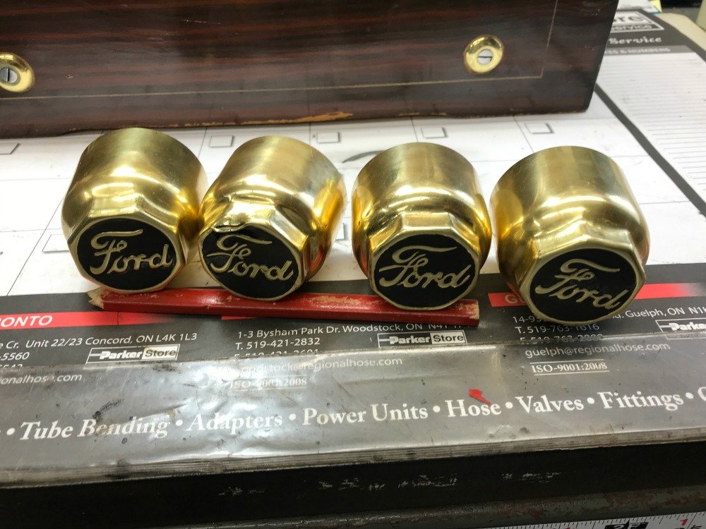

Post by Darren J Wallace » Sun Apr 21, 2019 11:04 am

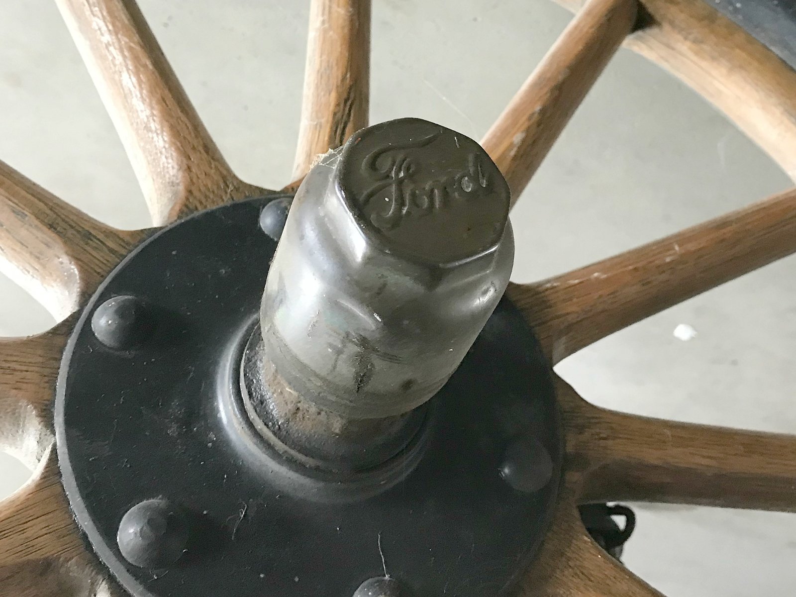

So I did this....two of the original hubcaps were very badly cracked so I got a couple of new ones and relegated the bad ones to the tool box....
Darren J Wallace
Posts: 367
Joined: Sun Jan 06, 2019 11:43 am
First Name: Darren
Last Name: Wallace
* REQUIRED* Type and Year of Model Ts owned: 1913 Canadian Touring 1905 Queen model B
Location: Woodstock, Ontario, Canada
Re: 1912-1913 Hubcaps
Post by Darren J Wallace » Sun Apr 21, 2019 11:10 am
I used gloss black paint and a very tiny brush, then some 0000 steel wool to bring out a little better definition than my shaky hand would allow, and to give a sort of matte look you get like the anodizing gives. I need to correct all the little mistakes......

Nice work, Darren. It is easy to spot the differences between the originals and the reproductions.

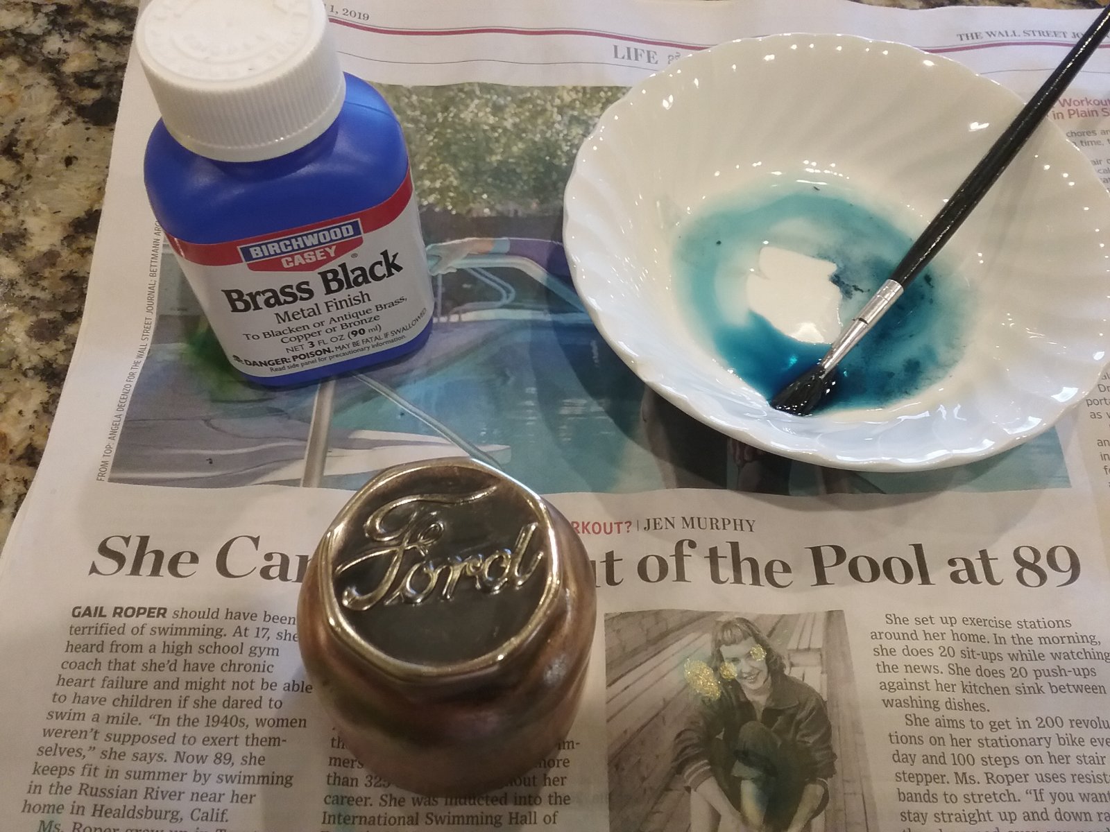

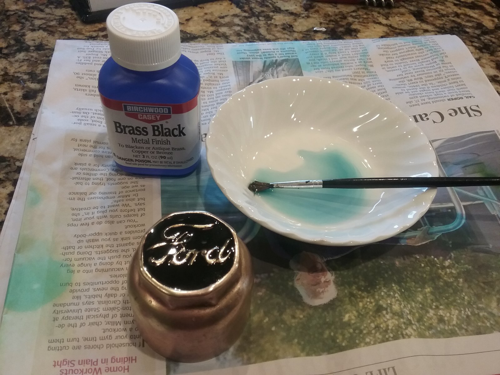

I tried some Birchwood Casey Brass Black, but am not super impressed with the result:

Post by KWTownsend » Sun Apr 28, 2019 11:36 am
Rich Bingham
Posts: 1942
First Name: Rich
Last Name: Bingham
Location: Blackfoot, Idaho
Post by Rich Bingham » Mon Apr 29, 2019 9:38 am
They look good in the pix, Keith. What do you find lacking ?

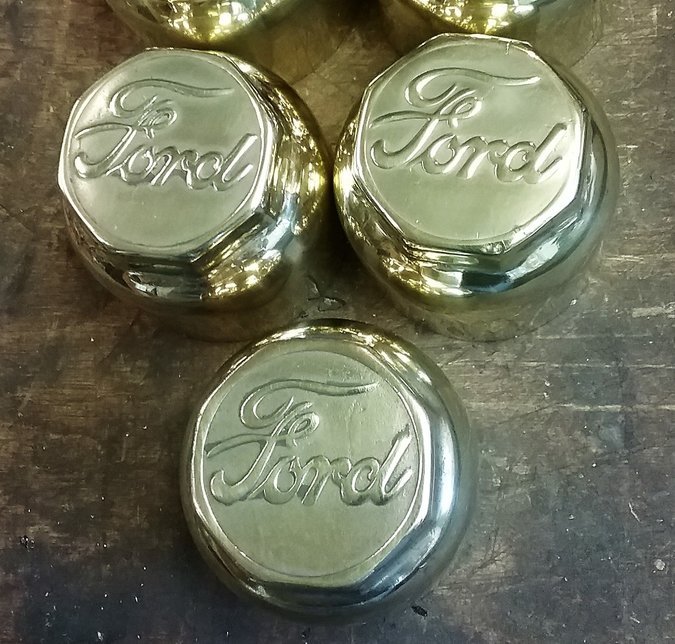

No one has posted photos of a true 1913 hub cap, which is slightly different than the '14 and later styles. So here is some photos!
