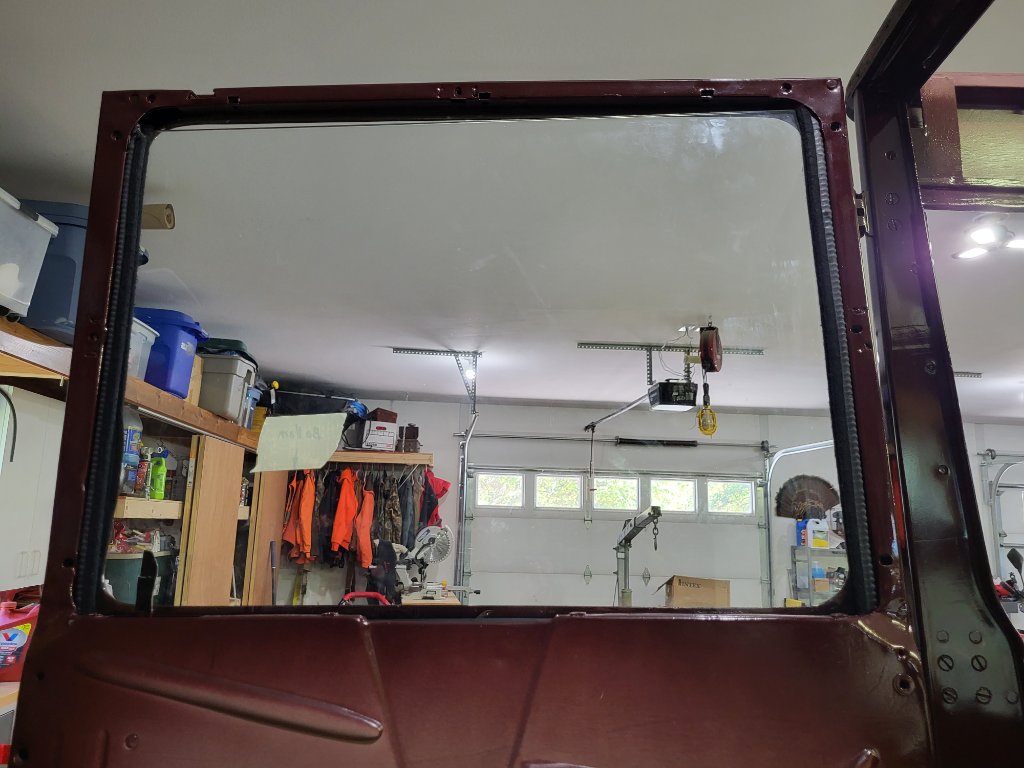

I am installing new widows in my 27 coupe. I am having difficulty with one of the door windows. I can not seem to get it to go up level. It always touches on one side at the top and leaves a gap on the other. Has anyone had this problem, and how did you solve. it -- Thanks for any help-----Joe. joeg48@hotmail.com

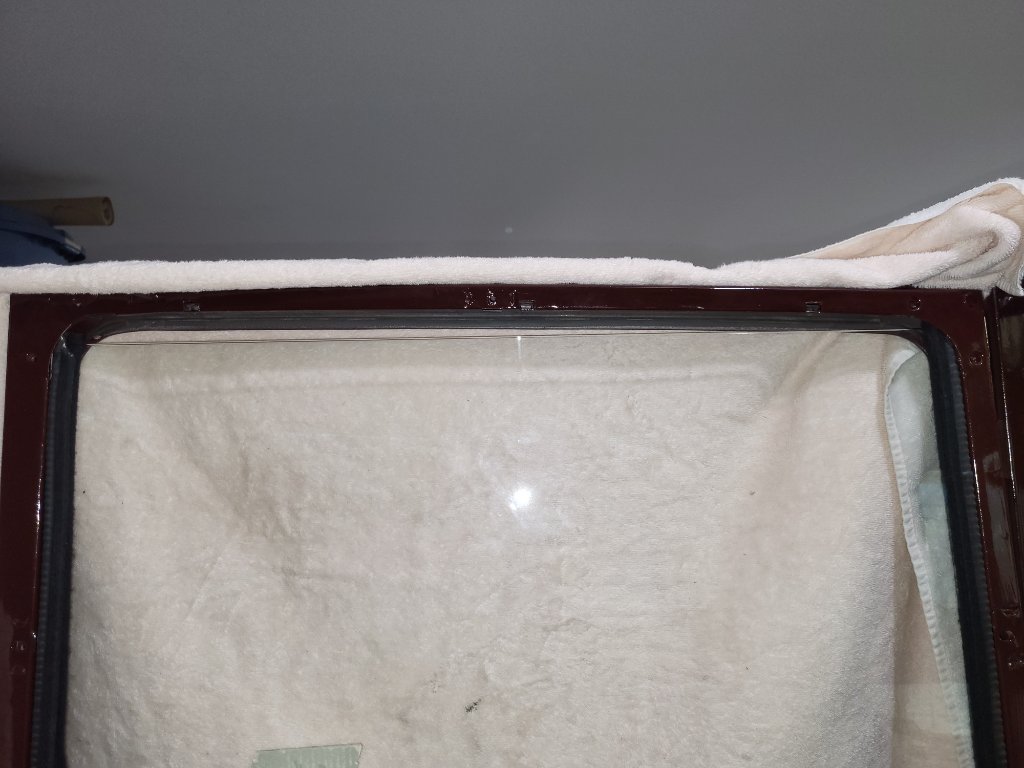

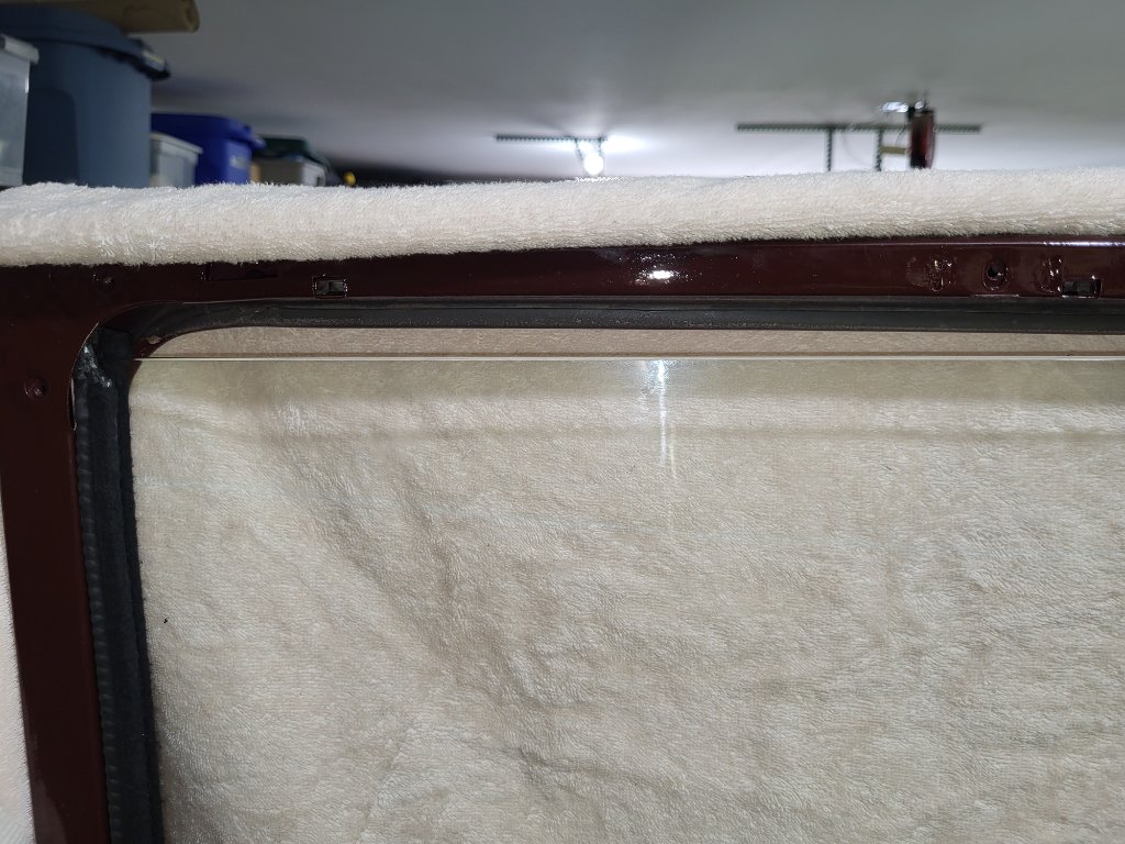

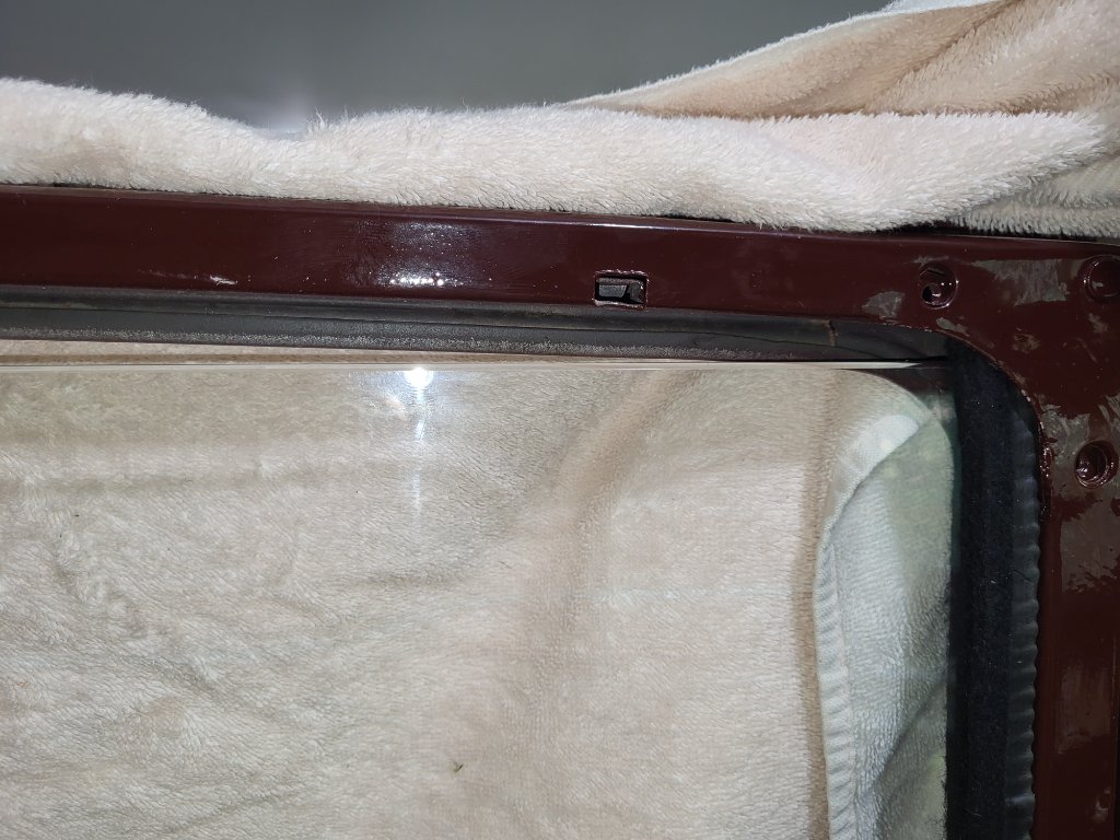

Joe, Here is what my situation is with the driver side window.
It is apparently like what you have. I will try to show it with the attached photos. There is a gap at the left side of the window. The replacement glass is as is shown in the glass book. It is 20" on the rear of the door and 19" on the front. I do not understand why there is the gap.
I have just started to install the window glass on the passenger side. It appears it will not have the gap as on the drivers side.
Is your situation the same as mine? Do you have any idea what the problem is?
