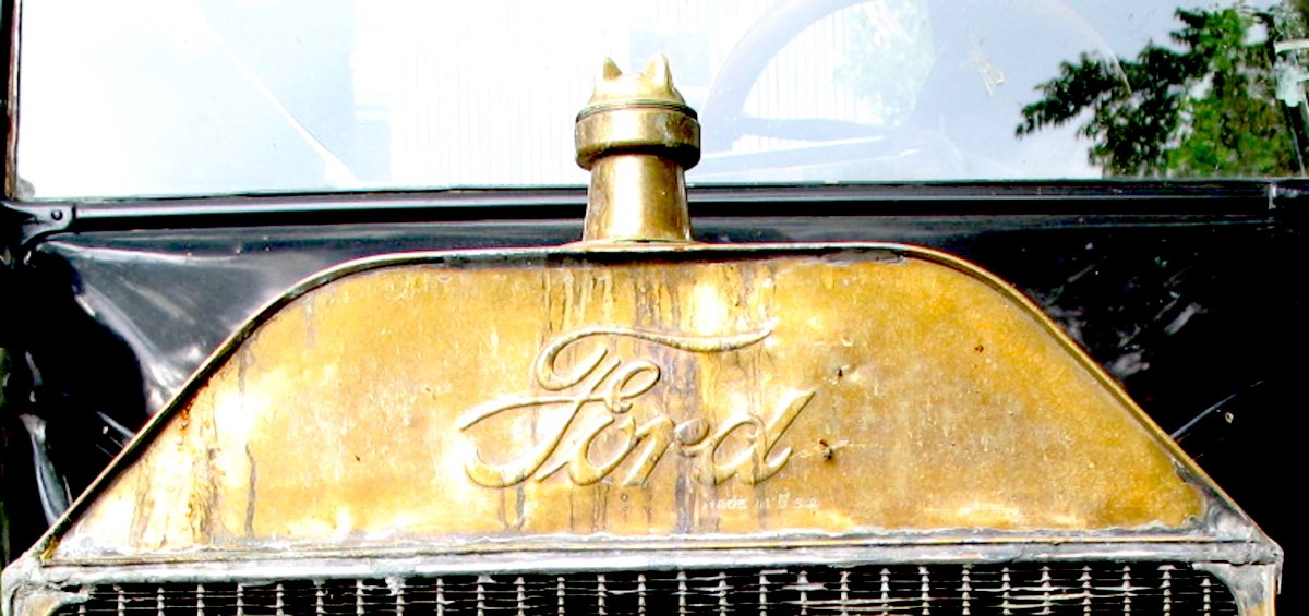

Before I attempt repair of the dripping seam, I have some questions. What is the opposite of flux? Is there something I can apply where I don't want the solder to go? Or should I mask where I don't want solder, apply flux, and pull the tape before soldering?
Is there a particular type of flux that would be best for this?
Ditto solder: Is there a particular type that would be strongest and seal best?
How shall I clean the seam before soldering?

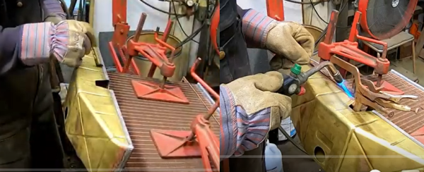

Various techniques are discussed in this link related to brass instruments https://www.trumpetherald.com/forum/vie ... ?p=1160489
Since you are working with metals solder (tin+lead) and brass (copper+zinc) removing one it with an acid solution likely will harm the others.
Looking at the piece is would not try a brushing method using some of he above (steel wool, old cotton sock) but using desoldering tape that is used to remove components from a circuit board. It acts like s sponge and will get most of it off.
If you have a leak, the heat applied when removing the excess solder may seal it up. I wouldn't try to fix it until the excess was removed and you test for leaks again. --
--The sell a special high temperature tape to protect areas from getting soldered. Now experience with these --
You also need to consider using the correct alloy of solder
https://info.mayeralloys.com/blog/3-thi ... -radiators

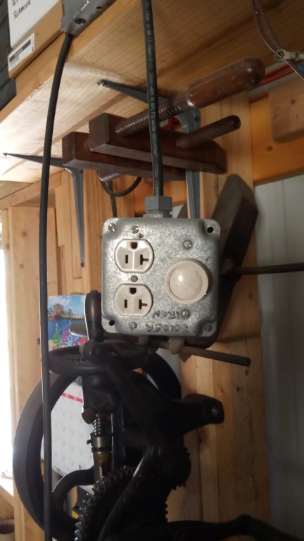

Here's a tip: build yourself a rheostat controlled plug to control the iron's temperature. This keeps you from burning the tip with excess heat at the tip.
Mine is a handi-box, light dimmer, and a duplex plug. I use it for large soldering jobs and my oil-pan heater on my jeep
If you're an electrical-type guy and have a Variac, use that instead.

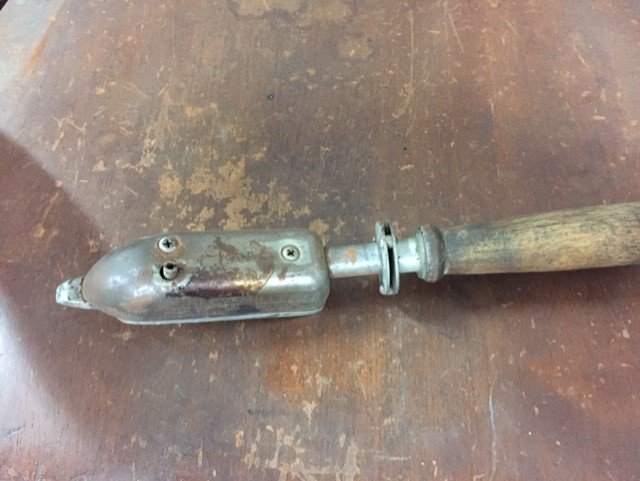

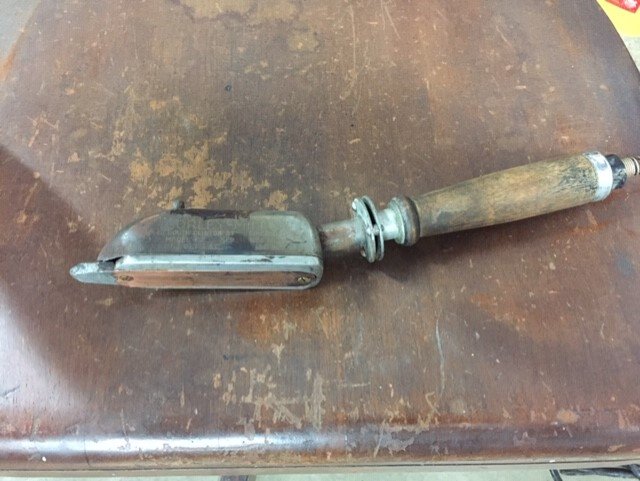

Many years ago my father made a soldering iron from an old veneer iron. The temperature is adjustable from 200 - 500F. He milled a slot in the face of the iron and inset a copper strip. This is one of the best soldering irons that I've ever used.
