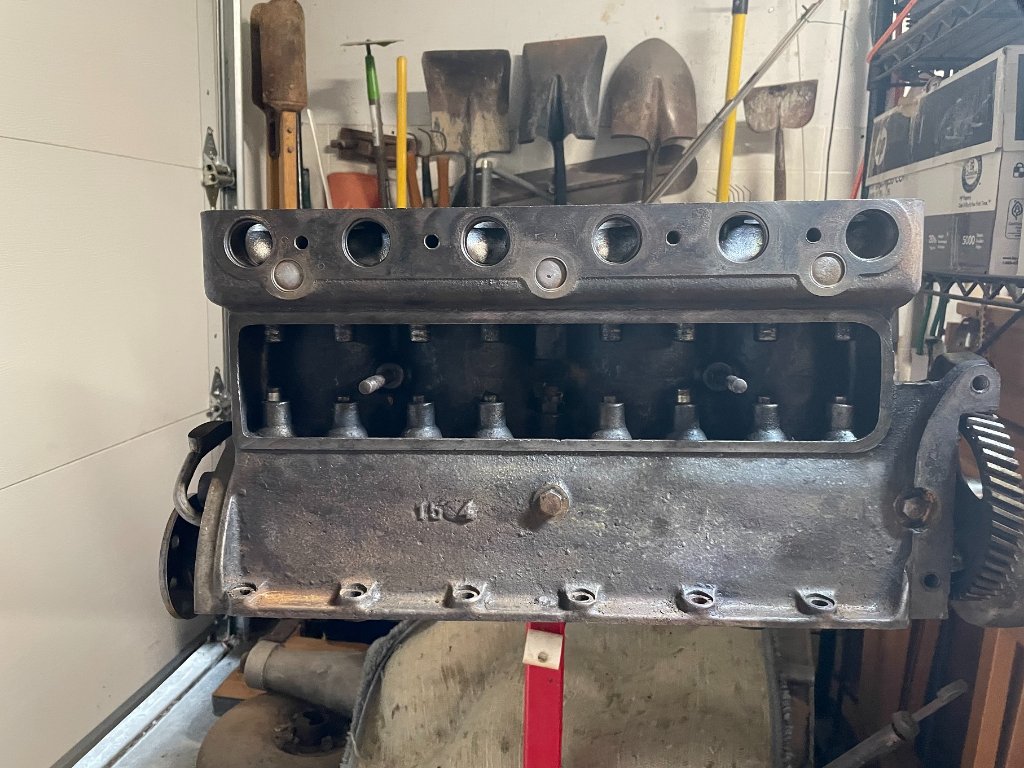

I started cleaning the block and ran over the freeze plug once and it started a hole in it.

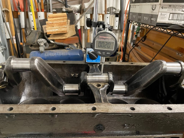

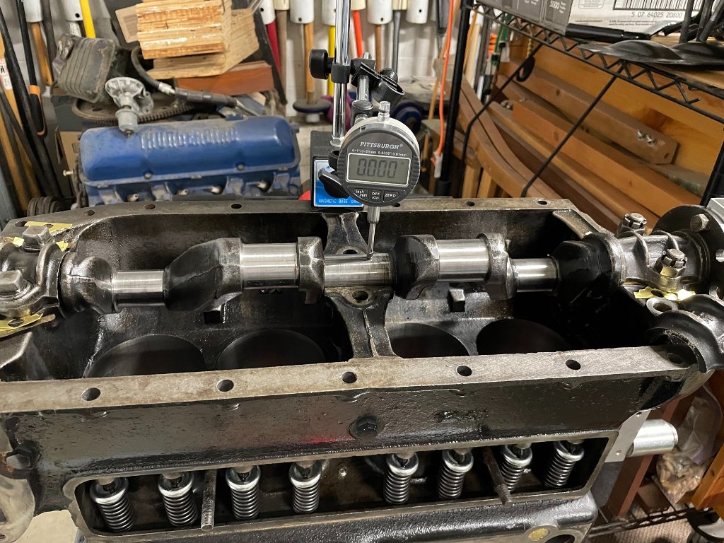

I have replaced the vales and springs, I pulled one piston and decided to put new rings in too. Give it another refresh. When I pulled the pistons, I notice felt a sticky spot in the crankshaft when turning it. I pulled the caps on the crankshaft it had a few shims. I set the cap back in their spots and spun the crank, and herd lots of clicking from the loose caps. I reshimed the caps follow the web side tips and I could get it to free spin but still little stiff and I did not want to add to many shims. I pulled the center cap here and put a Mic on it. Is it bent or is the run out?
[image][/image]
Can you run this engine with this crankshaft?

Not enough information to say. It could be a slight bend in the crankshaft or it could be that the middle journal is out of round. BTW, that's not a mic, it's a digital indicator.
- Posts: 8691
Re: Junk yard Special update
It sounds like a bent crankshaft. If that's the case, I'd want to check the shaft and the crankshaft rear flange for misalignment and straighten everything as required. I would not use that crankshaft until the problem is located and corrected.

Magnaflux it. The ring test is not definitive. Member of the 2 piece crank club.

to your bend question: yes you certainly can fix it
first you want to be sure it's bent and not out of round...that can be done when it's reading ..002 and then with your hand, pushing down on the crank right at that spot and seeing if it will go back to "zero". If it does, it is bent. You will want to set up the indicator to anything over .010 and push down and see what the TOTAL deflection is and I'll bet you'll find the center main is also worn 2-4 thousandths, too
On my refresh 2 years ago I found the crank bent .004 and straightened it in a press...it took about 5 significant "over bends" to get it to settle out. Additionally, each day, it would relax back to about 75% of the previous "outage" and needed to be repressed - again, with significant overbends. I did this over a period of 3-4 days and it settled in at .0005 and I was tickled with that.
From there I had to scrape the front and rear mains to drop the crankshaft down to where it would also seat on the center main. LOTS of work with a scraper followed by a finish of TimeSaver. I fitted all new caps to the mains (again scraping and TimeSaver) and fit an undersize timing gear and all was fine...BUT it was a lot of work and I still have old babbit. I think I'd just redo the whole block as-new the next time. I don't have to be anywhere during the day and this was a long Winter's Project. If I was a 9-5 guy I would have never had the time to invest, and time vs $$ it was a very heavy investment in time. Good luck.
