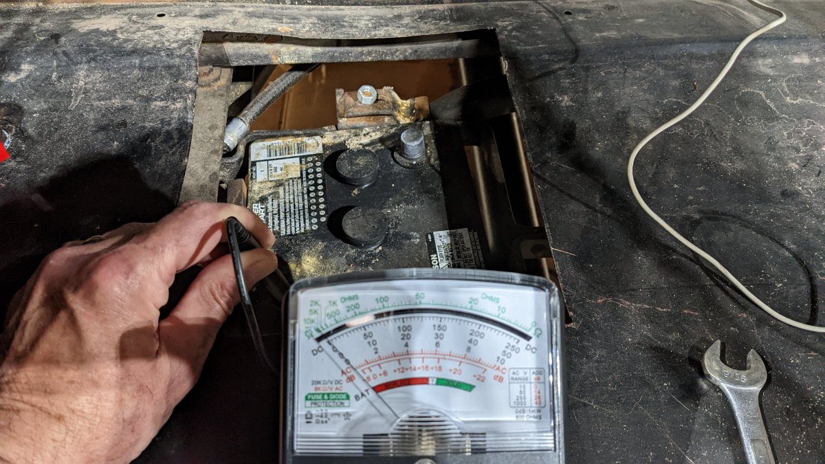

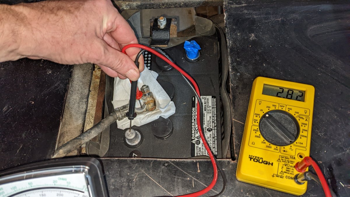

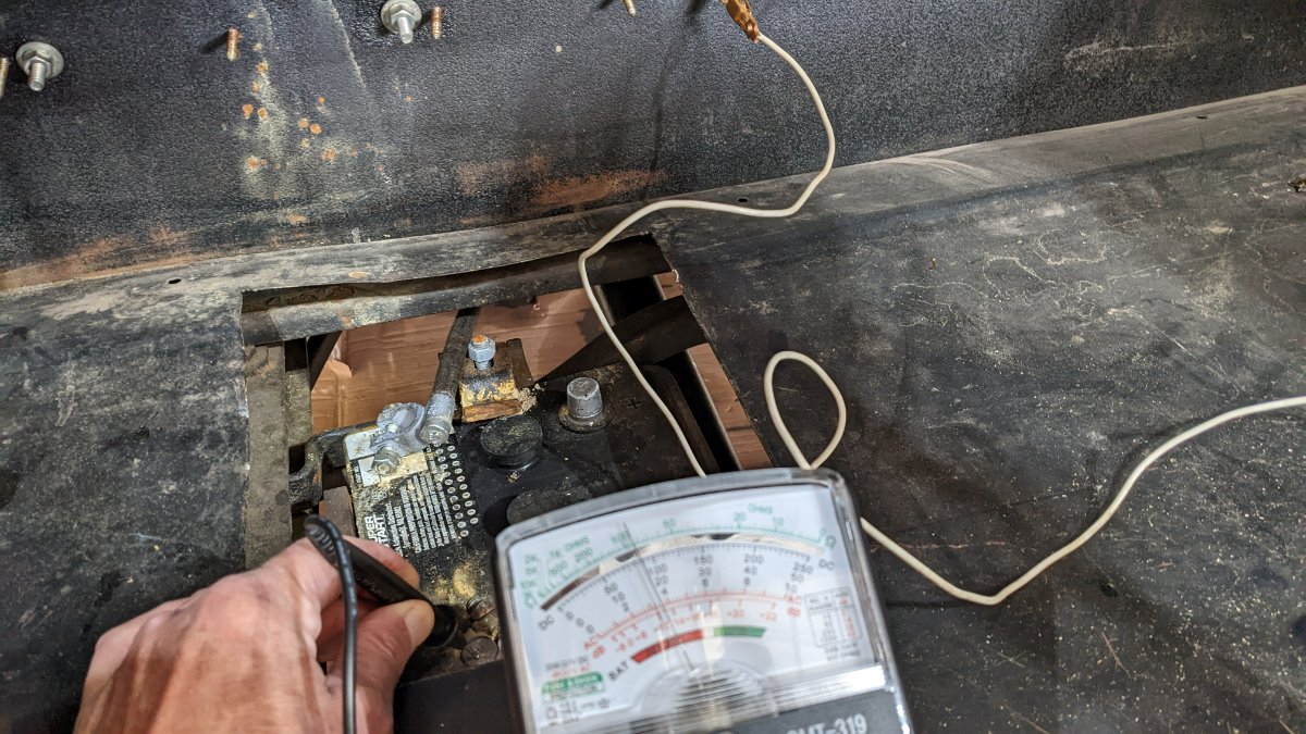

I am confused. My generator recently stopped working and I need to review the service and electrical manuals for that. I wanted to check continuity through the cutout with the engine off. There was none. I have a new analog multimeter that I wanted to try so I checked battery voltage. 6.02V I checked voltage at the yellow (battery) wire on the generator. To my surprise, I had 3.3 volts. I was surprised because my battery disconnect switch was in the OFF position. The switch is wired on the ground strap.
I disconnected the positive cable at the battery and checked voltage from the negative post and body ground. I got 3.3 volts. The battery disconnect was still in the off position with the positive cable disconnected. Where is the voltage coming from? I don't have another battery anywhere. Could the potential be coming from coil capacitors? That is the only source I can think of. I want to get this sorted before I start messing with the generator. I plan to start disconnecting wires starting at the battery negative and disconnect switch.

1. FWIW, 6.02V is pretty much a dead battery
2. Disconnect on (-) is in my opinion, the wrong post
3. Disconnect very likely has a high resistance short which is allowing some voltage to the "battery" wire on the disconnect...it won't conduct amperage but will allow voltage to show up...if this is the case, then "connected" irregularities may also be occurring (see 5. below)
4. Regardless of their saftey/utility in installation, any disconnect other than a knife-switch is going to fail "open" eventually
5. With what you are finding, there is at least some possibility that your disconnect caused generator issues

Based on your description there would be no connection of the negative terminal on the battery to the body ground with the disconnect off. If the disconnect was connected you would be testing a ground to ground connection for continuity and not in either a series or parallel circuit to a voltage.
But you may be measuring the difference between the battery ground and earth ground. Make sure the positive cable is not touching
Explanation from the Internet
https://www.learningaboutelectronics.co ... ltage.html
"If a battery has negative orientation, its voltage with respect to ground is more negative than ground, and it delivers positive current to the ground part of a circuit."
https://maker.pro/forums/threads/differ ... ge.277846/
-Ve is a voltage negative with respect to ground. Ground or 0V is typically the reference potential within a circuit. When you connect the "+" pole of a battery to gnd, then the "-" pole of the battery is negative with respect to ground
Make sure the positive cable end is not touching any part of the car, ie insulated when you do your tests
Curious: If you reverse the test leads do you get a different reading?

My positive was not insulated during tests. When I reversed the leads from the photo the voltage went negative. I had the same result using a digital meter. The 3.3 volts went to zero when I turned the disconnect to on.
"2. Disconnect on (-) is in my opinion, the wrong post" I know but it was so convenient.
"3. Disconnect very likely has a high resistance short which is allowing some voltage to the "battery" wire on the disconnect...it won't conduct amperage but will allow voltage to show up...if this is the case, then "connected" irregularities may also be occurring" I immediately suspected the disconnect.
There is one other thing I did not mention originally. I checked continuity from the generator post to a screw holding the cutout onto the gen case. There was 0 ohms. Shouldn't that be an open loop?

I disconnected and insulated both cables from the battery and I still get 3.3 volts from the negative battery post to body ground. I have a leak somewhere in or around the battery that needs to be eliminated. I will start by removing the battery and cleaning everything up before doing anything else. Thank you for the assistance.

Mark
let me ask or suggest that you are reading perhaps 3.3mV?
I'm not sure that meter could even be set to that range, much less believe it, but something does not add up at all

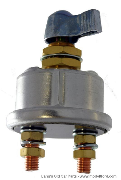

What type of battery disconnect do you have and where is it located? I couldn't tell in the photo.

Re: Where is this voltage coming from?
Scott,
You had me doubting my meter settings so I rechecked. My digital meter was set to 20V full scale and analog set to 10V full scale. I think Pat is correct that there is a lot of crud on the battery that can conduct electricity. I also have a wood block under the battery and one on the side to stabilize it. Wet wood can also drain a battery.

Your voltage may be coming from the contamination across the top of the battery

This discussion isn't about the generator but the battery showing a voltage. The same issues could have evolved with an alternator not working.
Here's a link where a member had the same issues with a generator and then again converting to an alternator.
viewtopic.php?t=30909
Can you provide any ideas that might resolve the voltage issue when the engine is not running?

Mark just for giggles can you take the master disconnect switch out of the loop. About 13 years ago I was having some issue similar to yours and talked to 2 folks that were/are major vendors for products involving the electrical system for model T’s. Both told me the same thing about the master disconnect & suggested I remove it. I did & problem solved. This may or may not be the answer for you but easy to rule it out. This falls in line with what Scott posted earlier.

I disconnected both battery cables which should eliminate all passageways through the switch. With the battery still in its carrier, I get the same 3.3V from the negative battery post and body ground. There are no electrical or transmission towers within miles of my house to offer interference. I will get time Thursday to clean everything up and retest.

Try a different volt meter. what you are describing sounds impossible.

Ok spit balling here, do you have an aluminum head? To the folks more electrically inclined, if he has an aluminum head could electrolysis give a reading? May be far fetched I know but other than a need to use a different analog meter what could explain the impossible.

I suggest removing the battery from the car. Place it on the ground near enough for your test leads to reach both the battery and car. Test again.
There has to be a complete circuit for current to flow and voltage to be measured. The battery has to be connected to the car in some way, even with the cables removed. As was suggested above, the battery acid/corrosion build ups on the top, sides, and bottom, are able to conduct electricity. My guess is, a good cleaning of the battery exterior and battery holder will eliminate the problem.
And, yes, galvanic corrosion between an aluminum head and iron block will show measurable current. It will be a short circuit between the aluminum and iron through the coolant. Thus the need for a sacrificial anode that will be corroded away instead of the head (being the softer metal). This process normally does NOT include the car battery in the circuit.

I suspect acid residue on the battery case, or possibly a hairline crack or pinhole leak in the battery case.

- Posts: 5544
Go back and look the very first photo, he is using an analog meter.J1MGOLDEN wrote: ↑Wed Oct 05, 2022 7:21 pmJunk that meter and get an earlier type with a needle display, commonly called an analog meter or multimeter if it measure both AC and DC and Ohms or Resistance.

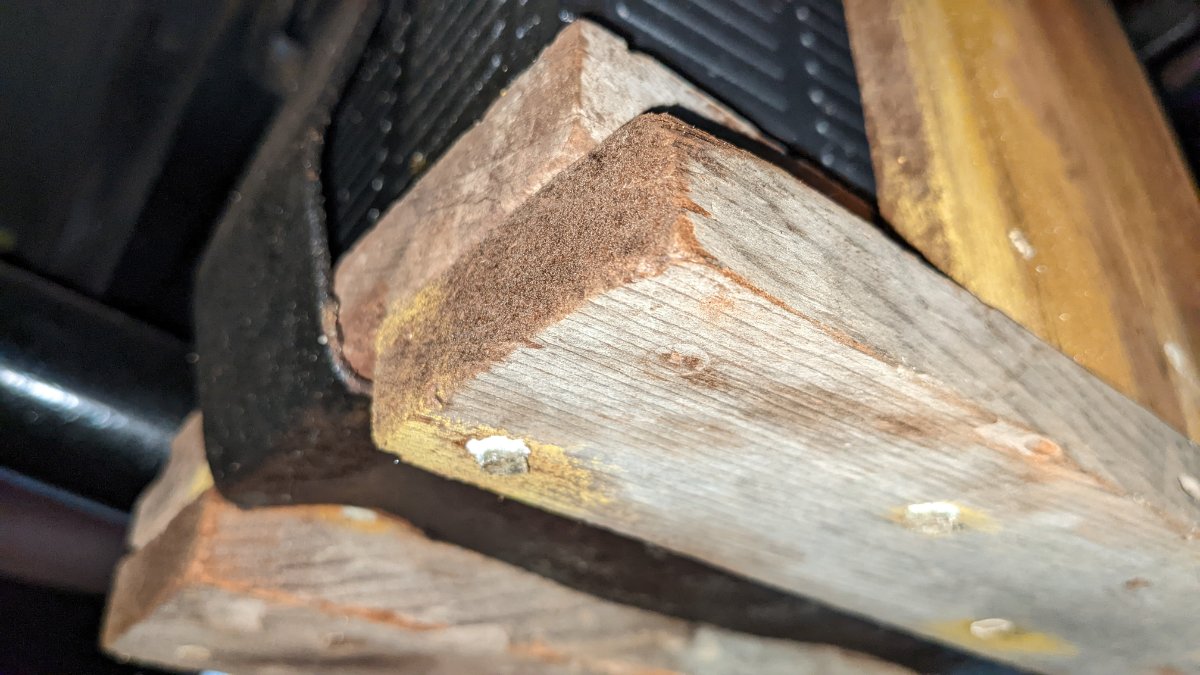

I moved my battery clamps out of the way and my free electricity is gone. Time for cleaning.
There is Galvanic corrosion on screws of my riser block too.

Batt has created it’s own circuit. Usually through dampness. A good cleaning and replace wood with non conductive materials.
- Posts: 8636
Batteries need to be kept clean and dry. Your battery may be suffering from poor charging circuit regulation, which is a trait of the Model T system. Overcharging will increase the tendency of the battery fluid to escape the cells as vapor and mist and cause corrosion and filth to accumulate. Checking the battery fluid level regularly very important. Add only distilled water, if needed, and do not overfill. Batteries age and decay, even under the best of conditions. If your battery is 3 years old or older, it is probably just about junk, especially if it is a cheap battery to begin with. There are things you can do when running a Model T to manage the battery charging rate which are discussed at length elsewhere on this site, and doing these things will enhance battery life and prevent problems with the battery, starter, and generator. The Model T system depends on a good battery in good condition to work as it should, with the charging rate adjusted to the best advantage for operating conditions. Cleaning the battery and the area around it regularly will prevent problems with the battery and cables and prevent acid residue from damaging the car's body and frame and battery carrier. A battery with residue on it can self-discharge due to leakage of current through the residue. Buying a good quality battery is always a good investment.

While your cleaning the battery and cable connections you should also clean the master disconnect switch terminals.
- Attachments
- disconnect.png (234.59 KiB) Viewed 8108 times
- Posts: 6792
It's the internal contacts which will fail, not so much the terminals, though I agree it is always good practice to clean all connections.

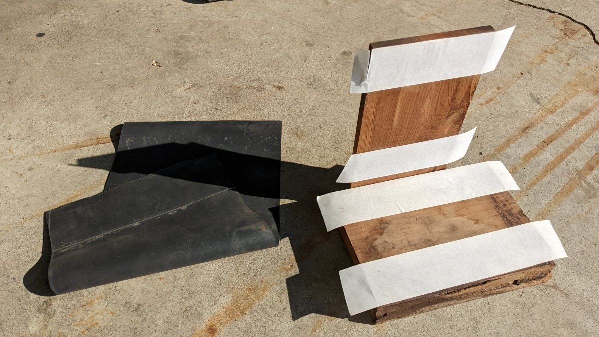

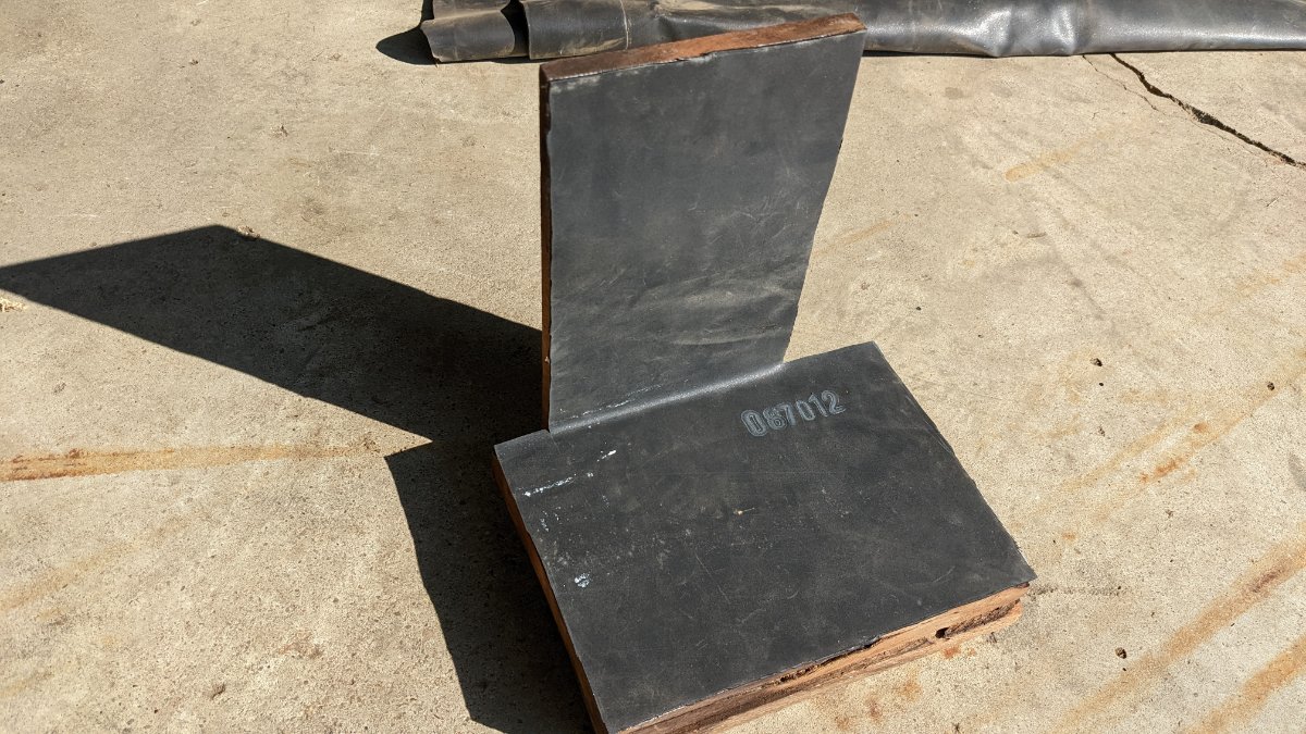

I washed the battery, carrier and wood blocks. I had some EPDM (rubber) membrane material that I stuck to the wood as an insulation. I put a layer on the bottom of the wood too for extra isolation between the battery and carrier. I got some voltage leak. I wrapped that battery in EPDM for another layer.
Guess what, there is still a voltage from the negative post and ground.
I removed the hold-down clamps and voltage went to 0. I could press down on the battery with my hand and produce some voltage. This is so bizarre. I'm going out now for more tests with a third digital meter. The EPDM tested as an open loop on the ohmmeter.

Robert, in my posted photo above you can see 2.82V with the battery clamped in place. I did not mention his but before putting the clamp on the battery I was able to vary the voltage by pressing on the top of the battery case near the positive post. 2.82 was the max. That just adds to the list of questions.
I had to stop working on this for now. I am currently putting up a building to house my camper and that is taking all of my spare time.
