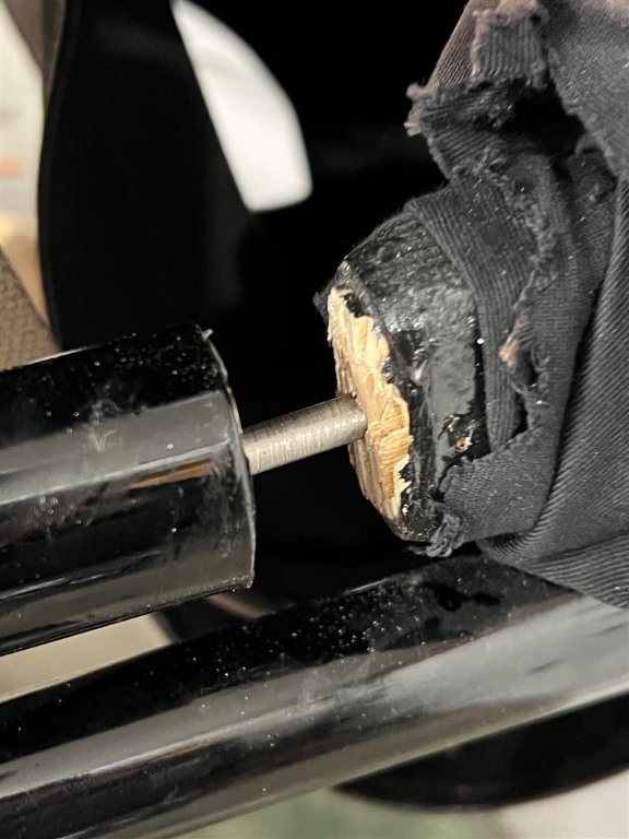

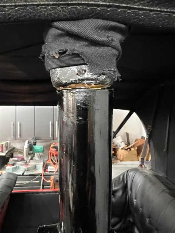

When I restored my '16 Touring in 2008 I installed a new top, new sockets and new laminated top bows.
In about 2012 one side of the rear bow broke right at the socket.
At that time I repaired it by inserting a 1/4" stainless steel rod between the bow and socket.
The rod penetrated about 3" - 4" into each side.
It has held up well.

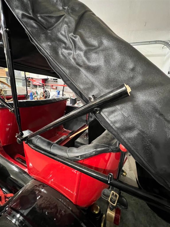

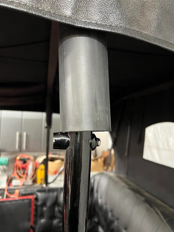

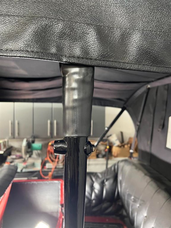

While doing work this last summer I put the top down.
Some time later I noticed that the second bow from the rear was broken at the socket on both sides.
I did not want to go through the hassle of replacing the bow not knowing the availability.
I decided to use the same method to repair this bow.

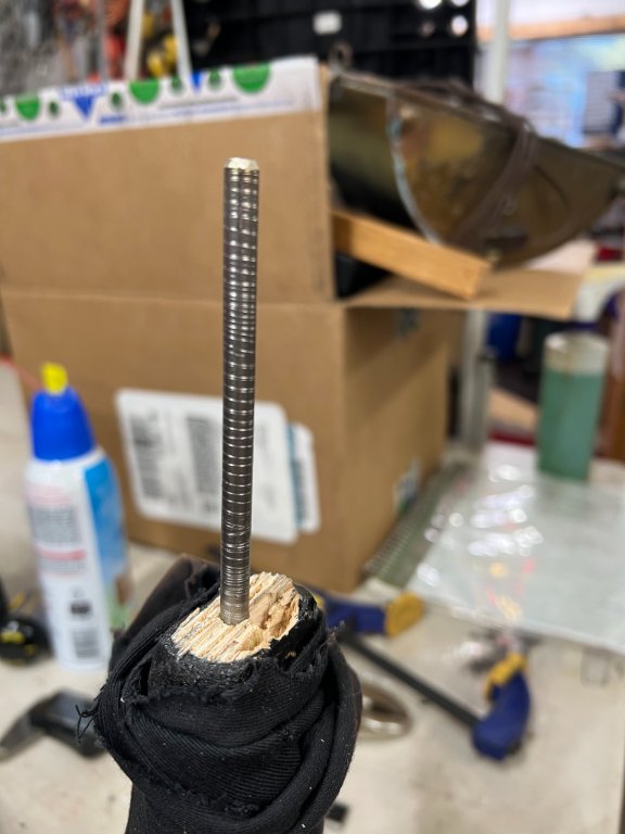

I made a fixture to match drill the bow and socket.
I drilled the bow to about 3" and the socket to about 4".
The rod was inserted into the bow and the socket.
JB Weld was used as an interface filler between the bow and socket.
I happen to have some large diameter thick wall heavy duty adhesive shrink tube.
Once shrunk, it is about 1/4" thick and very rigid.
The internal adhesive melts to form the the bow and socket.
This should help reduce the flexing between the bow and socket.

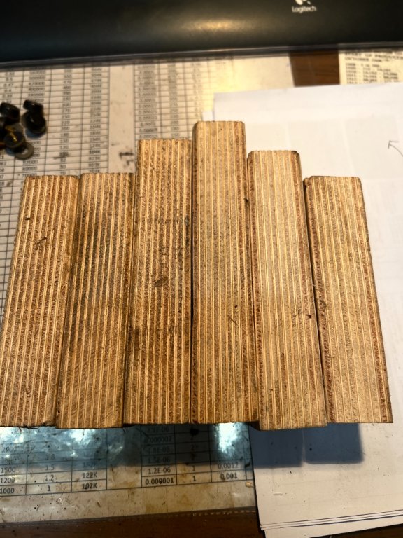

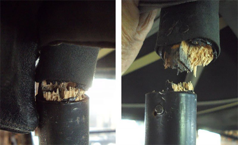

Never in my life have I seen cross-grain laminations in anything other than plywood. I would NEVER have expected a cross-grain lamination to last in this use, ever.
That design is a complete travesty.

I have laminated bows in my 1917 but they don't look anything like the ones pictured. They have held up very well.

Just to be clear, I believe Scott and Rich are saying that the fault in Bob's bow is that the grain of the laminations is running the wrong way.
Think of it like a laminated archery bow. The grain in a laminated archery bow always runs from TIP TO TIP, and in that orientation a bow (archery AND Model T top alike) are very strong. But having the grain run across the long axis is very weak.
- Posts: 7074
Re: Laminated Top Bows Broke Again.

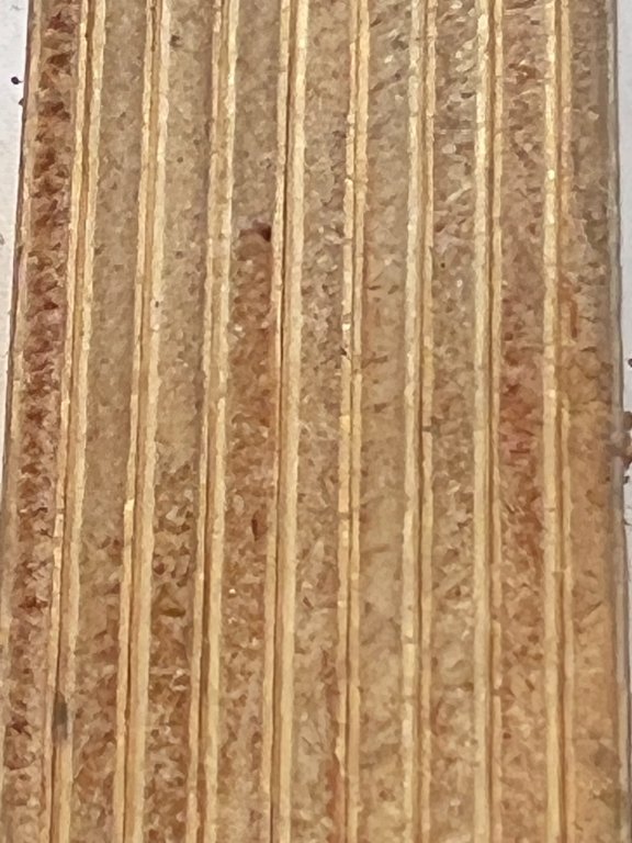

Scott has nailed it. The bows are laminated strips of plywood, so much of the grain is across the bow rather than along it. True laminated items are in fact stronger than steam bent solid timber, as today's adhesives used in their construction is of superior strength to the timber they are gluing together.
In such laminations, ALL the strips used have the grain running along the length of the timber.

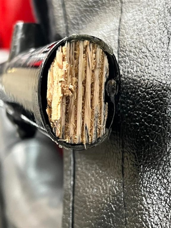

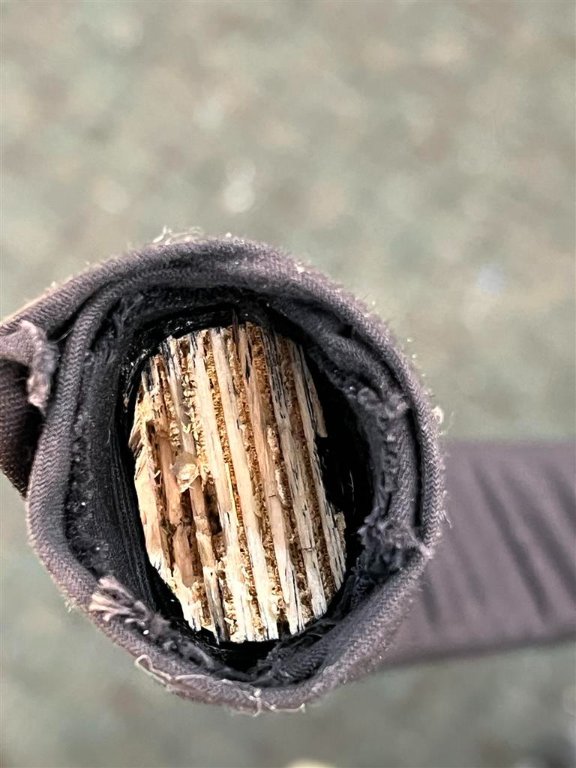

While cleaning up the shop I ran across the pieces of the top bows that I trimmed off.
As you can see they were "laminated" from nine layers of very thin plywood.
Respectfully Submitted,
