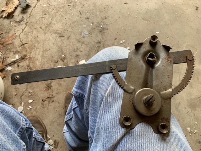

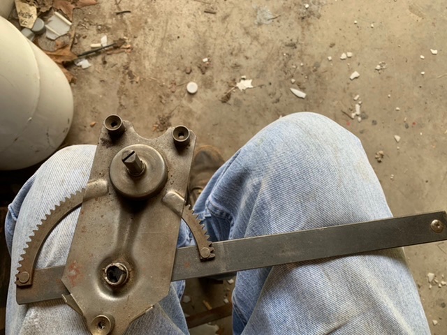

Post by Dan Hatch » Sun Oct 16, 2022 2:09 pm
This was on some A stuff I got. So I think it is A, but don’t they fit some T also?
Any info you can provide will be helpful. Thanks Dan

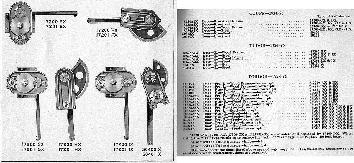

Post by Rich Eagle » Sun Oct 16, 2022 3:05 pm
This is what is in the Body parts book.

Post by Dan Hatch » Sun Oct 16, 2022 5:00 pm
Thanks, that looks like it. Dan
