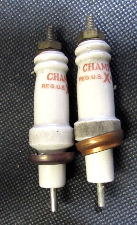

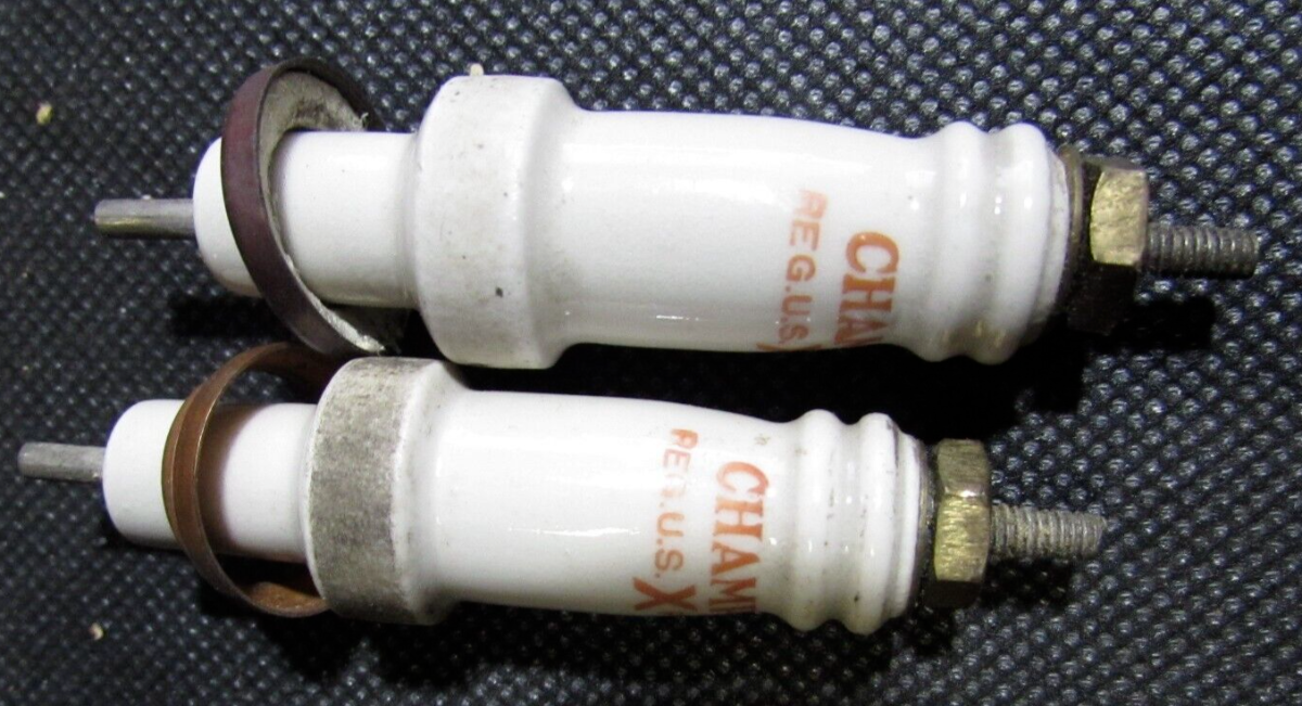

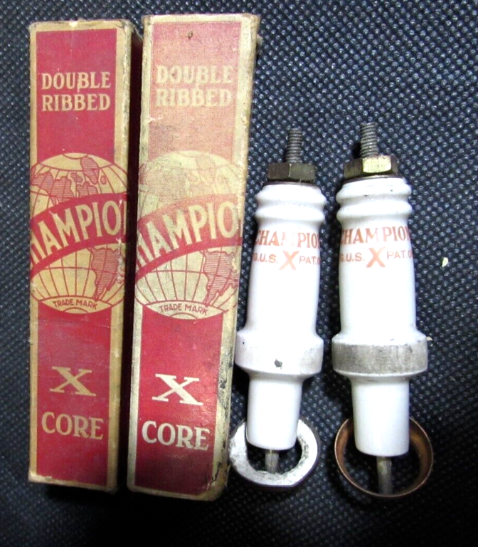

I know the discussion has gone on as long as there have been Model T cars. Here are two new old stock unused Champion X cores I just bought (at a discounted price from what they were asking) that have the ribbed top and the old style small nut ( I believe) which should be 5-40 threads. Common or not to have that combination ? Lot's of discussion in the past I believe , I ordered a 5-40 tap and I will re-tap 4-40 Brass Knurled nuts for these, as 5-40 seem to cost an arm and a leg if you can find them . Anyone else re-tap 4-40 Brass knurled nuts to 5-40 threads ? I see no reason why that will not work. The copper colored gasket is , I believe, the top gasket as these have two gaskets, unlike the newer type. I will be trying the copper crush gaskets with asbestos substitute from the aviation supply. The gaskets are 1/2 " I.D. X 3/4" O.D. . I will make a brass upper gasket from thin sheet brass using my gasket / washer punch set .

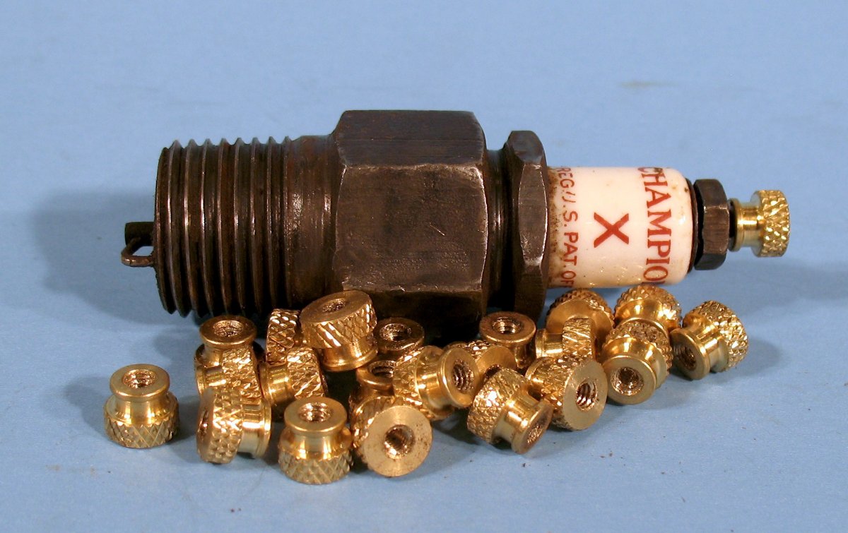

Yes, I have. They work fine.
4-40 tapped to 5-40
I believe those ribbed take-apart cores are from about 1921 or 1922. They're not exactly rare, but they're less plentiful than the brass hat plugs that were used during the years of peak model T production.
Last of the take-apart X's.

Thank you for that information Jeff......good stuff ! To your knowledge, has anyone tried to reproduce the center electrode ?

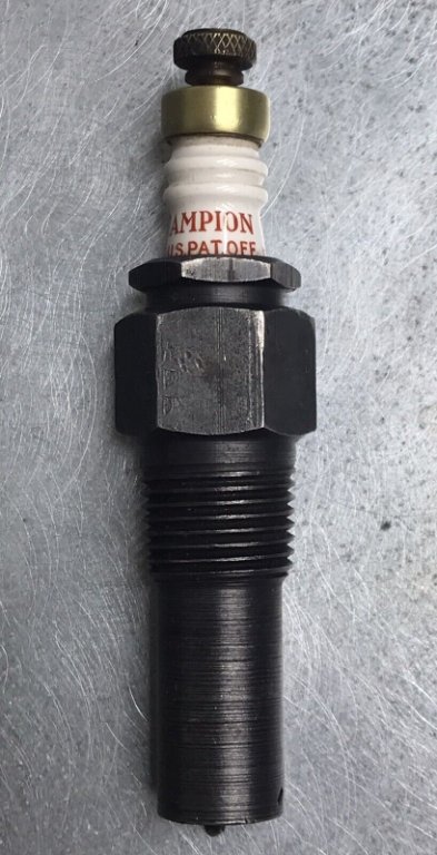

Not to change topics, but I thought I would put this here....a Champion #32 for a METZ , taken off of that auction site. I imagine this would put a very large hole somewhere when a Model T piston would hit it , if you were to try it (NOTE: Bad idea I think )

...has anyone tried to reproduce the center electrode ?
I doubt it. I think that's a DIY project.
