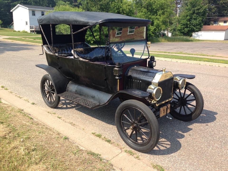

What is stopping you from getting them (splash shields). I checked the 1913 and 1914 Model T photos in the MTFCA Gallery and online images and they all had splash shields. Jim Patrick
Gallery photo of the 1914 Touring is attributed to gjscholz.
