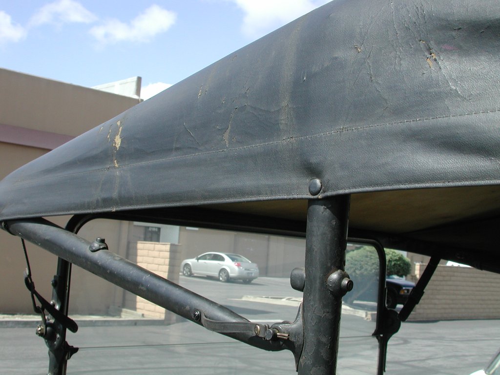

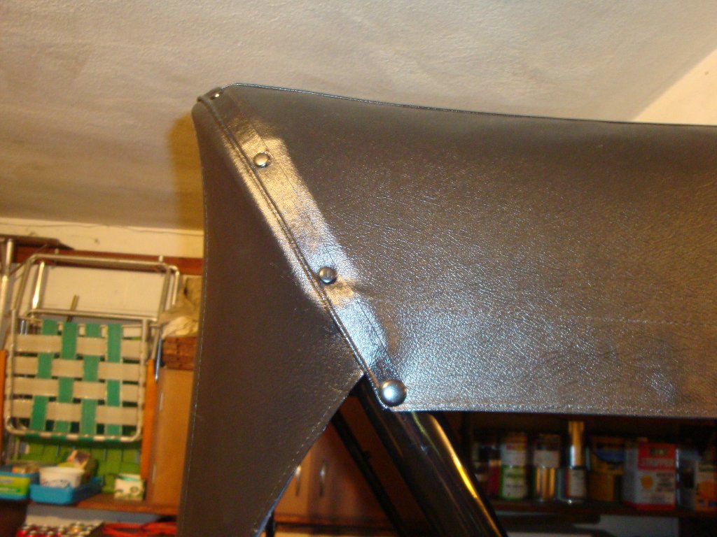

Regarding the large upholstery nails, I presume you are referring to the two large nails that are on each of the bows. For a touring, is a total of eight large upholstery nails. For a roadster, that is a total of six larrge upholstery nails. (Unforunately, my roadster doesn't have it's original top so I don't have an example of an original, large upholstery nail.)
I recently installed a new top on my dad's 1917 touring. We did it from scratch, not a kit, and used Turf material. My father also made up the binding for the first and last bow (he purchased the bias tape from Classtique but installed the piping and folded and glued it himself).

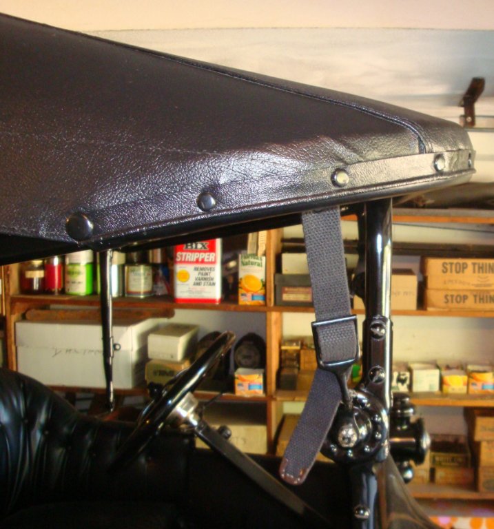

The first and second photos below are of the 1917 Rip Van Winkle touring and show examples of the large nails - one per side per bow.
The third photo is of the fourth bow on my dad' 1917 touring also showing the large nail that we used at the end of the binding (my dad obtained large upholstery nails from Wittmer years ago). The fourth photo is of the front/first bow also showing the large nail
(Worth noting: the spacing of the upholstery nails on the top is based on photos of the Rip Van Winkle touring as well as the factory photos of the 1917 "mock-up" touring. Ford was pretty economical regarding the amount of upholstery nails used on the top binding. Today, there's a tendency to install too many.)
We also recently purchase large black upholstery nails from the local Hobby Lobby that were larger than the Wittmer large nails thinking the diameter would be more correct; however, they seem too big and they have a much higher and rounded dome and don't look quite correct.

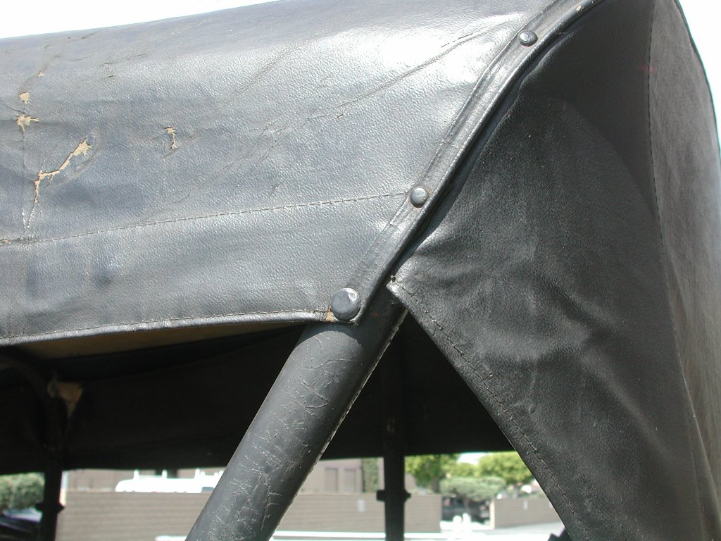

The large upholstery nails on my 1913 runabout are a "generous" 9/16" measuring almost .600" (9/16 = .5625"). Maybe spread a little from being hammered in ?
I can't say they are original. This car was restored to a reasonably high standard about twenty years ago. I had to replace the top last summer, so I salvaged the big nails, but they didn't all survive. Only so many times the nail can be straightened before the head pops off. These appear to be nickeled, then painted black. Top just looks "wrong" with 3/8" welt nails in those locations.

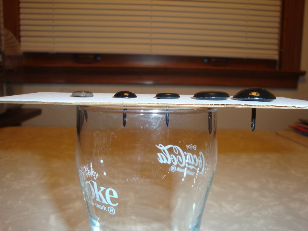

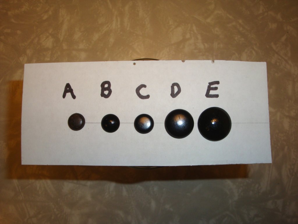

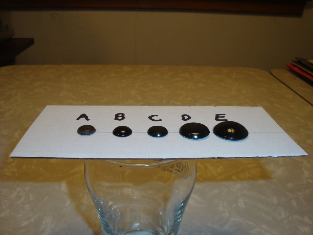

Here are photos of an original upholstery nail as well as what is currently available.
SEAT, DOOR PANEL and TOP BINDING/TRIM UPHOLSTERY NAILS:
A = original nail from my unrestored 1917 roadster used on seat and door panel binding
Diameter = 3/8"
Head profile = flat
Pros = it's 100% correct for my car
Cons = identical nails are not currently available unless you can find an NOS supply
B = nail purchased locally
Diameter = 13/32"
Head profile = dome
Pros = closest diameter to original example "A" - only 1/32" larger
Cons = head profile not correct compared to original example "A"
C = nail purchased locally
Diameter = 7/16"
Head profile = flat
Pros = correct head profile
Cons = diameter is 1/16" larger than original example "A"
NOTE: this is the upholstery nail that we used on my father's 1917 touring - refer to the above photos
TOP BINDING UPHOLSTERY NAILS (used at each end of the binding - one per top socket - refer to previously posted photos)
D = nail purchased from Witmer Coach Shop
Diameter = 5/8"
Head profile = flat
Pros = head profile is correct, I believe that the diameter is a good match to original (refer to photos of 1917 Rip Van Winkle touring)
NOTE: we used this nail on the new top of my dad's 1917 touring (refer to photos in my first post)
E = nail purchased locally from Hobby Lobby
Diameter = 3/4"
Head profile = dome
Pros = none
Cons = profile is incorrect and, I believe, diameter is too large/incorrect, at least compared to photo of the 1917 Rip Van Winkle touring previously posted

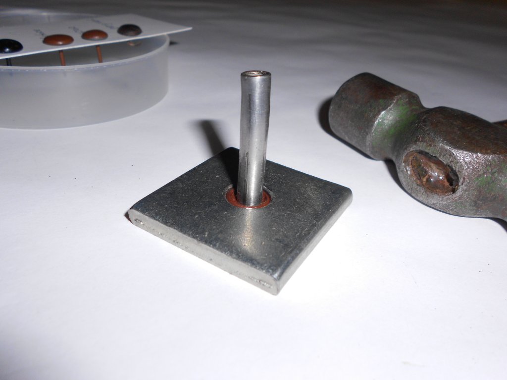

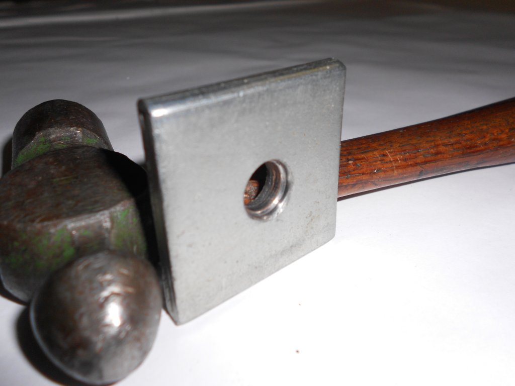

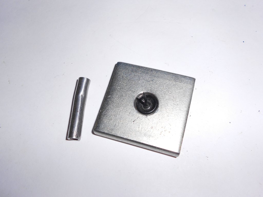

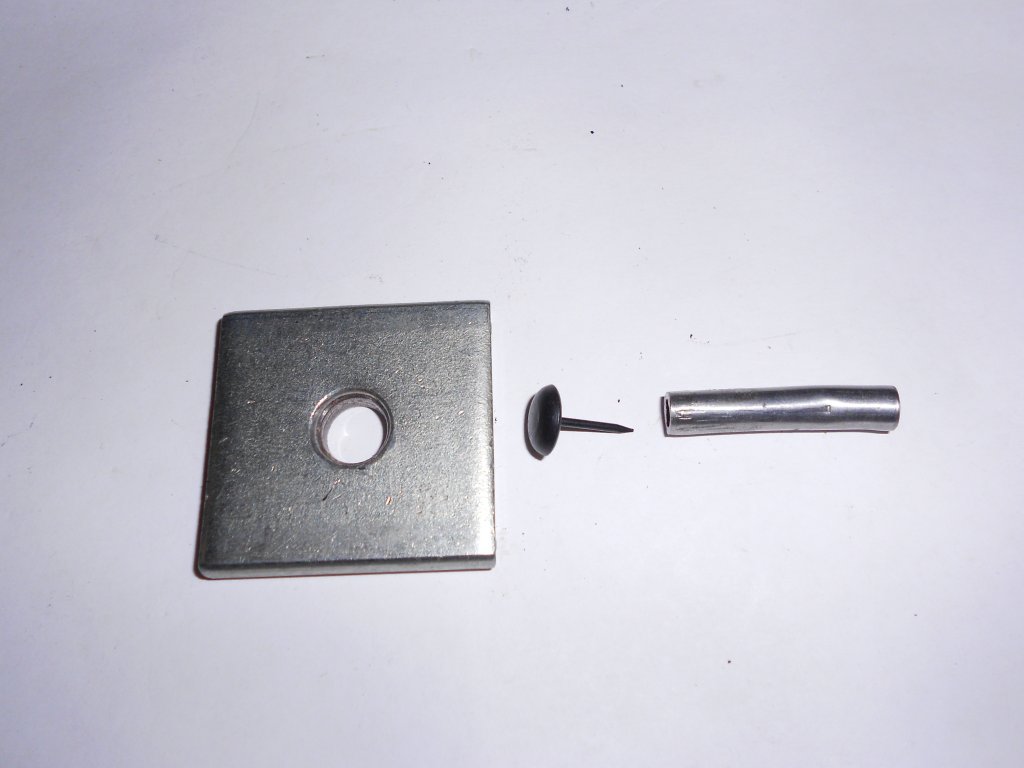

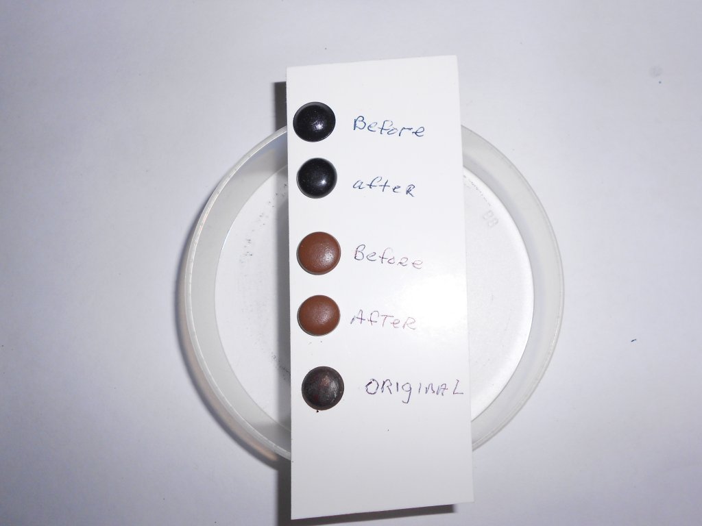

This is what I do in regards to the 3/8 upholstery nails. I made a little resizing block and pound the oversize nails thru.An extra tap when the nail hits bottom flattens the head. Les
