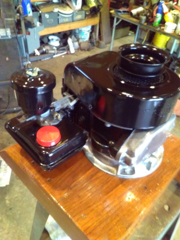

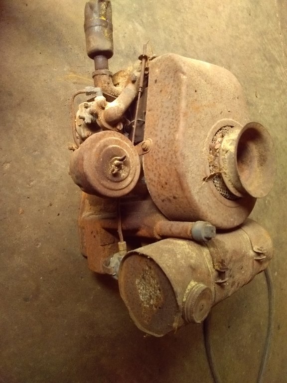

I decided not to high jack the hit and miss engine thread and start this 1 to share some odd balls I am working on.

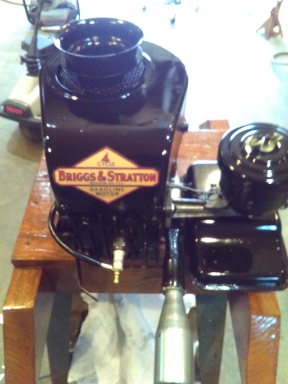

This is a Briggs and Stratton 6HSF engine with 2 inch bore. Best I can find out, febuary of 1952.
I have a couple engine of similar models a tad older.
I decided to refurbish some of what I have always considered and called vertical shaft engines. Turns out Briggs refereed to these as horizontal engines.They referenced the cylinder position instead of crankshaft position.

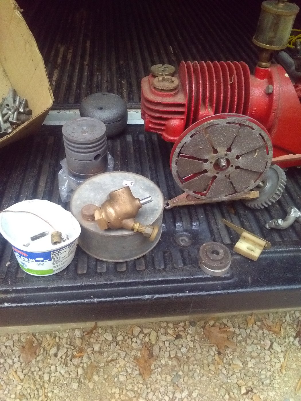

This engine was a bit pricey to fix and the exhaust manifold is a "copy" as the originals are impossible to find.
Parts for repair, I found a fellow in Virginia that sells NOS and good used Briggs parts ,if you ever need any let me know and I will pm you his number.
He had the new connecting rod and so forth I needed for this 1.

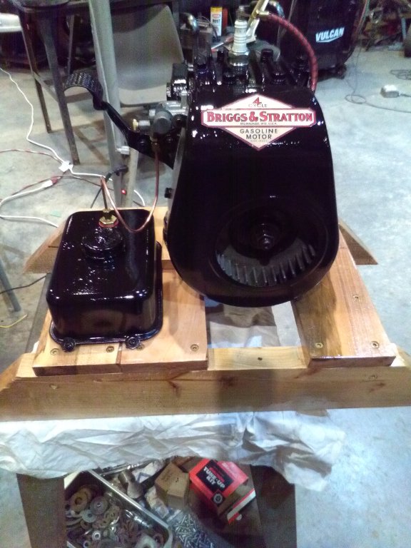

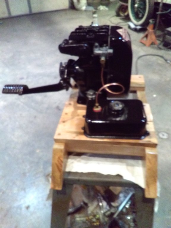

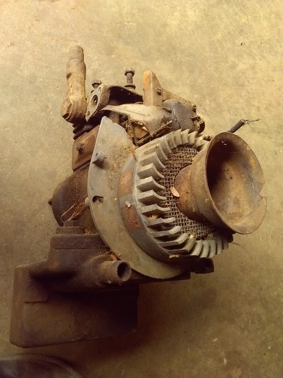

These are a couple others on the table now.
The unrestored 1's look a bit rough don't they?
Third 1 is a 6HS
second 1 is a 6H
Both have the same bore,but the S indicated suction feed carb.
These are in mid restoration right now.
first engine is a WMB Briggs and stratton engine.These were used on washing machines.
Third 1 is a 6HS
second 1 is a 6H

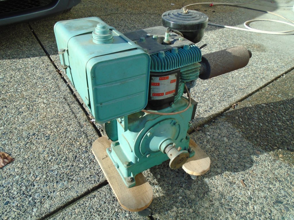

This is my 1949 Model 23 12 HP B S. I haven't started it for about 10 years and it went on the first pull. It was originally in a 12 foot Clinker boat, the boat got wrecked but I salvaged the engine.

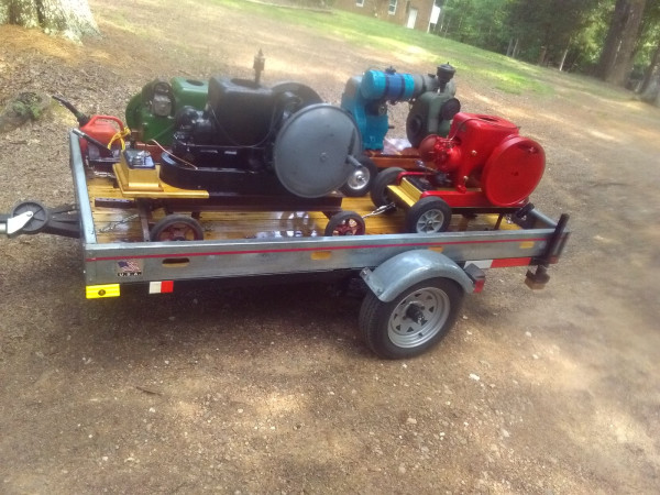

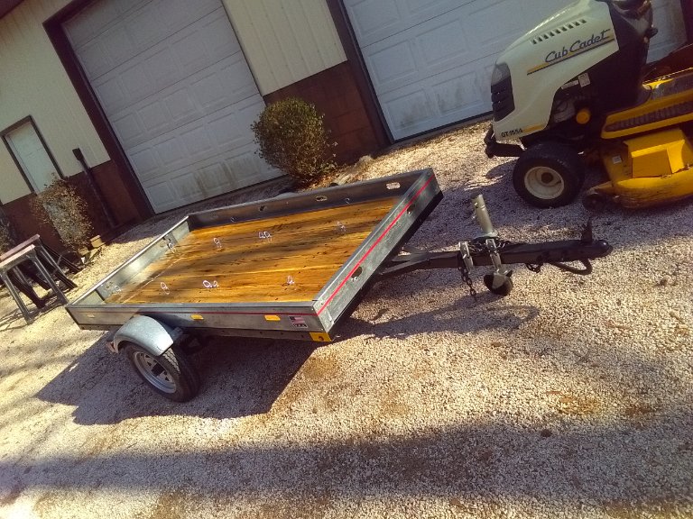

Most of the engines I restore,don't even get gas put in them,I will pop them off on a bit of carb spray or something to make sure all is well. To much trouble cleaning old fuel out of tanks and such.

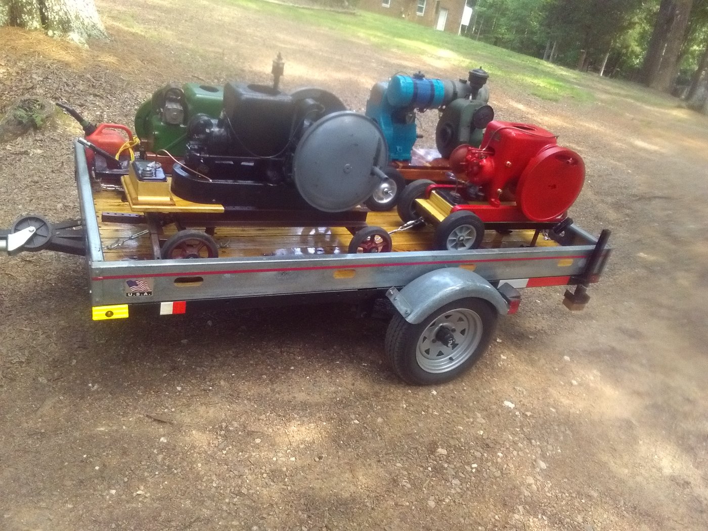

I built this trailer over the last month or 2 to strap down my water hopper engines onto and take them to day shows without alot of handling.I have devoloped 1 of those hernias in my belly just under the right ribs, and it seems lifting makes it hurt worse,So i am trying to cut back on that.

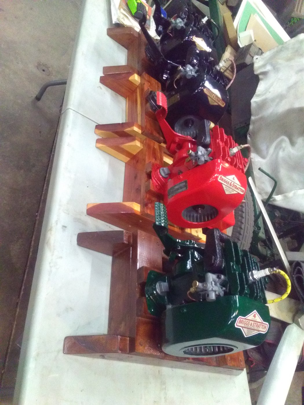

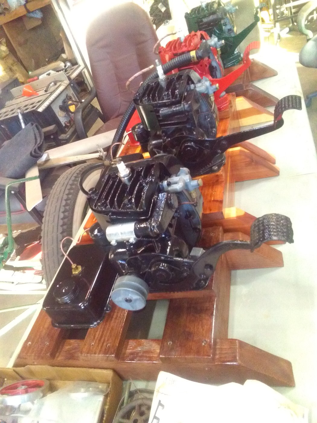

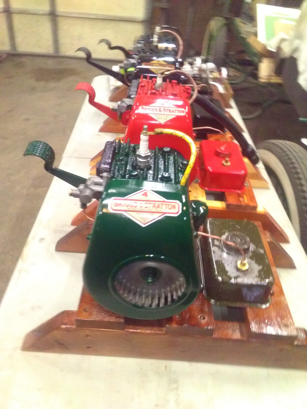

Here are 4 of my current finished engines I have redone over the past month or so,
2 more are on the bench now about 1/3 done. I have a total of 8 of the kick start WMB model Briggs engines now.
the red 1, is a engine sold by Sears,thus it is red. the green engine, well, let's just say I was getting sick of BLACK and decided to paint 1 a different color, later learned that yes there was a vendor that sold them under a machine and green was correct.

I noticed I didn't update the thread after I mounted the hit and miss engines to it. So here it is, the grey and black 1 is a 1926 Fairbanks morse 1 1/2 hp "dishpan".The red 1 is a IH 1 1/2 hp throttle governor engine that was given to me in 2022 at Luray,not quite running yet,
the green 1 is a fairbanks morse 2 hp ZD engine.
the small green 1 is a Lauson sold under the fairbanks morse name, the other 1 is a Wisconsin that Hal Davis gave me years ago.

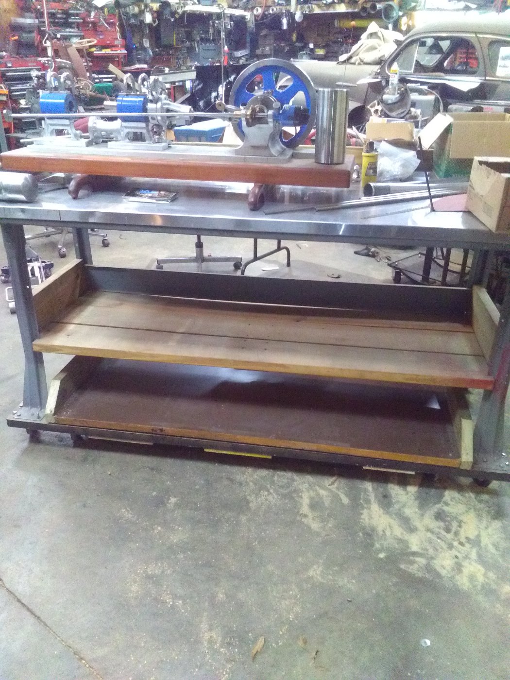

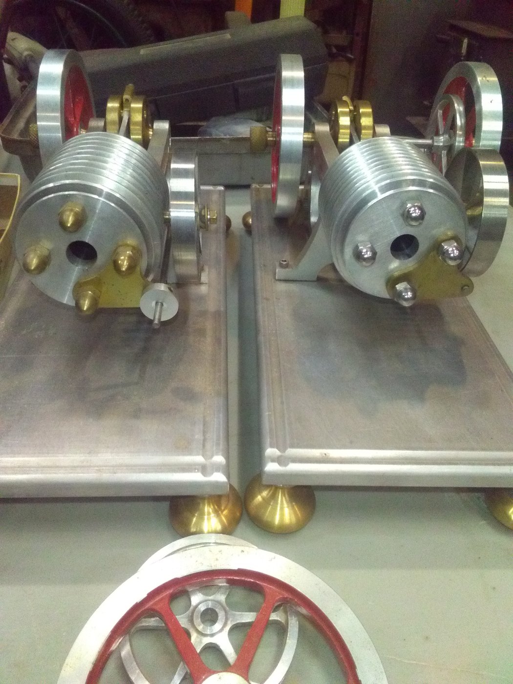

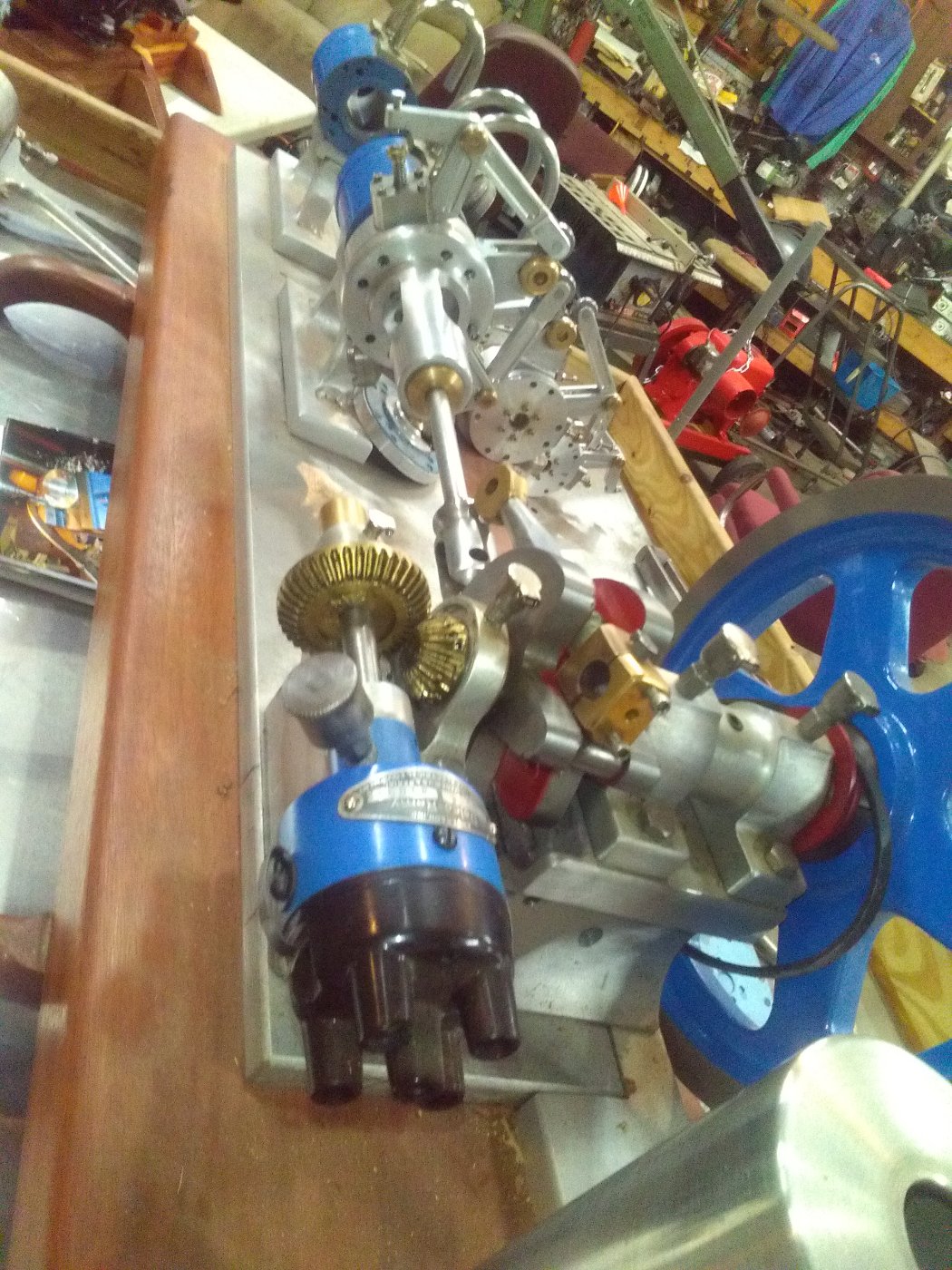

Now here is some stuff,I will be needing to learn about, and i am hoping to get some of my friends that are machinist to help me on them.A freind of mine , Bill Meanus, is very bad sick with cancer, He has been a great friend for years and he has given me some engines here that i HOPE I can get some of them working.
He was in the MTFCA in the 70's and built his T while living in Oregon. He sold it when he came home and did a A which he still has.
He cast his own metal,self taught machinist.
just a talent beyond me for sure.
Here is are a couple hot air engines ,the plans are on ebay for what is called a 4 in 1 engine,as in 4 styles, flame licker is another name for the,, and the big boy, a 4 cylinder Snow model, built 30% larger than the plans.
That is a 6 foot table it is sitting on. quite a bit needs to be done to finish it, but the little flame lickers just need the graphite valves and such done, the other engine that is apart, is a 1/2 hp Ideal, I think I will be able to make it go with some work, most of it's there.
