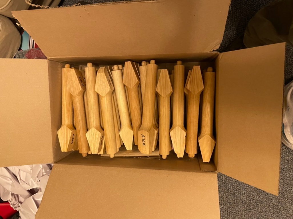

My box of spokes came from Snyder’s the day before Thanksgiving and they look great. Nice straight grain on all the ones I have seen so far. They are for my Kelsey felloes and rims. Once the hub puller I bought from the classifieds arrives. I will pull the wheels and start to work. I do notice that they have been treated with something, not sure what it is. I assume it’s a preservative of some sort that will take finish. It has raised the grain a bit so a light sand before assembly is in order. I’ll give Snyder’s a call to check what it is next week. I am going to varnish them as I like the look better than black. This is one of the last things on my punch list for this car. I do need to clean up the correct Kelsey rims I picked up to match, but I have all the parts on hand.

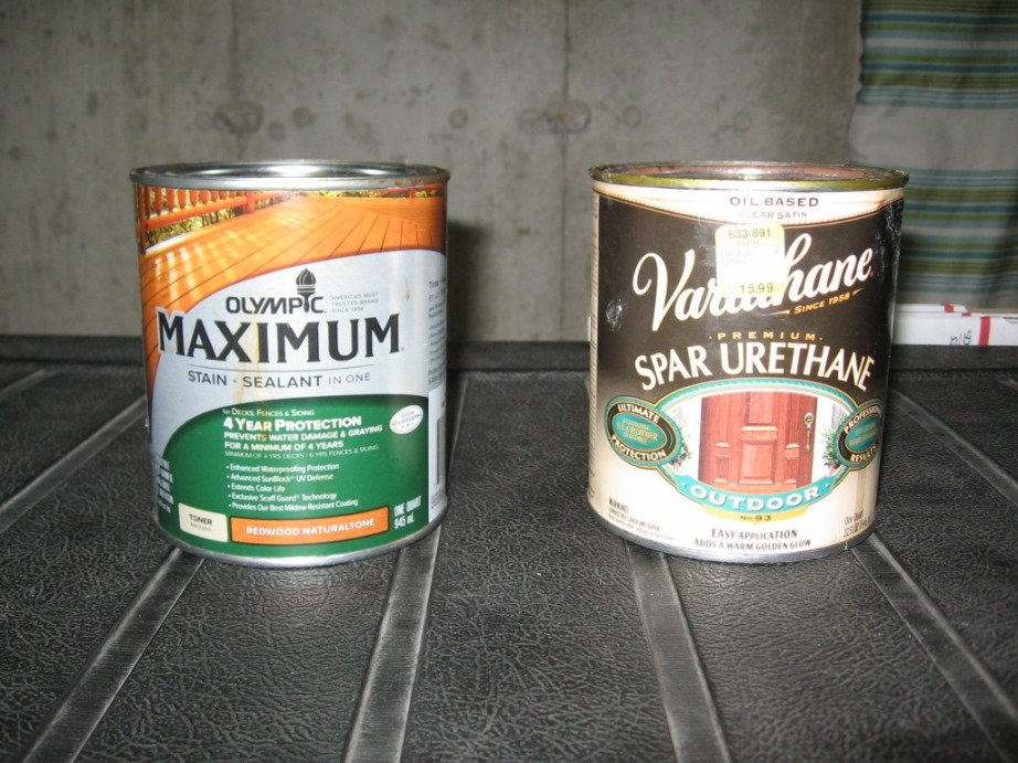

Here is the plan for the wheel press and a picture of the sealer and urethane finish I used on my spokes:

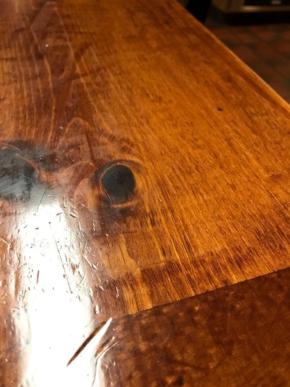

I can't find the pictures of the wood spoke wheels I restored with the Minwax Hardener & Helsman (sold the wheels) but here is a picture of my kitchen table (Pine wood unstained) - its just several coats of Helsman Urathane that I did 10 to 15 years ago. Its my end of the table used daily.
